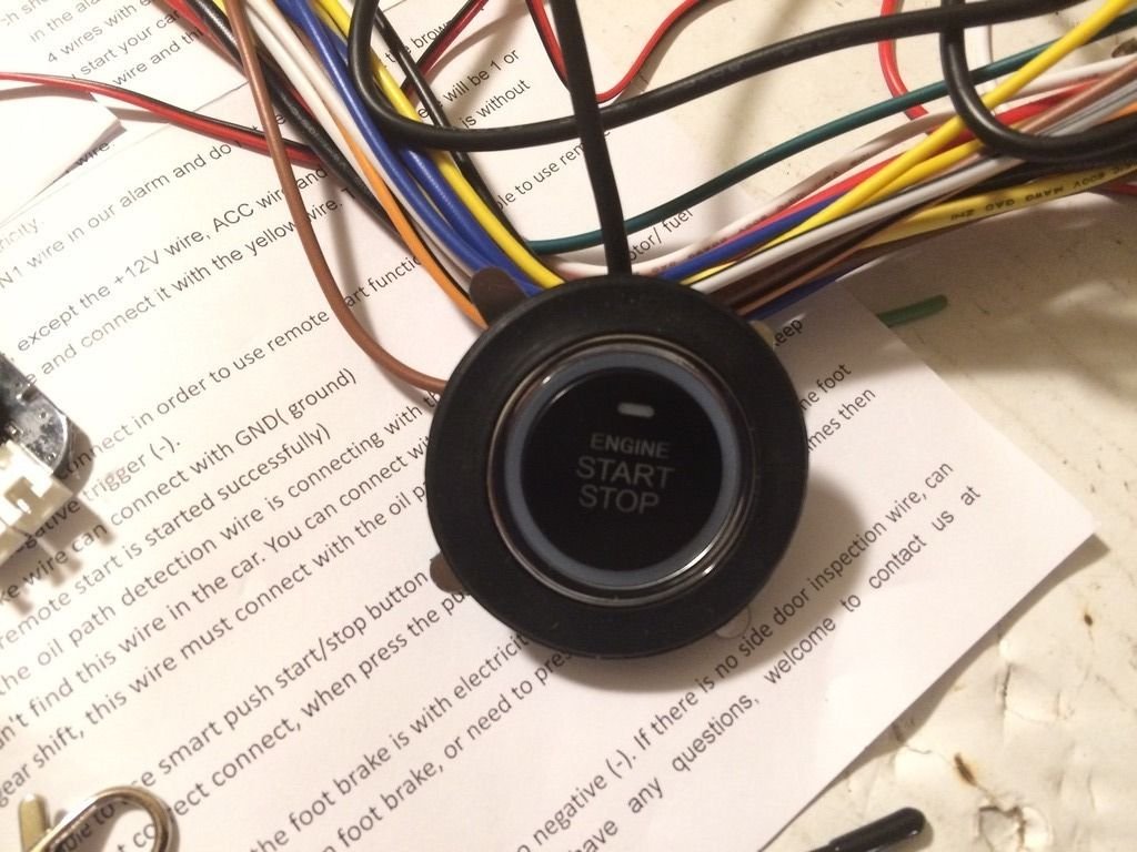

Hey guys, wonder if you guys can help me locate the ignition wires under my steering column (starter, accessory, constant)
& what color the wires are?
I’ve installed a push button start & I’m having difficulty locating these three wires.

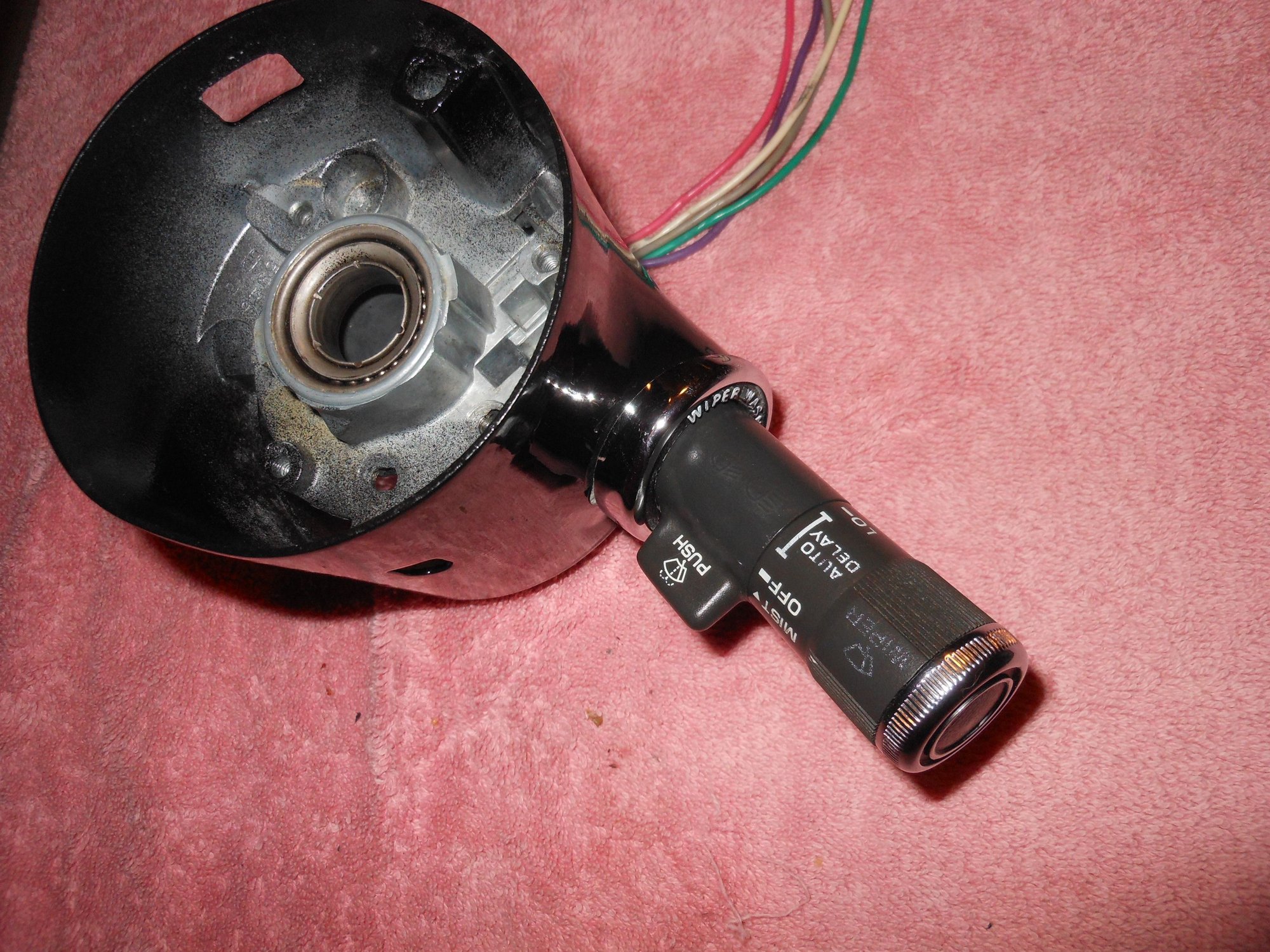

Look at the top of the column- see arrow.
That's your ignition switch- I've mapped it out for earlier C3- think 80 is different though.
Here's a 1980 wiring diagram-

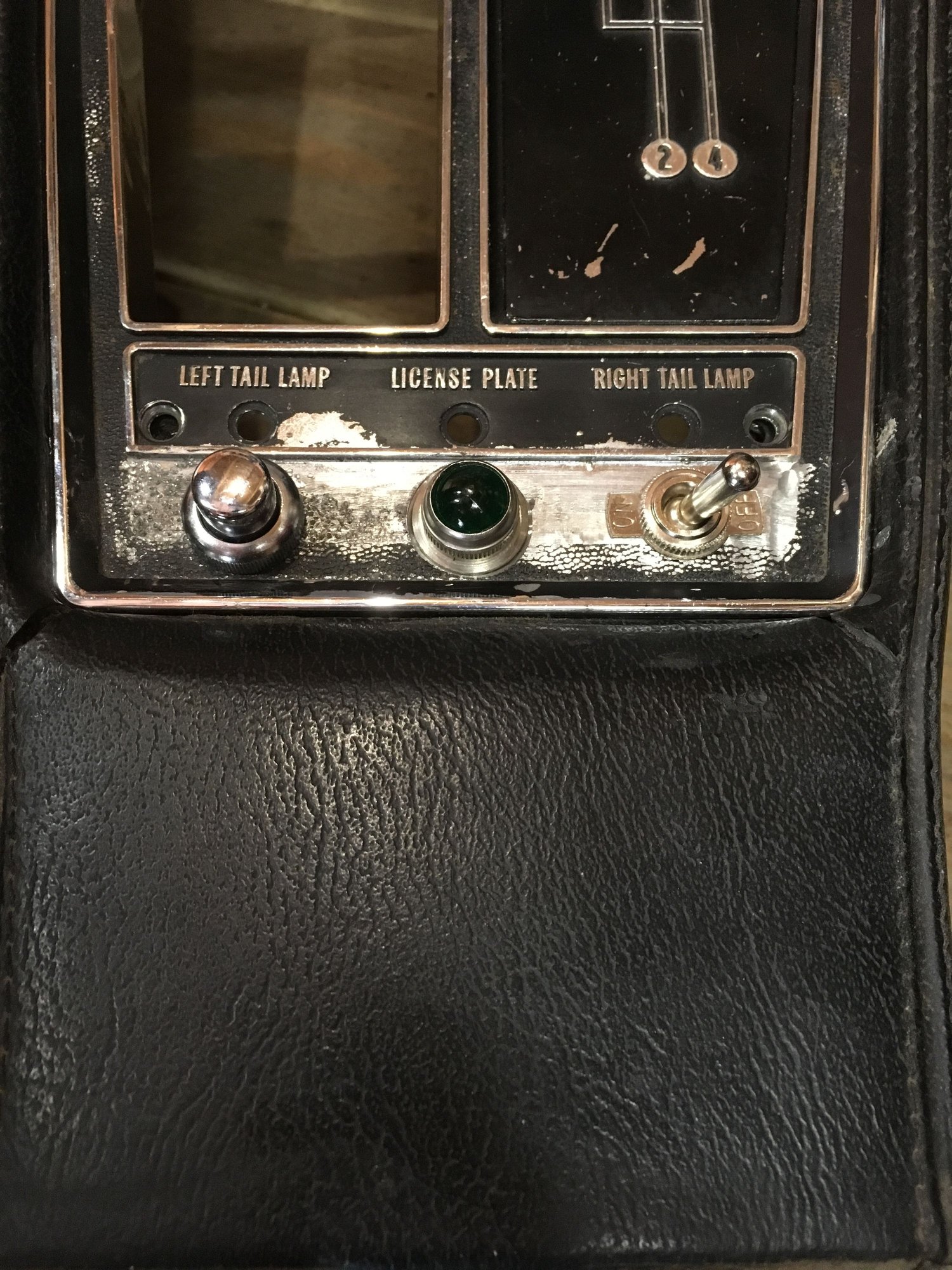

This thread is recent enough that I'm going to piggyback off it. How would I go about hooking up a push button setup like this?
Old Aug 1, 2017 | 06:22 PM
TimAT's Avatar
TimAT
Joined: Oct 2006
Posts: 7,123
Likes: 433
From: Gladstone MO
You have it easy. Taped to the harness at the front of the console is a pair of 10ga purple wires- one with a white stripe. Feed 12v to one side of your switch and the other side of the switch to the purple/white stripe wire. Presto, instant start button. Note that this will crank the engine only and NOT provide power to the ignition. And this will also bypass your clutch safety switch.

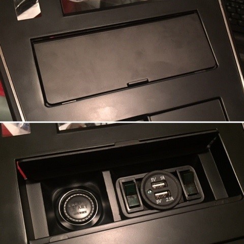

It can be...but you have to either remove or have a manual/custom steering column release- and then there is reverse lock out.
I'm using a keyless/remote system with transponders. I have to have the key fob to start the car.
And they are programmable- can walk away with the key fob and it'll lock the car.
I still have the clutch safety switch-have an electric power steering motor on the column so I just removed the steering column lock. Since I went w/ a 5 speed- just bypassed the reverse lock out. And then filled the ignition switch w/ a windshield wiper switch.
These are around $150-
