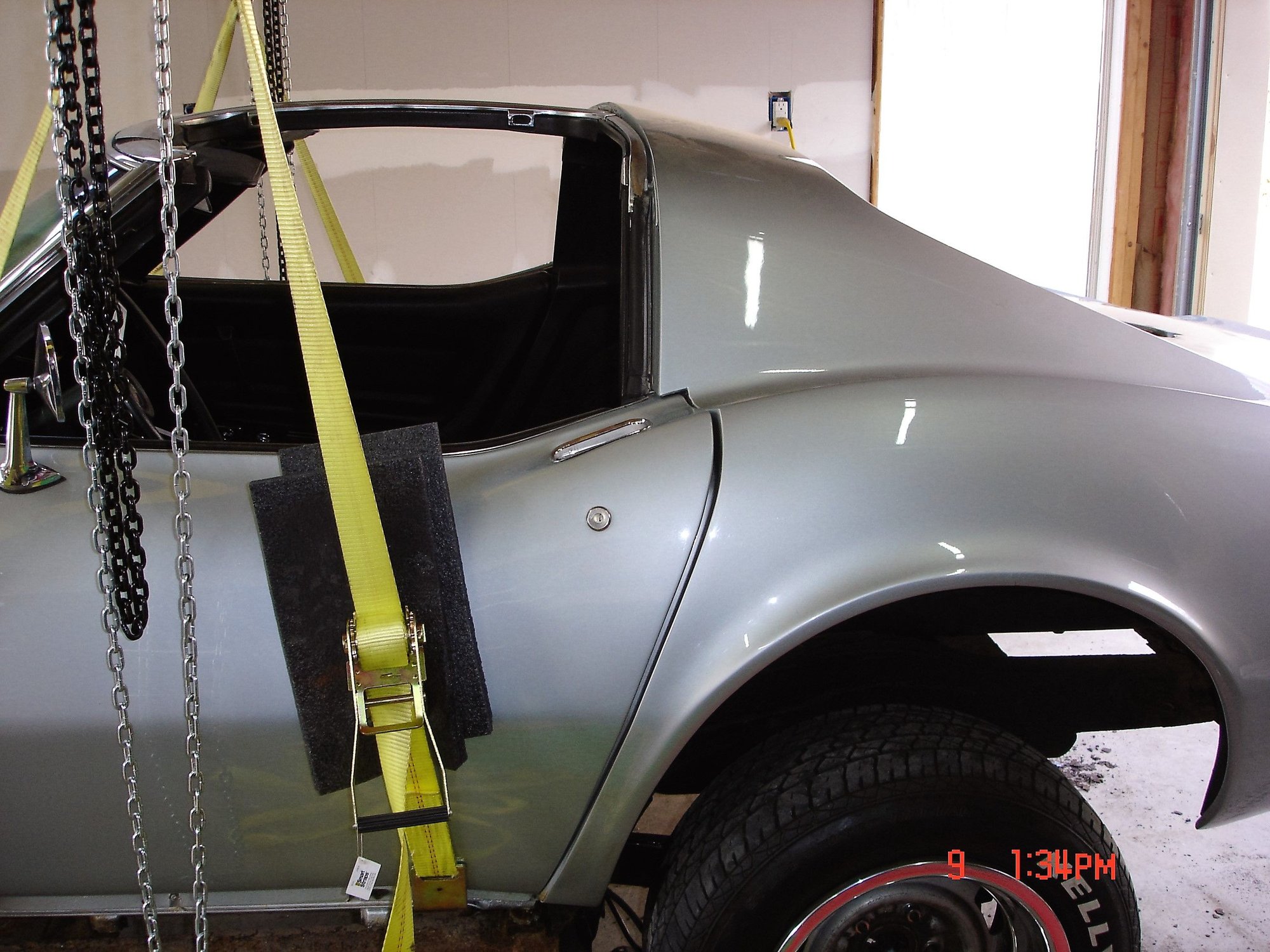

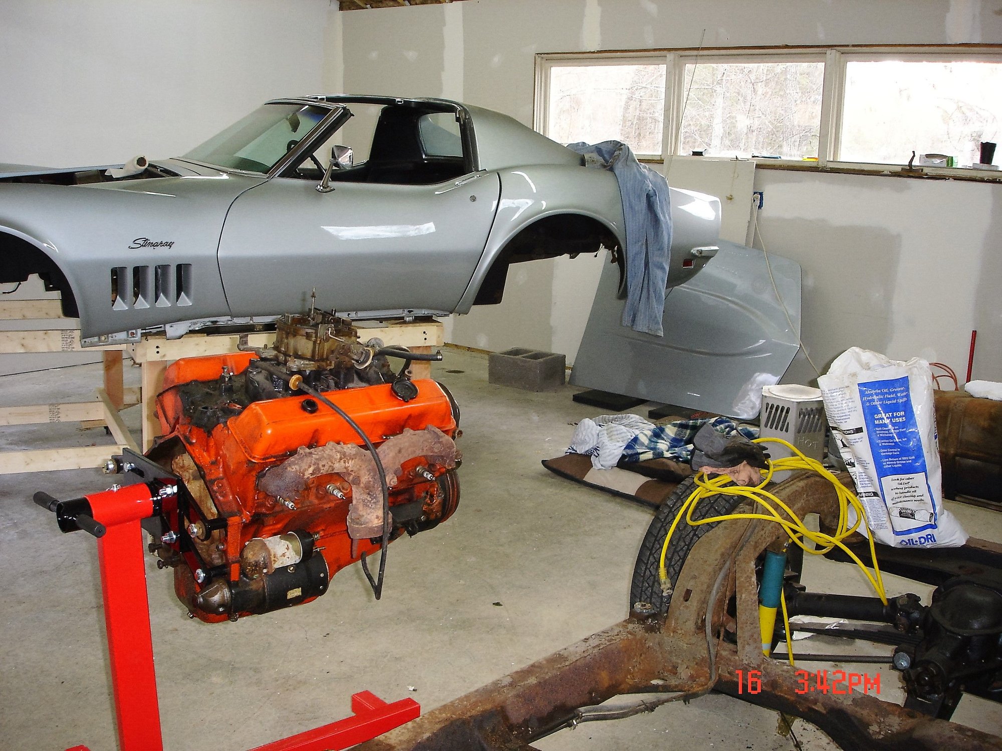

Good question Buccaneer. The car was in my new detached garage. When it was built I had them run 3 16" wide cross beam headers knowing this would be good foe body lifts and engine lifts. Then I went to northern hardware and picked up 2 1ton pulley systems. Attached them to the header and away it went. I tried to strap the car close to factory so it would lift evenly.
RVZIO
So those are a few pictures taken at different time in my project that show how I lifted the body based on what was available.
Thanks for asking and good luck if you decide to do this.
RVZIO
Gottcha and thanks for the pics. I want to change out my body mounts which is the only thing left to do really on mine. Trying to figure out which is the best way with the least amount of trouble. Read a lot of posts from others, but not too keen on some of the ways to accomplish the task. I'm in no hurry and may be a winter project since the heat here in AZ is starting to go up. Thanks again.
