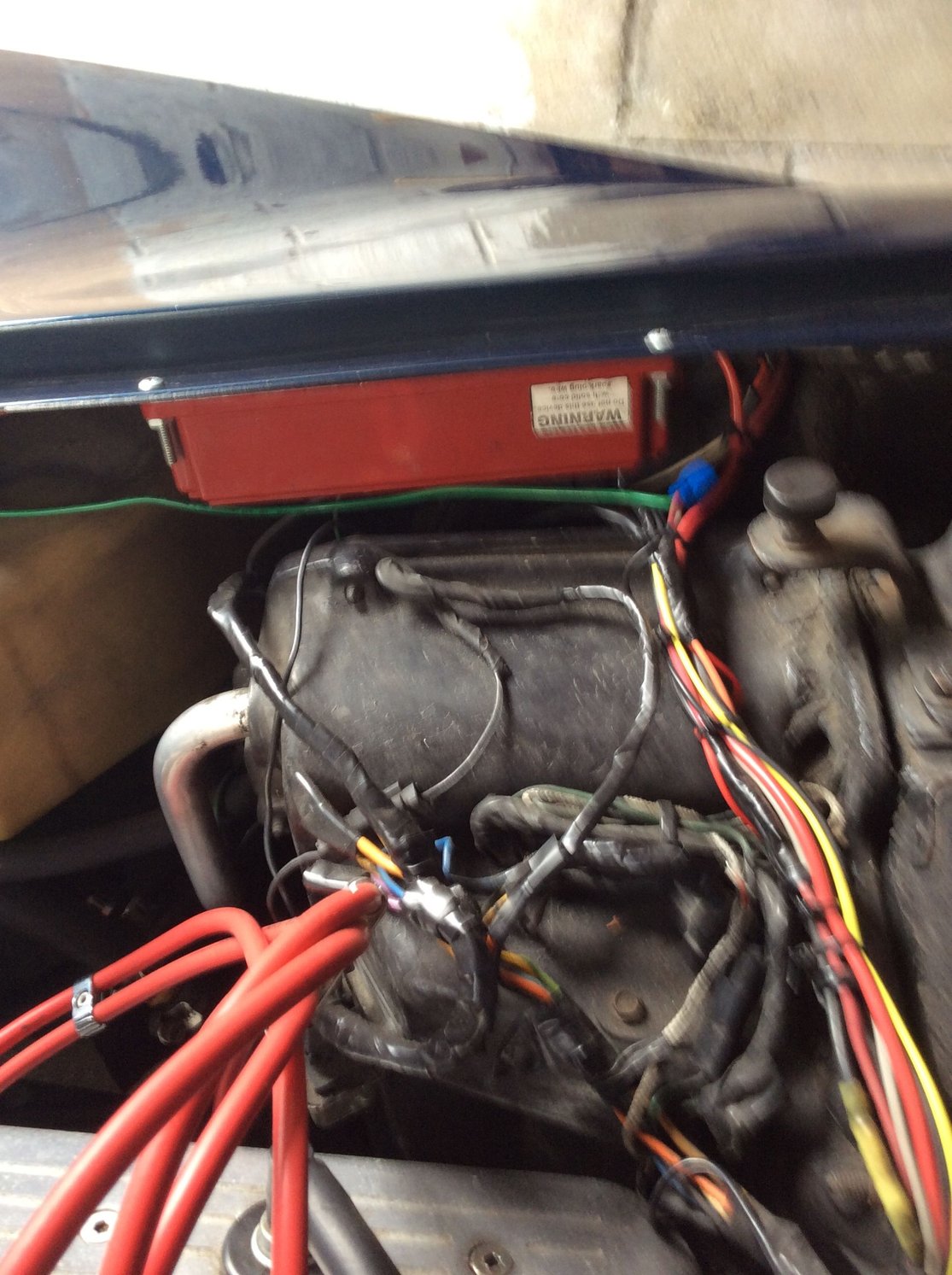

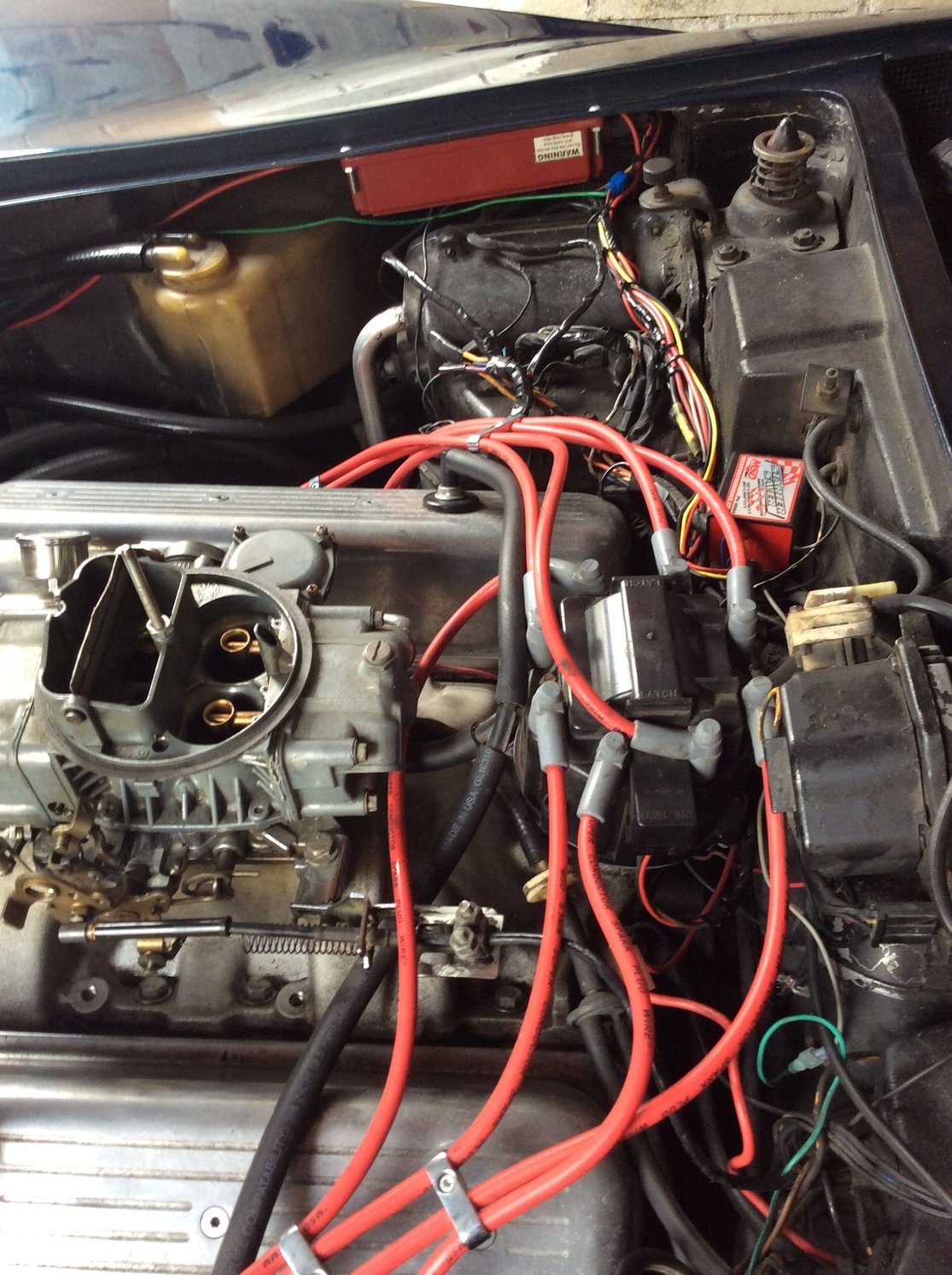

1973 with MSD 6AL. What dizzy and what coil?
IF its that red MSD POS coil, I would suspect that next. I have changed so many of those due to leaks and failures.
Some 6AL boxes get failure prone when hot. Hard to chase.
I have a MSD box tester.
Picture of the set up would help.

Ill get out in the garage over the next day or two and post up some photos....According to the specs on the engine ( it's not the original one) it's a summit HEI distributor with hot coil and fast advance curve...
Not exactly sure what that set up is..Have an idea, just not positive.....73 of course was points and not HEI.....
My 6AL is mounted on passenger side of engine above the wheel well.....Its right under the side of the hood....

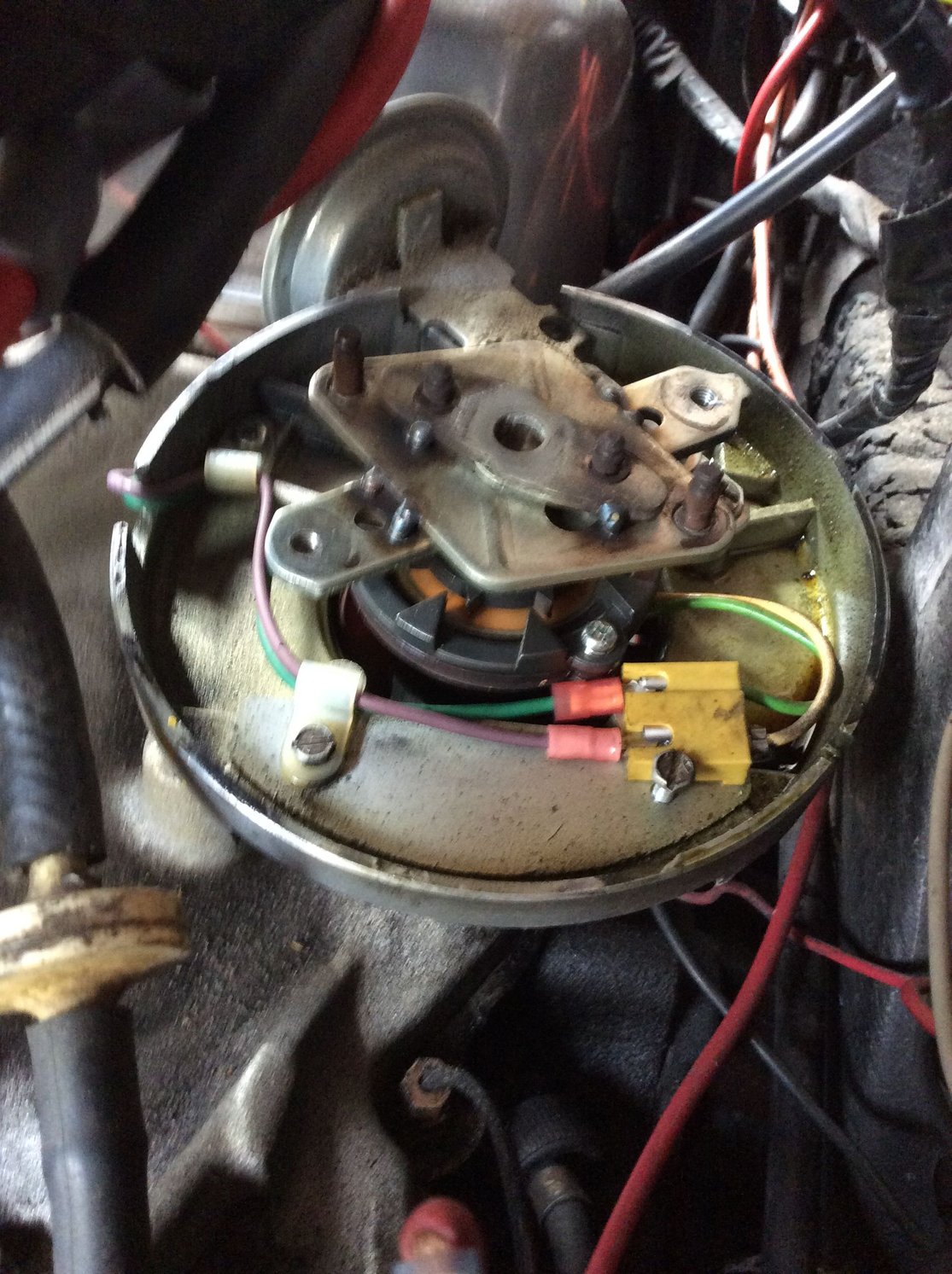

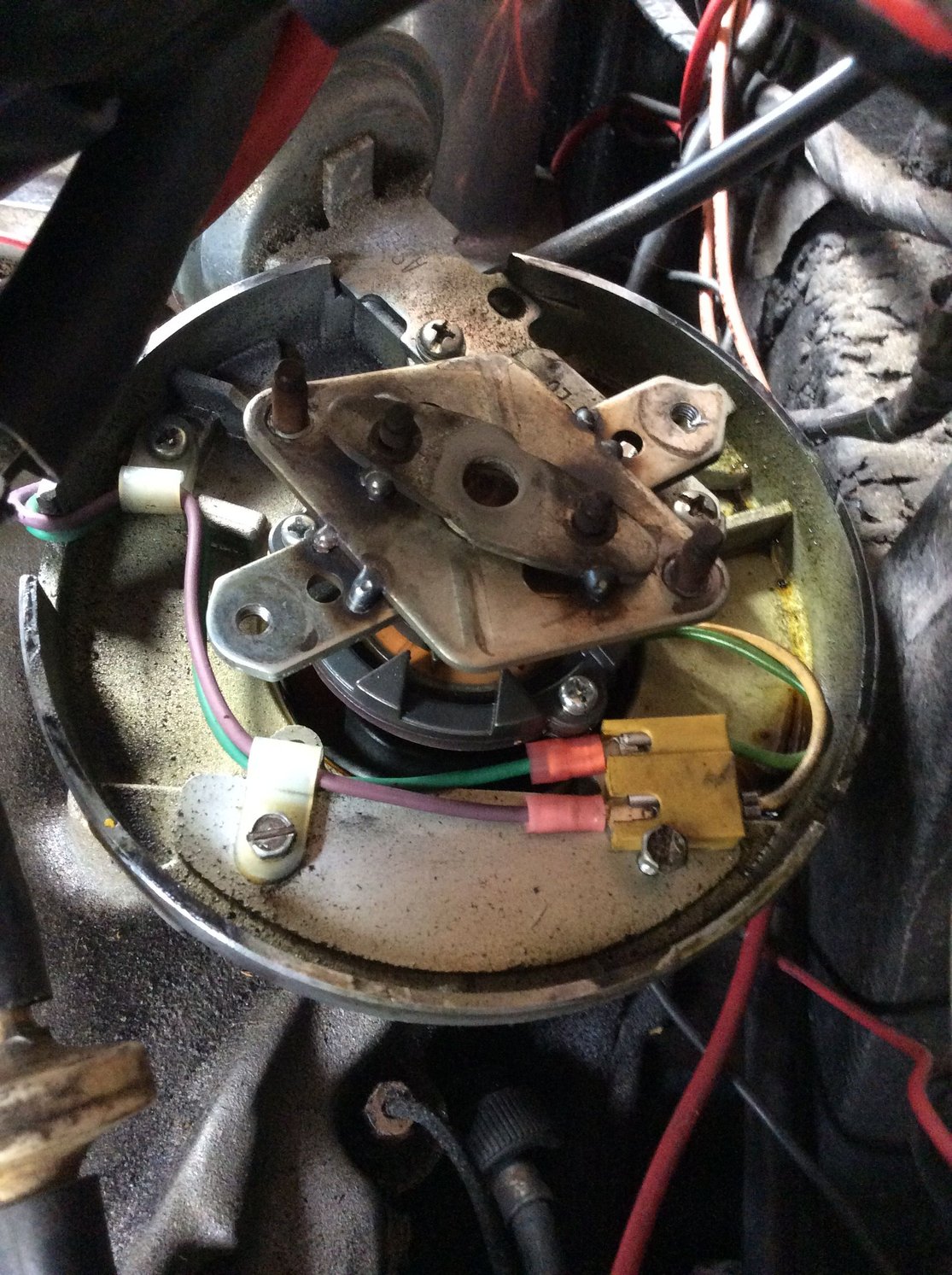

I know where I would go next, but lets verify what you have. If possible, a picture inside the dizzy of the module please.
We are now assuming fuel supply is okay. Keep in mind when those filter socks go, debris can get in the pump check valves and filter, still causing the same symptoms.

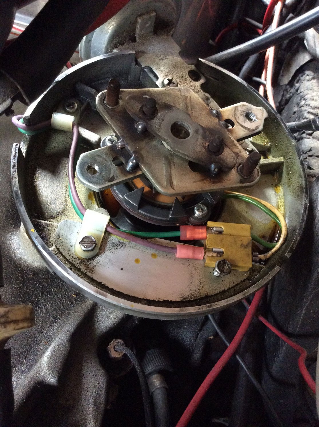

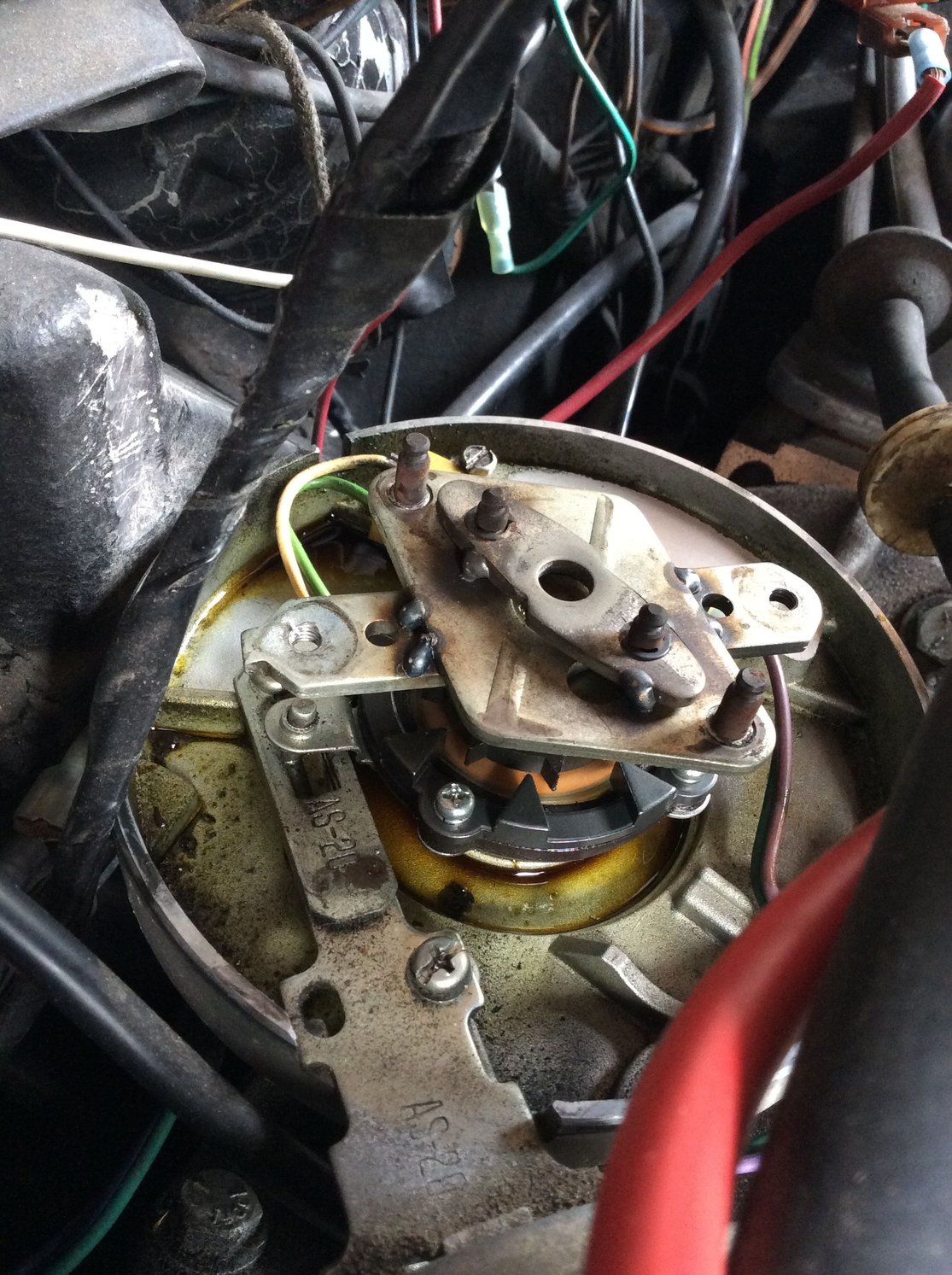

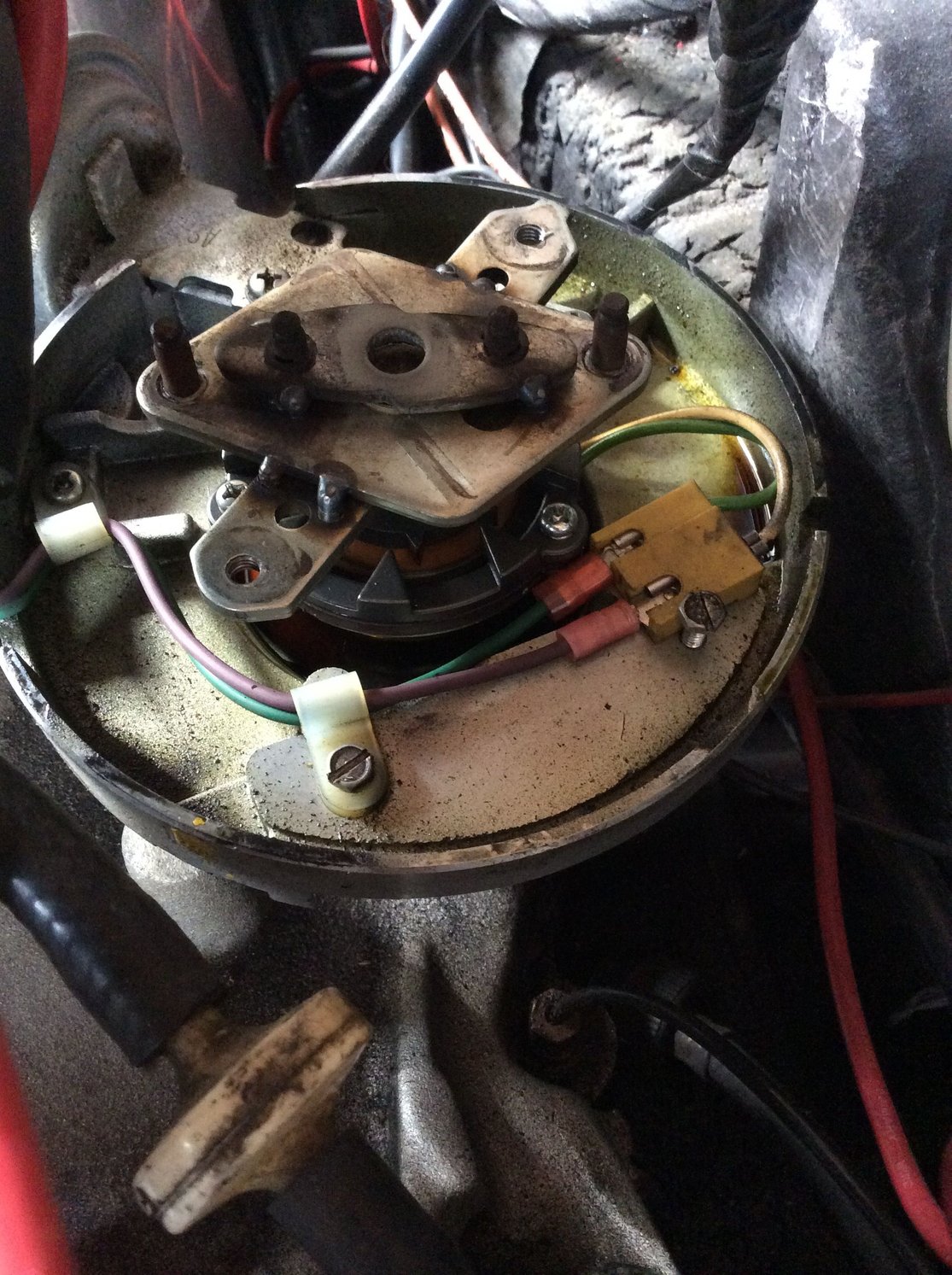

Removed the cap and rotor.....Took some photos best I can.....There is oil inside near the neck of the distributor....I'm sure that's not common...If you look at the photos it's that dark ring around the beginning of the neck...Its more prevalent on the drivers side...
That dark ring below those two wires is oilhttps://www.corvetteforum.com/forums/post_thanks.php?do=post_thanks_add&p=159 4152393&securitytoken=1488133524-6fa2080017026c79219cef11f2b79f41e3d0676c

Can't read the pic well enough to get the part number but that coil looks like it might be a mismatch for the MSD box. Can you get the part number?

Hard to tell from photo, the center carbon inside cap is supposed to extend approx. 1/4 inch to touch rotor, is yours? T
I'm at work, and will look when I get home, but I have to ask. You have the dizzy pinned with no mechanical advance, yet have vacuum advance. That correct?

Lets start with a cap and rotor. They look like toast. But I doubt it will solve that issue.

Not saying this is definitely it, but this is straight out of the manual:
"The MSD can be mounted in most positions, except directly upside down (if upside down, moisture or water cannot escape)."
Granted the next part says they don't want you to mount it in a glove box, and thats what I do...
Your distributor has been locked out. Was the MSD Starter Saver in there already or did your mechanic add that after locking the distributor. Curious if there is a defect in the unit that is causing a problem.
I recommend spending some time going through all of the wiring on the MSD box and the starter saver to make sure all connections are correct and secure, and remounting the MSD box.
Spark plug wire boots... inspect each one for cracks at plug.
