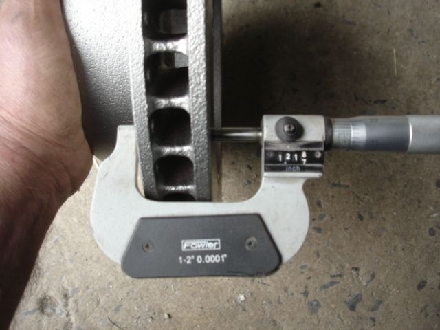

What is sad... The 1.215 is stamped in all the factory rotors.... how could you be in this business and not know that.

NO...I am not that good to see thousandths of an inch...my sense of feel is rather scary when I do rear wheel bearings and then check them...but not looking at rotors. and knowing exactly how thick they are.....the photos showed how I measure them and the tool shows how thick they are.
BUT..I can look the thickness of each surface where the cooling fins start and see if one side of the rotor has been turned excessively ....thus...allowing that surface not to be able to dissipate the heat as well as the other side of the rotor that is still thick. BOTH surfaces should be really even in thickness.

I posted photos of the measurements of BOTH rotors and I can see them

OK...I did not do this for any benefit OTHER THAN passing along what I had come into my shop. Naming the company is pointless because many of you would tear them a new backside and those of you who would do it know who you are. Some of you guys are relentless and are lacking the ability to have a bit of understanding and compassion. Instead ...some people choose to go for the jugular.
I OBVIOUSLY can not say if this is a common practice from this company.
I made my views heard and IF they choose to use them...that is up to them.
I was only trying to make sure you guys and glass out there DO NOT ASSUME that it is good just because 'so and so' did it.

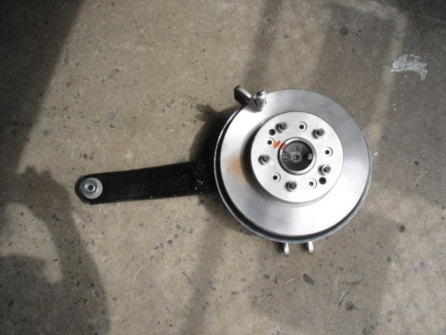

Here are the photos of the rotors again just in case no one can see what I measured. Because for the life of me I do not know what other photos you would need to believe what I wrote.
The trailing arm before I removed the rotor and installed a new one and indexed it in.
Ernie
I know these numbers even without have to look in the manual... and what blows my mind is that they wanted to argue the facts out of the service manual.
REGARDLESS if they are still BARELY above discard thickness. They were turned down BELOW the 1.230" MINIMUM THICKNESS AFTER machining.

Obviously you must have missed what I wrote. Here is is again from the initial post.
The sad thing about this is that the rotors that were sent with the trailing arms where at 1.247" and 1.245" respectively. If I still had them at the shop I could have saved them and not needed to cut them down as badly as they had. I assumed they knew what they were doing... a big error on my account for assuming that.
They machined these rotors way too much because a new rotor is 1.250". So the rotors that were send to them were darn near brand new.
The only 'hair' that they did was machine them to the point that they were literally a 'hair' on each side above from throwing them away (which I did anyway)..and IF these rotors were used and new pads go in and get broken in and used...the rotors would be right at discard thickness.
