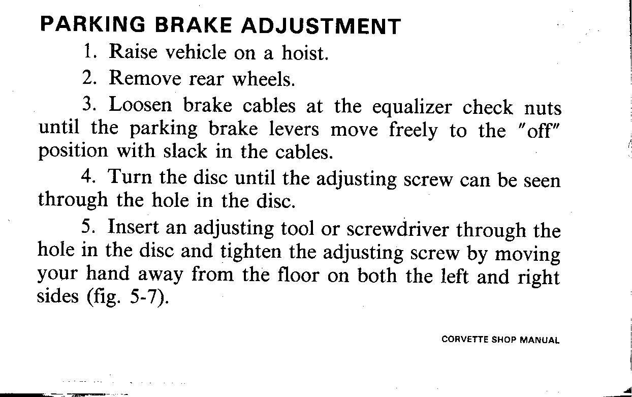

Originally Posted by DUB
Just like the thread stated. This is a warning.
I am NOT going to give the name of the company that did this service...becasue all I am trying to express is that you should NEVER assume anything...regardless on who it comes form...and you will shorty read why this is true.
These are FACTS and not my opinion on this matter and unless a person chooses not to acknowledge GM's service information...then I guess that person will want to debate this.
First off...read this out of the GM Corvette service manual.
it CLEARLY states that when a rotor is being turned down...it CAN NOT be surfaced thinner that 1.230". So,,,turning it to 1.228" is not good or any thickness under the 1.230"
I customer of mine sent his two trailing arms out for rebuilding at this company because the costs were cheaper than if I did it. There was an extra charge for indexing the rotors to the spindles and I told him I DID NOT want the rotors riveted back on due to it is not required.
The company that he sent them to, who I know should do a good job due to being in business a very long time. When the trailing arms came in the trailing arms looked very good. And the rear wheel bearings were also done correctly.\
But here is where the problem begins. The rotors were machined BELOW the minimum of 1.230 when completed.
These two photos show what they measured at.
1.219"
1.218"
Not that this was bad enough...that these rotors are now about .003" to .004" of an inch from discarding them....because if you remember...in rotor information above...it clearly states that discard is at 1.215".
The sad thing about this is that the rotors that were sent with the trailing arms where at 1.247" and 1.245" respectively. If I still had them at the shop I could have saved them and not needed to cut them down as badly as they had. I assumed they knew what they were doing... a big error on my account for assuming that.
Also it is a crying shame that this company has not figured out how to use the shims that are available ...even if they rivet the rotor back on so they do not have to machine off so much metal....OR...realize that they are turning rotors down too far.
Thank goodness I did not have the rotors riveted back on because when I went in and installed brand new rotors and indexed them by using shim material as needed. I also noticed that the adjuster on one trailing arm was not installed correctly and it needed to be corrected. because its position is critical in order to follow GM's outline on how to tighten up the parking brake shoes for adjustment. IF these rotors were riveted back on..it would have been a waste of time and money.
Correct procedure to using the screwdriver on the adjuster.
Clearly stated in the fifth paragraph. Your hand raises up when tightening the park brake shoes. One trailing arm was backwards and I had to go down with the screwdriver. Something that should NOT have been overlooked if they were paying attention....or trying to do so much for so little money.
Lastly here is the written text that states the rotors do not need to be riveted back on. People can do as they wish in this area...but I prefer not to for making it easier on some service operations.
So...just because your trailing arms come in looking great may still make them not right.
