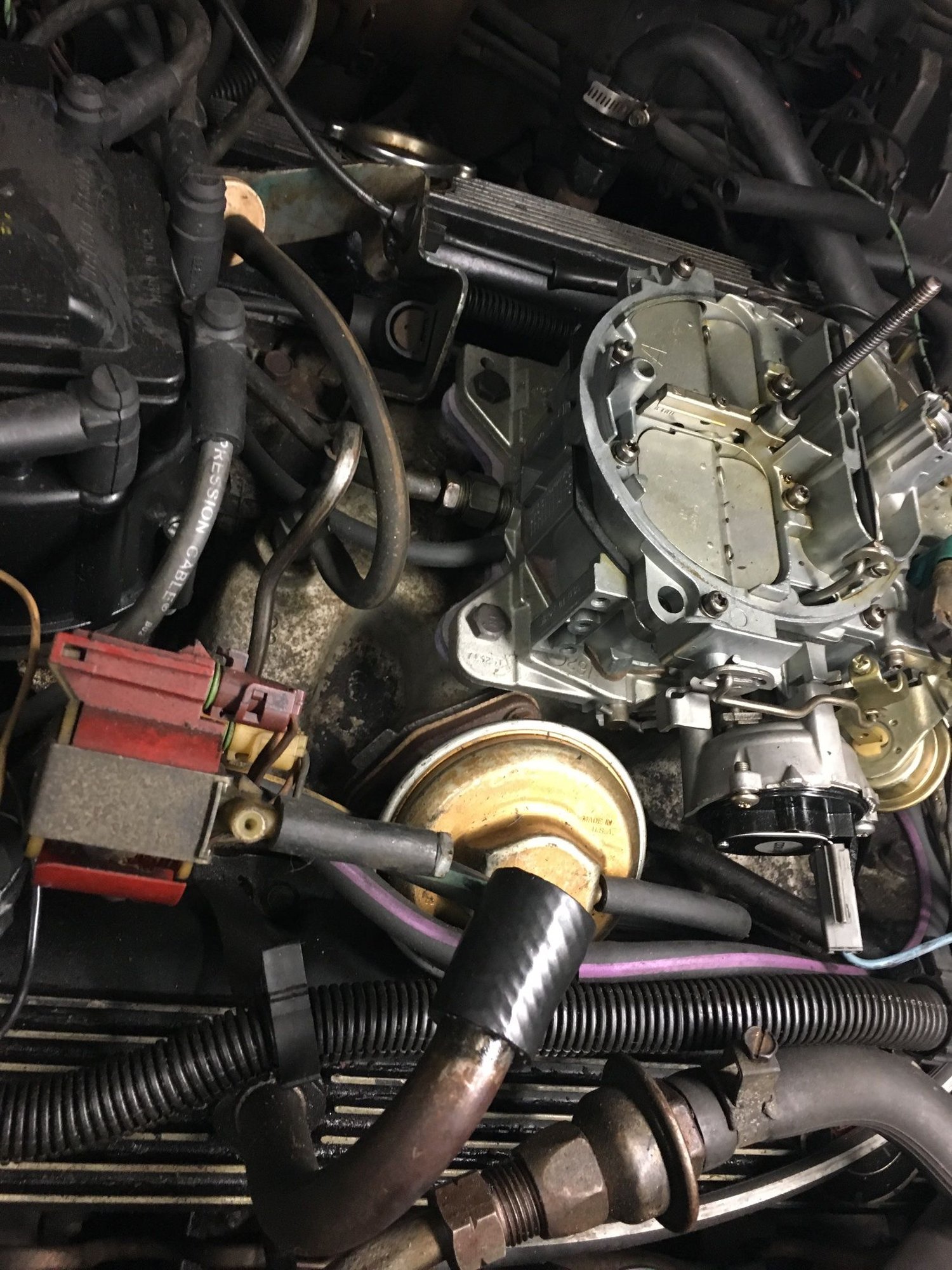

I'm new to the 1981 CCC thing (also just got this car). Trying to decide if this carb is computer controlled and will need to be replaced along with the distributor (I'm taking the ECU out). I know it's not the original carb and I notice there is a vacuum port missing on the back/top of it that goes to that red thing. It's a quadrajet 17085204.

Yes, that is a CCC

Any idea why the port is missing on the back?

Not sure why you want to "play with the carb". That's the advantage of the CCC (ECM) computer controlled system on that car....the ECM does the adjusting--and does it pretty well on a working system.
I would advise you to use the car a while before just throwing stuff out that still works. You may find that you like not having to mess with it.
P.S. With that system, you can still upgrade the engine with cam, heads, pistons (if you want); and it should still work fine. That Q-Jet is capable of dumping 750 cfm into the engine (likely only puts 500+ cfm into the existing engine).

It's for sure not something i'm going to do right away. Currently I'm taking the oil pan off to repair/replace it (has a huge dent and leaks). After that and some other minor repairs (door locks frozen, speedo cable lubing) I'm going to drive it around as is for a while (well, after I also hunt down a vacuum leak and replace the broken choke module).
