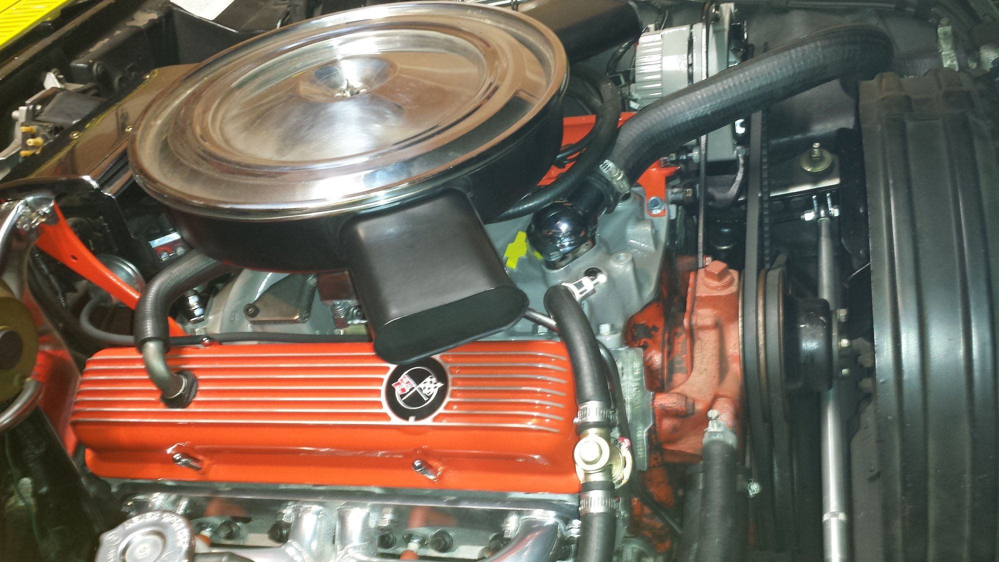

I put spacers under mine, I needed a lot more than just dual gaskets.
Without spacers:
Spacers:
Referring back to your original question, your "raised valve cover rails" will reduce your need for spacers/tall valve covers/thick gaskets.
