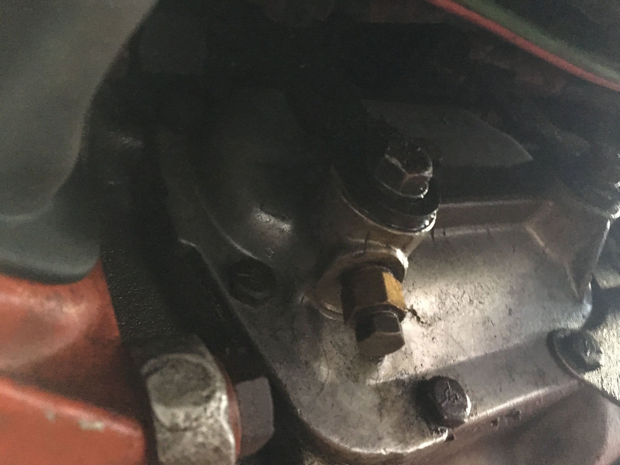

I have looked all over and I cannot find out what this bolt with a plug coming out of it is. This is a Muncie m20 oringinal to my 72. Does anyone know what this is for.

I believe that is for the high-range switch used in the T.C.S. system (transmission controlled spark). It was an emissions control strategy used for a couple of years on base engines [eliminated the need for the A.I.R. pump stuff].
When in high gear (or maybe 3 & 4 with the 4-speed), that switch would allow manifold vacuum to be applied to the distributor vacuum advance can. In low ranges vacuum advance was defeated.
What he said.
Mine still has the thermostat but the electrical connection is disconnected as I'm not using TCS.

Thanks Guys.
That makes sense as mine is not hooked up either.

also that switch leaks after a couple of decades. which is probably why there is that brass plug there..
Yes it does. That is why I was looking to replace it.
Thanks.
Joey

You don't need the T.C.S. system. In fact, you don't WANT the T.C.S. system.
I just wanted the proper part to stop it from leaking. I am not going to hook it back up.
Joey
Joey
IT will leak again. New switches are no better than the originals were.
Are their any good solutions for it?
Joey

Solution to permanently delete the TCS and stop the leak would be to figure out exactly what thread the hole in the trans side cover is and install a proper plug, making sure the plug does not seat so deep it locks the 3-4 shift fork shaft.

It doesn't appear to be leaking now. Why not just leave it as is?
