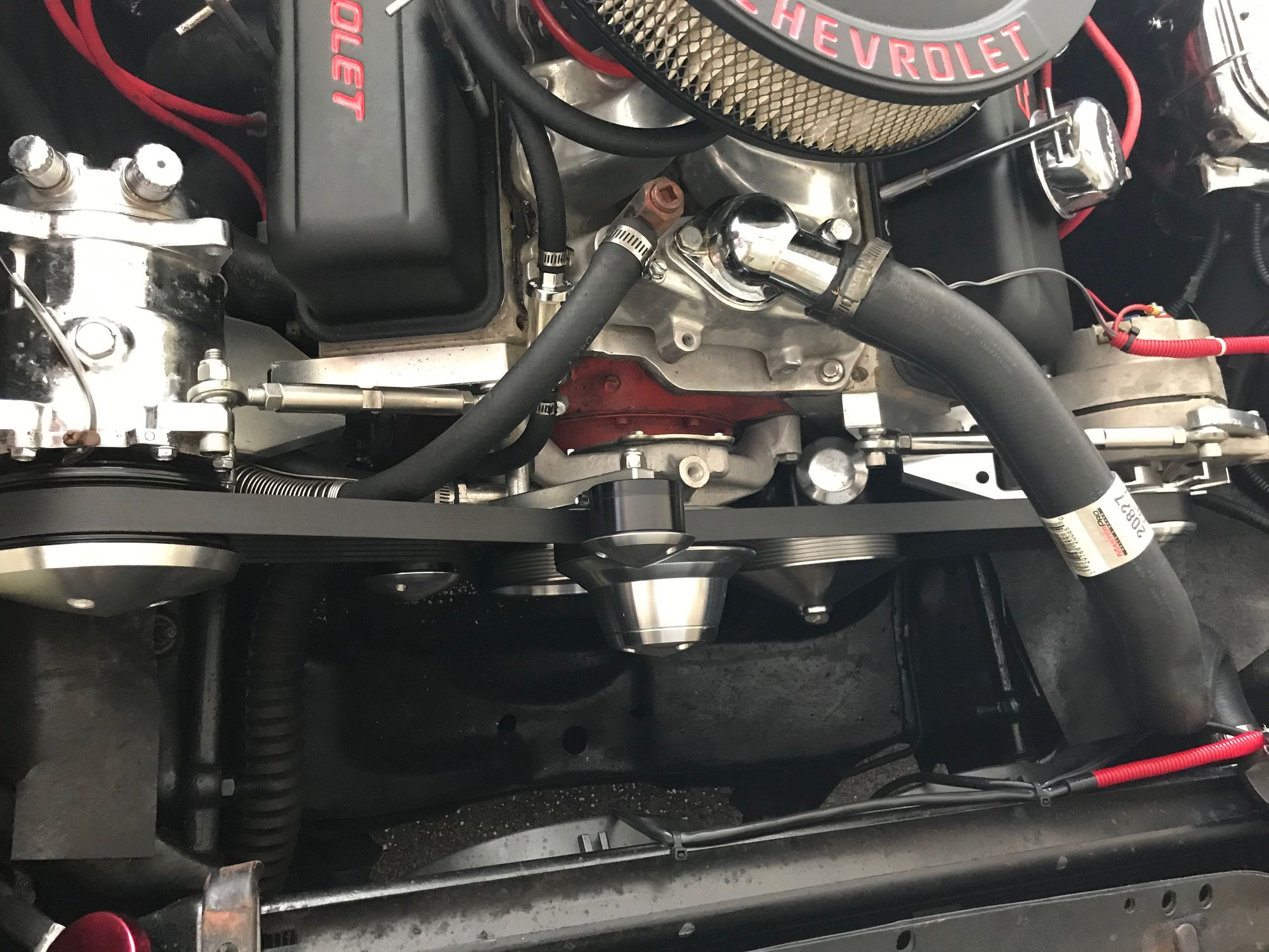

Originally Posted by Jebbysan
As stated by a couple of other members in this thread....I cannot stress the importance of correct timing on overall engine performance which includes cooling. I would hope your mechanic would start here. The reason you SHOULD start here is because for one thing it is free/cheap.....the other is once it is right, then you can go determine if chasing fans and radiators will be beneficial. A good mechanic would go here first and if your mechanic scoffs at it, find another. Also, if the mechanics claims to be able to set timing by ear, lose his/her number.
After timing is set, have them perform the idle screw adjustment just for the hell of it. The two go hand in hand.
Do you have any pics of the engine compartment?
Good luck to you and post your results!
Jebby

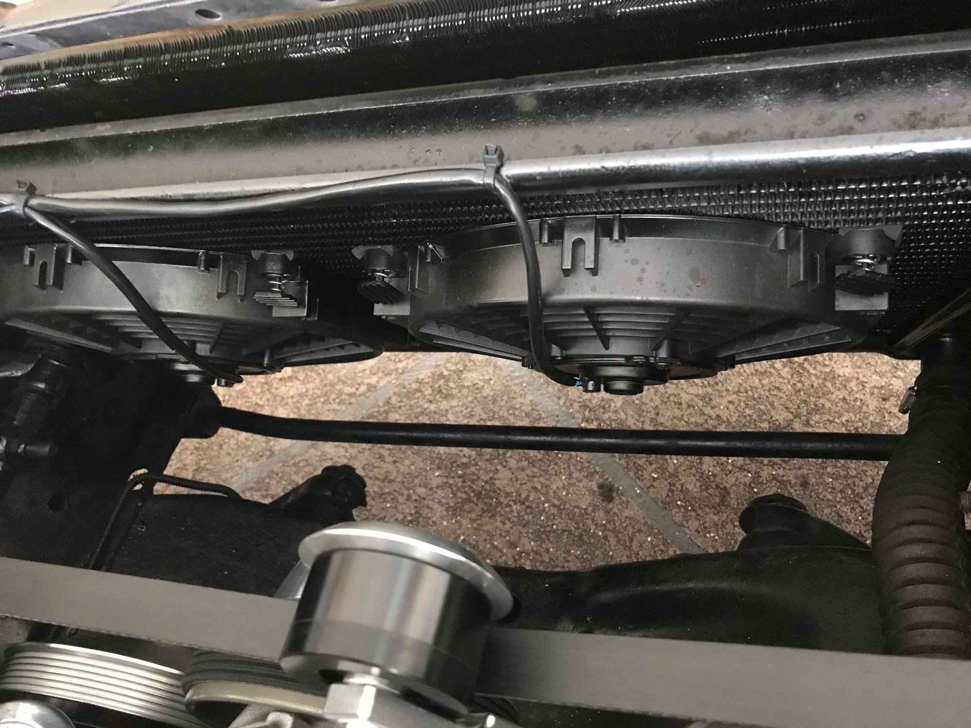

you need a shroud so you pull air thru entire radiator and enough cfm to cool 500hp.... I have a 383 with 525 hp and mine never goes over 190* , in 110* heat in traffic with A/C on

first you need to install the core support seals and radiator seals, most of the air while driving is bypassing the radiator and passing over the top of the core support and around the radiator. While sitting the air is circulating from the engine bay back over the top of the radiator and back through the radiator (hot air).
You need the seals,
Neal

Originally Posted by DaveL82
If the fans are mounted to the rad and you have open areas on the rad I had the same issue. Stock system requires ALL foam to seal air leaks in place.
I now run a dewitts aluminum rad but the ticket was their shroud that includes 2 fans. No dead areas as it draws over the entire rad.
agreed... looking online for a shroud. Mechanic coming tomorrow to help with exact measurements etc. thanks for great advice.
Agree. Looking for a shroud to fit now. Good advice. Thanks.
You need the seals,
Neal
Where can I learn more about seals? Apparently the last guy who actually installed the radiator didn’t install any. Thank you.

That's what I have with my Summit Radiator and Mark 8 Fan. If nothing else just for you to check it is making a difference. You can always exchange them later if it matters to you.

The gap over the radiator and between the hood has to be sealed so air will be forced through the radiator and condenser. Air will take the path of least resistance, around the radiator. Also there are gaps on the sides of the radiator at the core support that need to be sealed, the idea is to make all the air pass through the radiator.
This may not cure all your cooling issues but it is the first item that needs to be fixed, wont know until this is taken care of.

Good to know. Can you post a photo or a link where I can see what the seals look like installed. I’m finding pictures help me convince my mechanic to make changes without an hour of discussion. Thank you

Well Penelope you've had a lot of ideas thrown at you. Get the shroud and existing fans installed and see what happens. That's my advice.
I don't have a shroud for my fans, but I also don't have any of my ac parts, the condensor sits in front of radiator and hinders air flow. Since I don't have that, my car does ok with temp. Since you have ac, the shroud is gonna get you that air flow that is probably lacking.
