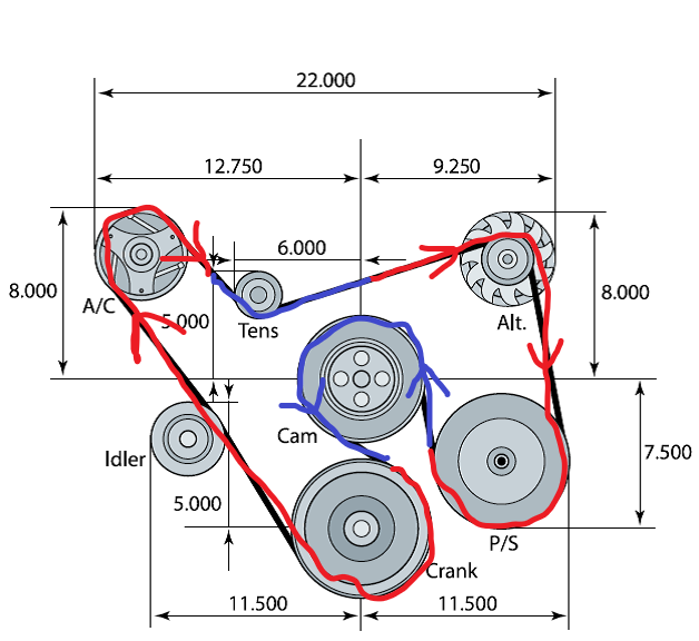

jim2527's Avatar
jim2527
Joined: Apr 2003
Posts: 19,347
Likes: 654
From: Tampa, Florida
Originally Posted by Doug1
Yeah, I'm a little confused, besides the good point that you made on the impeller blades. Isn't the radiator designed to have water flowing in a specific direction for optimal cooling?
Yes. Left to right and top to bottom. (from the drivers seat)
Reverse rotation: Pump spins opposite direction but the vanes are opposite. Like multiplying 2 negative numbers. -1 X -2 = +2 Flow is still in same direction through the block and heads
Reverse flow: Flow is backwards through the heads and block.
An old fashioned V belt everything spins clockwise (from front of engine). Multiple belts are used to spin parts on opposite sides of the engine. Everything spins clockwise.
A serpentine belt weaves through the components. Due to this design there's a sacrificial lamb....the water pump. It spins counterclockwise. This would normaly pump water the wrong way but Chevy flipped the vanes so water flows in the same direction.

jim2527's Avatar
jim2527
Joined: Apr 2003
Posts: 19,347
Likes: 654
Sorry for the crudeness. Blue line is where parts spin counterclockwise. Red is clockwise.

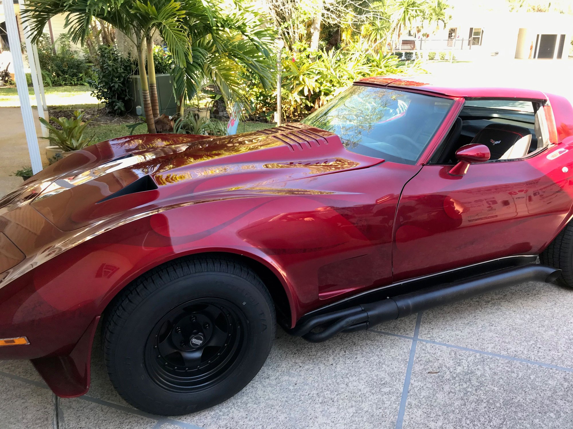

  #96
Penelopegirl's Avatar
Penelopegirl
Joined: Jan 2019
Posts: 63
From: SE Florida
I thought all you guys deserved to meet my Penelope. This was when I brought her home with new American Racing wheels and new tires. You know girls love new shoes.
Dianne

74_stingray's Avatar
74_stingray
Joined: Jul 2018
Posts: 875
Likes: 289
From: LaFayette Georgia
C3 of Year Finalist (performance mods) 2019
St. Jude Donor '19
Dianne
Looking Good, love the black side pipes with the new wheels.
Eddy

Street Rat's Avatar
Street Rat
Joined: Aug 2010
Posts: 5,339
Likes: 546
From: Central Texas
Dianne
I like it.
The ghost flames are nice. Sidepipes really makes it look bad ***!

Big2Bird's Avatar
Big2Bird
Joined: Dec 2006
Posts: 8,837
Likes: 1,028
Dianne
Pretty car Dianne.
As for buying the De Witts, go ahead while on sale. It "may" not solve your immediate issue, but considering where you live and that crappy fan mounting, its going to be a vast improvement no matter what.

Big2Bird's Avatar
Big2Bird
Joined: Dec 2006
Posts: 8,837
Likes: 1,028
Originally Posted by Street Rat
I like it.
I agree. Most restomods are off the charts (IMHO). This looks nice.
