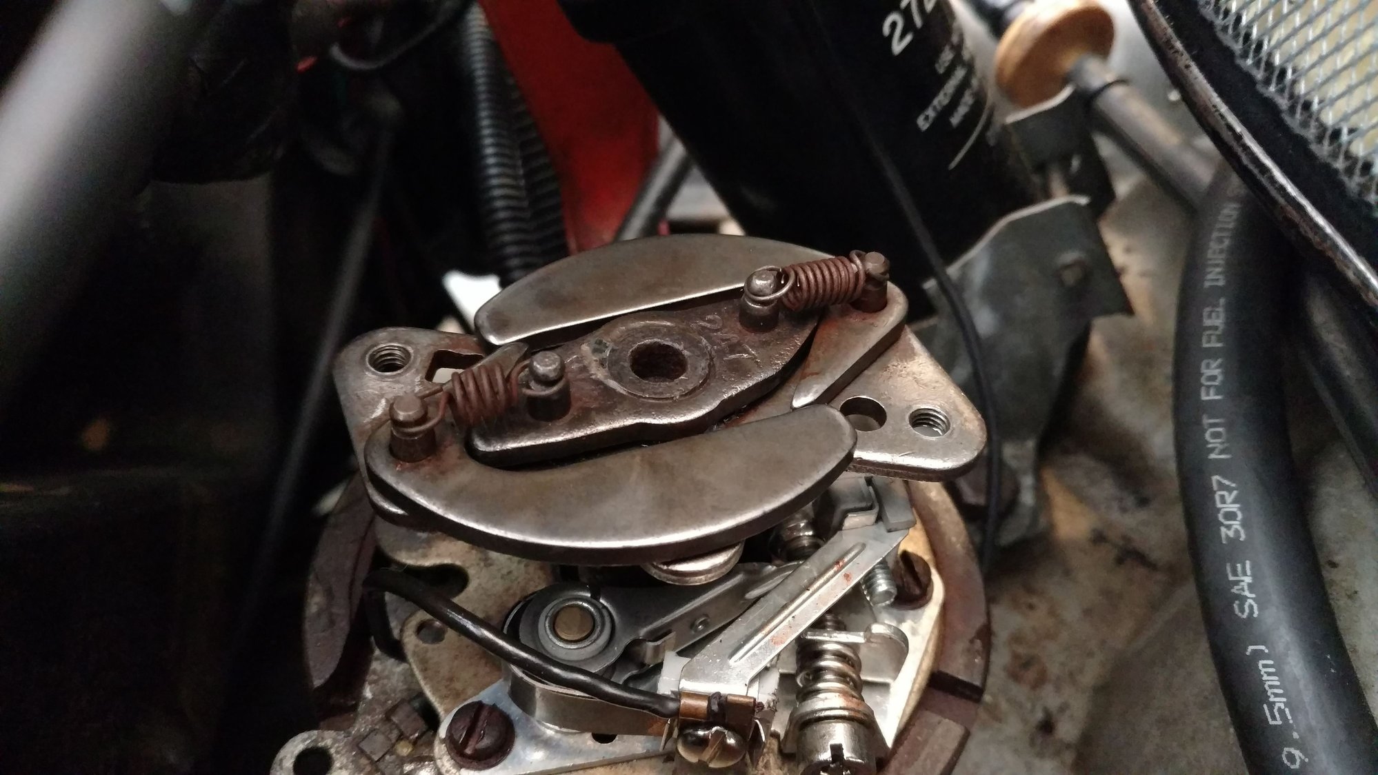

can you see the advance stop bushing, you may need something like a dental mirror?
the original was plastic/nylon and maybe gone or damaged.
did the spring kit you bought contain the replacement brass bushing and if so, are you will to pull the distributor to install it.

Here's a picture of my distributor - I don't see any advance stop bushing unless I'm missing something obvious:
Edit - I think it's hidden in this picture (beneath), so I need to check.

I did determine that the advance stop bushing was missing, so I used one from the kit. Not sure it made much of a difference as I just re-checked with original springs and the curve turned out to be about the same. I am getting 36 mechanical just around 3k RPMs and it will jump past the mark if I blip the throttle. Should I be concerned about that or just leave well enough alone? I will lug it around a bit at low RPM's to ensure I'm not getting any knock at WOT.
