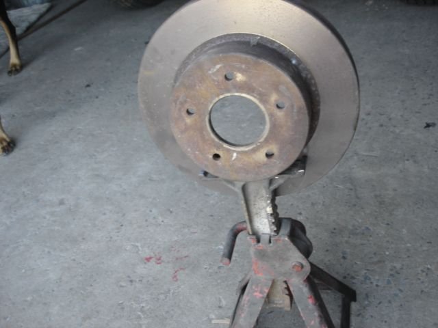

Will do tomorrow..I may not have a car up in the air...but I will use a rotor on a jack stand to show where I set the jack stand which should be good enough.

For those who need a photo.
As described.
DUB
As described.
DUB
Literally, a photo is worth one thousand words.
Thanks, Greg

****DISCLAIMER****
30+ years of doing it this way and NEVER had a Corvette fall. I will slide under one all day long that I set up like this and have no fears at all. BUT...I am not liable if someone decides to treat the car in an aggressive manner that something happens because they are not thinking clearly ( such as trying to install an engine when it is supported like this)....or set up the jack stands where they are only barley contacting the rotor. I am not liable of foolishness and lack of common sense.
Thanks, Greg
I am glad it helped clear up any questions.
I can say...that when doing this and putting them under the rear rotor.s..and obviously you either have the lug nuts on to hold the rotor in place or they are still riveted on. When lowering the car...do it slowly and while applying pressure to your jack stands.... you will need to help them move/slide outwards a bit due to the rear suspension is settling. If you lower the car too much..the jack stands will start to tilt and get in a position that trying to get them to settle will be really hard to do.
And not need to freak out because you still have the floor jack under it. AND many times I put my jack stand on cardboard so they will slide easier. Once they are flat on the floor...all is good.
