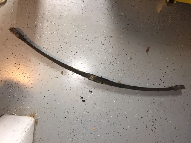

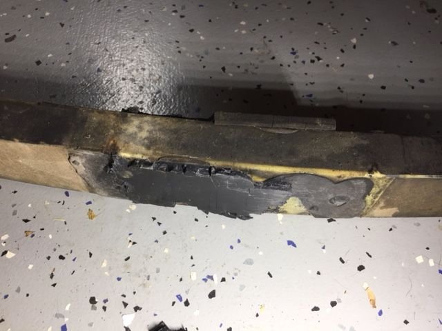

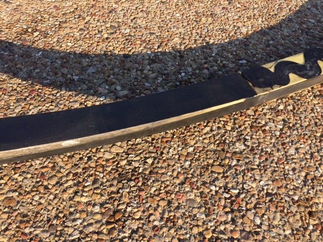

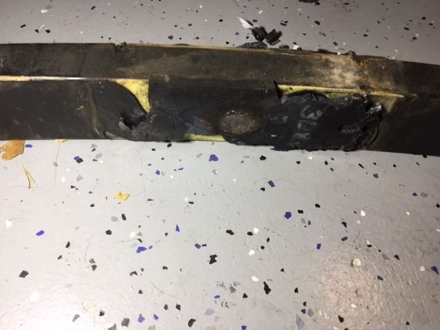

There's a brittle, crumbling material at the center of my rear composite spring. It's on both the top and bottom sides. It appears to be about an 1/8 to 3/16 inch thick.
What is that material? Is the spring shot or is that material replaceable?

spring looks ok from here , There are normally 2 spacers that are taped above and below the spring to compensate for the lack of 7 or 9 steel leafs. Looks like your spacers have crumbled up , this happened to another guy on here a few months back .He sourced new spacers and re-used his spring .
Having said that you would be wise to clean up the mono spring and look for any cracks or damage before you try to re-use yours.

Unfortunately, after cleaning the springs it looks like a large splinter has come off the edge of the spring.
Is this bad enough to affect its performance or safety?

I would replace that spring if it has any damage at all. It is not worth having a major accident with the spring, possibly hurting you and the Vette. Who knows what is going on inside of the spring, plus the uneven arch in the spring in one of the photos. My .03 cents

It really depends on how deeply the damage goes. If it is just surface damage, you might be able to knock off any 'bad' material and then smooth/blend any imperfections that could become stress-risers and the spring would be fine. But, if the brittle stuff has any depth to it, you need to replace the spring.
These glass springs NEED to have metal heat shields between them and the exhaust pipes. If yours did not have any heat shielding, that's how the spring material got damaged (brittle). Do some research on the net (Google is your friend) regarding proper installation methods and heat shielding requirements.
