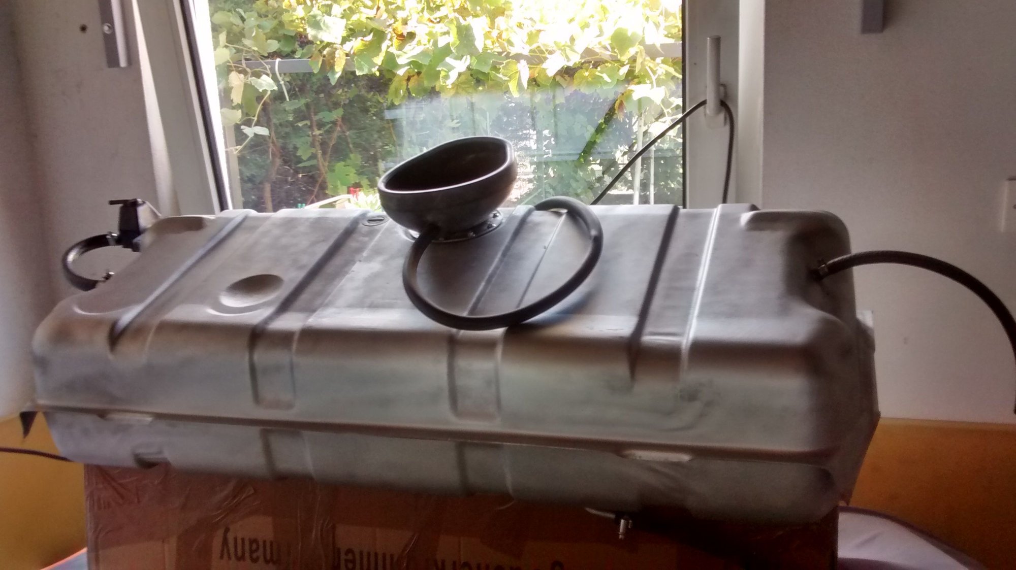

Originally Posted by TPIShark
I know this is an old thread, but I have a similar problem with a '71, only it's leaking at what appears to be a vent that is spot-welded to the top of the tank, just to the left of the filler neck? The tank itself seems pretty new...
To the left of the filler neck? There shouldn't be anything there, only bolts holding the filler neck to the tank. Have you checked the filler neck gasket? See the picture for reference.

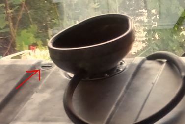

Hi Primoz, thanks for chiming in. I'm getting fuel from that disk you see in your photo, just to the left of the neck, inside the recessed area. . Seems like it might be some sort of valve?

Right here:

2017 C3 of Year Finalist
That is a flat metal valve. Haven't seen it sold as a separate part and only comes with a fuel tank. Does it leak only when the tank is full to the very top?

From: Clarksburg NJ
That's what I'm suspecting. I think he's getting it filled too high. No, I wouldn't dream of trying to replace it; it's welded on. The tank seems fairly new. I'll try calling Quanta again tomorrow to see if I can get someone to help me.
