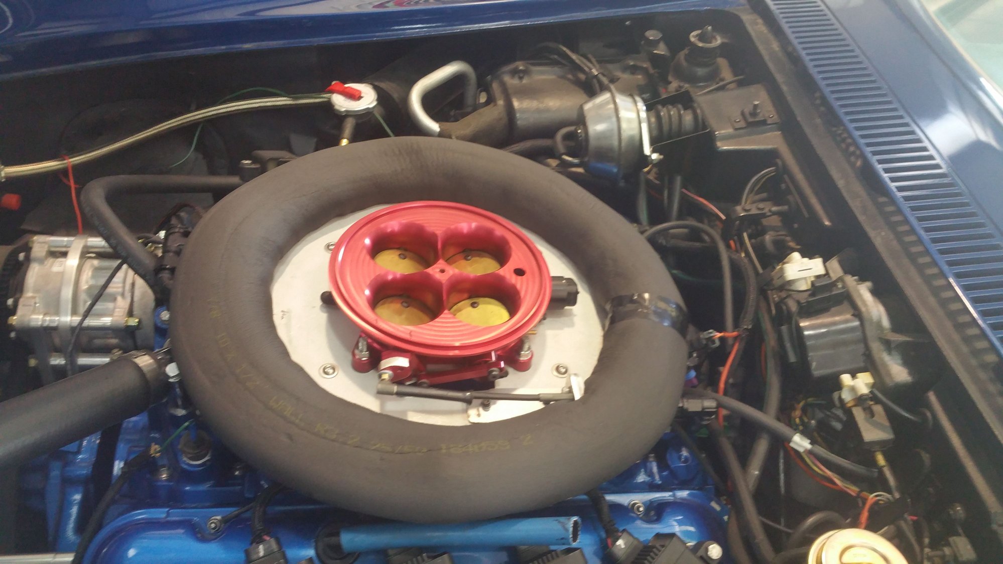

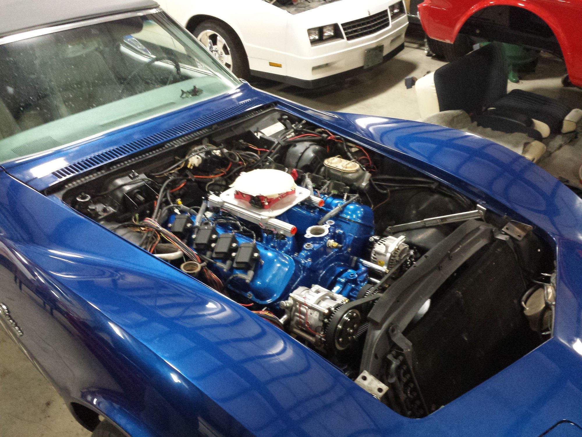

Last year I put an Aluminum 541ci DART BB in my 69 vert with the design criteria that is had to fit under its factory stock L-88 hood. It utilized the Holley Dominator EFI 60-2 crank sense, FireStorm cam sense distributor with coil near plug, Super Victor intake modified for multiport injectors and the FAST throttle body. Fits perfect.
