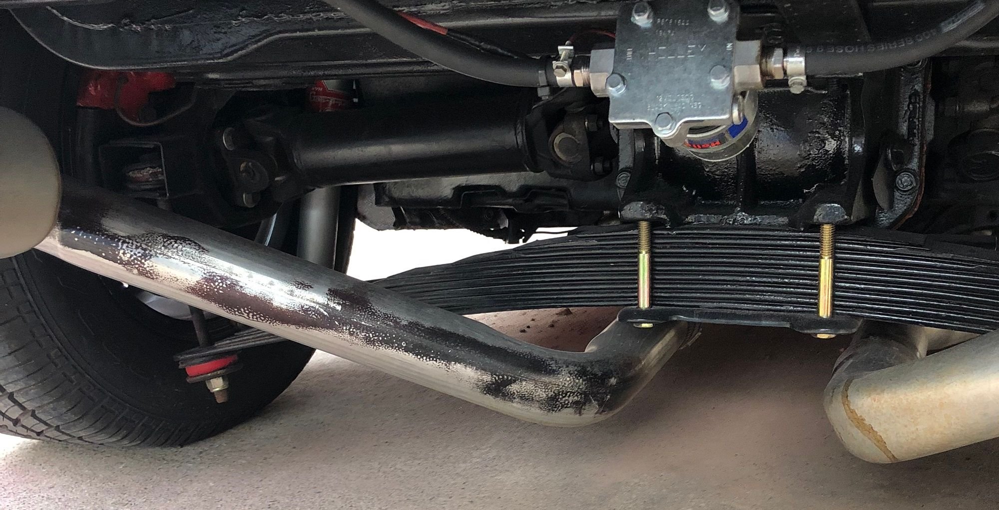

I shortened the rear spring and have plenty of clearance between the tires and spring. I'd love to go to a different spring that wold give better handling and also lower it some more. I'm not worried about ride quality.
here are some pictures of what i have ATM. I'm not sure if its stock or not.
It is a 79 with a 327.

HOWEVER, looking at the picture you posted, it looks like there's only a couple of inches between the ground and your exhaust pipes NOW. How are you going to lower it 3-4"??

In your picture it appears the spring bolts and even the ends of the springs are lower than the bottom lip of your wheel. if you had a flat or blowout this could cause catastrophic damage to you, your car and possibly anyone near you on the road. If you want your car lowered, do it safely by replacing your spring.

thanks for the input, guys. The pictures are sort of deceiving. I've got about 2.5" clearance on each end of the spring. I'm painting the car ATM and will be going to side pipes so wont have to worry about under the spring.

In your picture, your half shafts are about an inch higher at the differential than at the trailing arms. With 10 inch spring bolts already installed, I think you have something wrong in your current setup that needs corrected before you compound the problem trying to lower the car even more. I would suspect you have an incorrect spring in the rear. I'm no expert, this is just my opinion. Think safety first.

When you shortened the longest (bottom) leaf you effectively raised the the amount of weight it takes to deflect the spring a given amount
Think about someone on a diving board.... the further a person walks out on the board the more it bends.
You cut the 'board' shorter so the person can't bend the board as much.
Shortening the spring raised the car..... if you had cut it even shorter the car would be sitting even higher.
