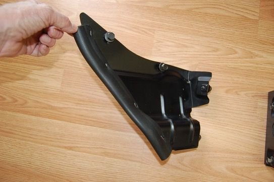

I realized that on my '71 when turning sharply the wheel hits the back of the inner fender. On a closer look I noticed that I was missing what I believe is called the outer splash guard on my left side front. I believe this attaches to the inner fender with bolts and also to the frame and front of rocker panel. I do not see how it attaches to frame or rocker panel. Can anyone give direction on how to replace and what parts I need? thanks

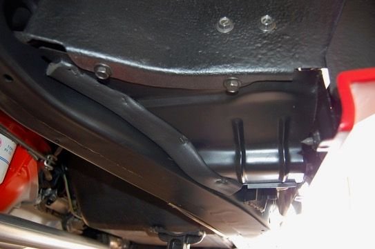

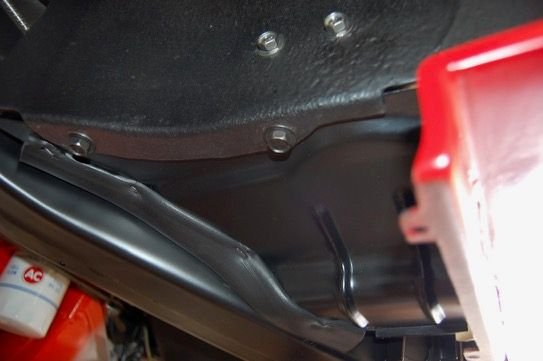

Hi x,
The splash shield is mounted using 4 bolts:
2 through the bottom lip of the inner apron
2 through the rocker fiberglass.
There are left and right versions of the shields... they're not interchangeable.
