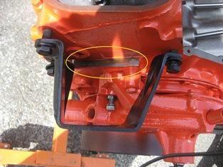

A 618 is a 4" bore block and can be either a 2 or 4 bolt. With a 69 cast date it is probably a 350 unless a CE block.

The point you are pointing is the alternator on my engine.
I don't remember any thing behind that (that's way I didn't take a picture) and on the other side engine head there's nothing (visible at the picture)

"Counter Exchange" (or Chevy Exchange depending on who you talk to). A warranty block. On the stamp pad Alan is referring to there is a sequence of letters after the partial VIN number called a "suffix". The stamp pad could have the original suffix (that tells you exact what engine it is and what car it came from, Google the letters) or a "CE".
Where's the cast date is seen?
D109
April 10, 1969

Is there's any way to know?
is the round yellow mark under the alternator represent where it should be stamped? cause I don't remember anything visible there.
Yes. But the stamp is typically removed when the block is decked so if it has been machined prior then you will not know without looking at the crankshaft part number or measuring the stroke through the spark plug hole.

Hi IRS,
Have you looked at the pad?
The pad WILL still be there.
Chances are 50/50 or better that the stamped engine assembly information... date, cubic inches, and original horsepower, will still be there too.
What the engine was originally doesn't become a mystery until you determine that the pad is currently blank.

Thank you guys for all the help
By the picture you added it looks like under the alternator base. Am I right?
yes, in this thread you have been given 3 separate pictures showing you exactly where to look. One picture with a big white finger pointing to it, one picture with a yellow circle around it and the last close-up picture.

As far as I remember - nothing there.
The pictures that I added is all what visible on the engine but Ill check again on weekend.
