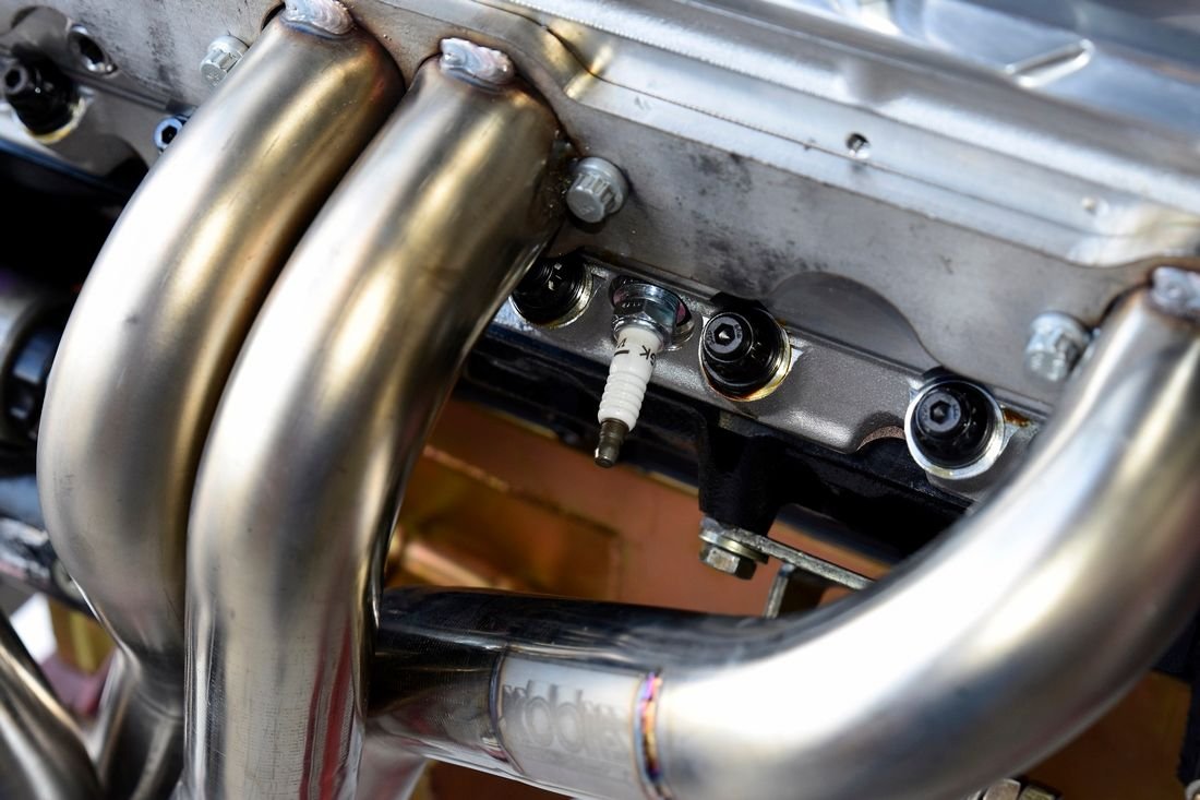

I like the design of the Kooks 1 7/8" tubes......lots of spark plug clearance.

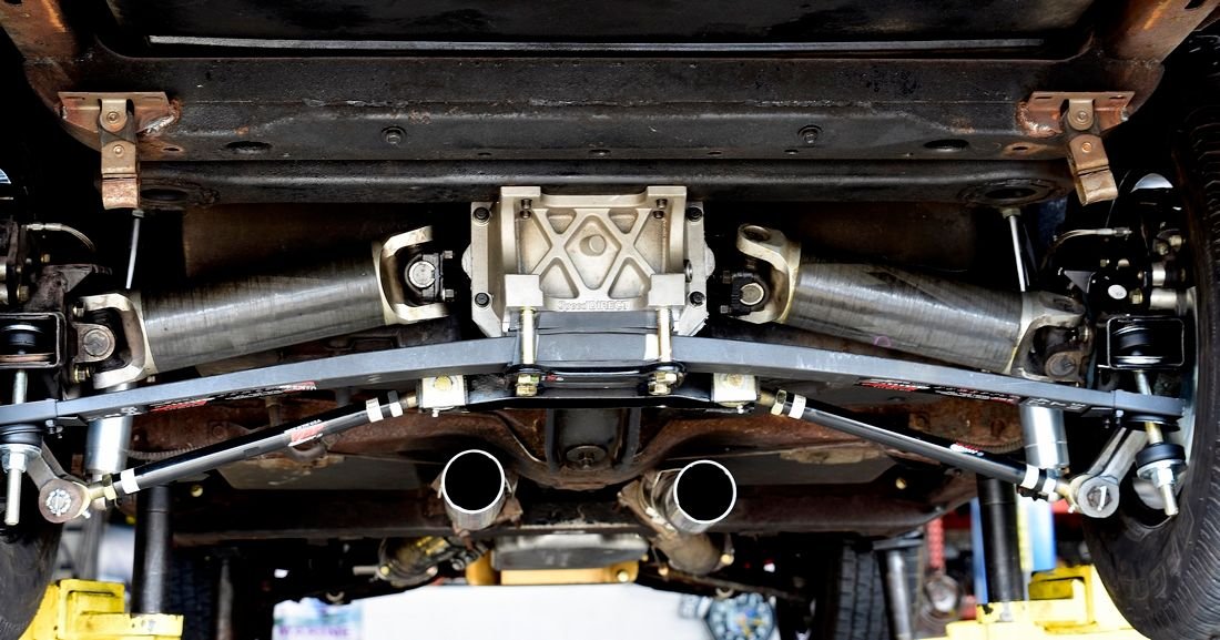

Speed Direct Aluminum diff cover, VBP 420 lb. spring, heim end strut rods..........

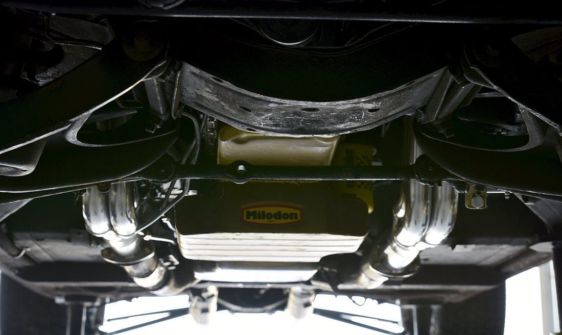

Milodon Road Race Pan..........low profile, 7 Qt. capacity, great fit....Kooks 1 7/8" tube C3 headers..........
