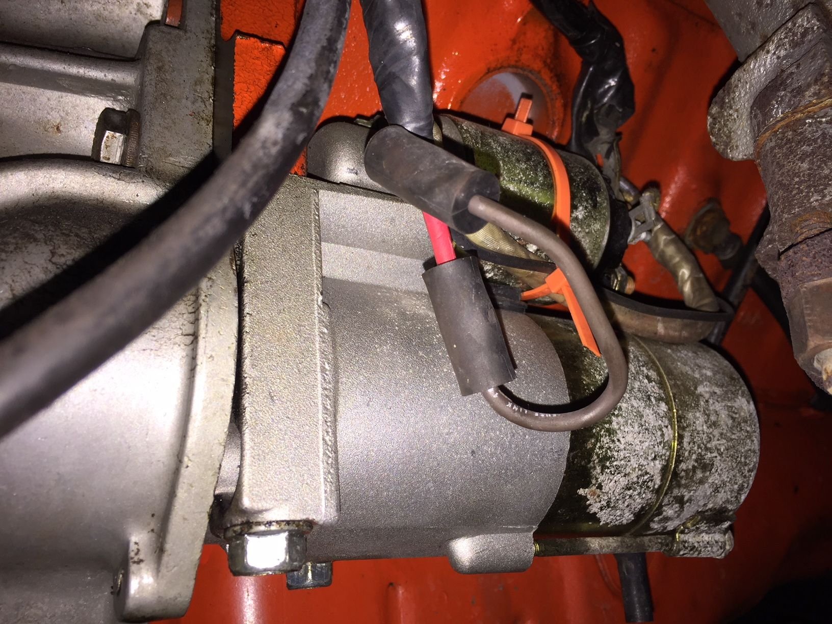

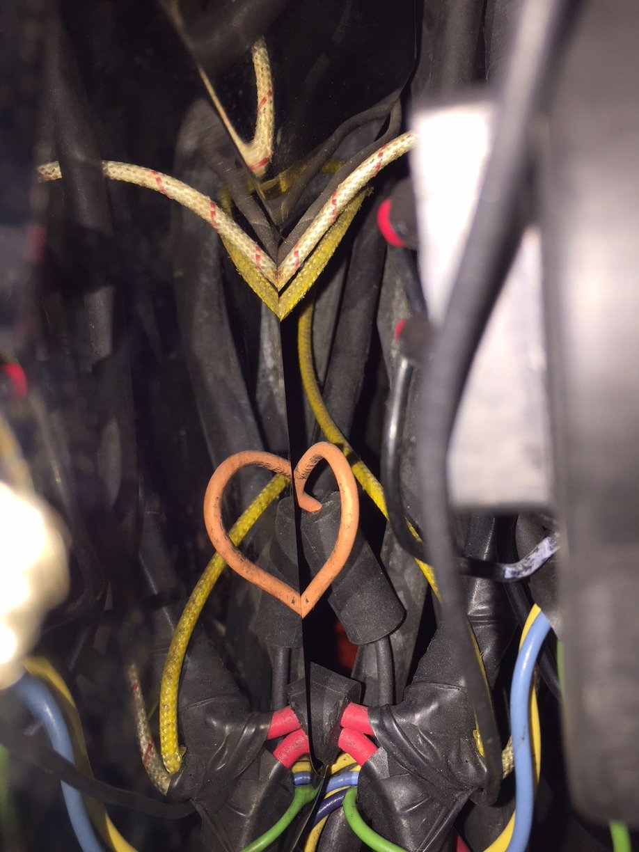

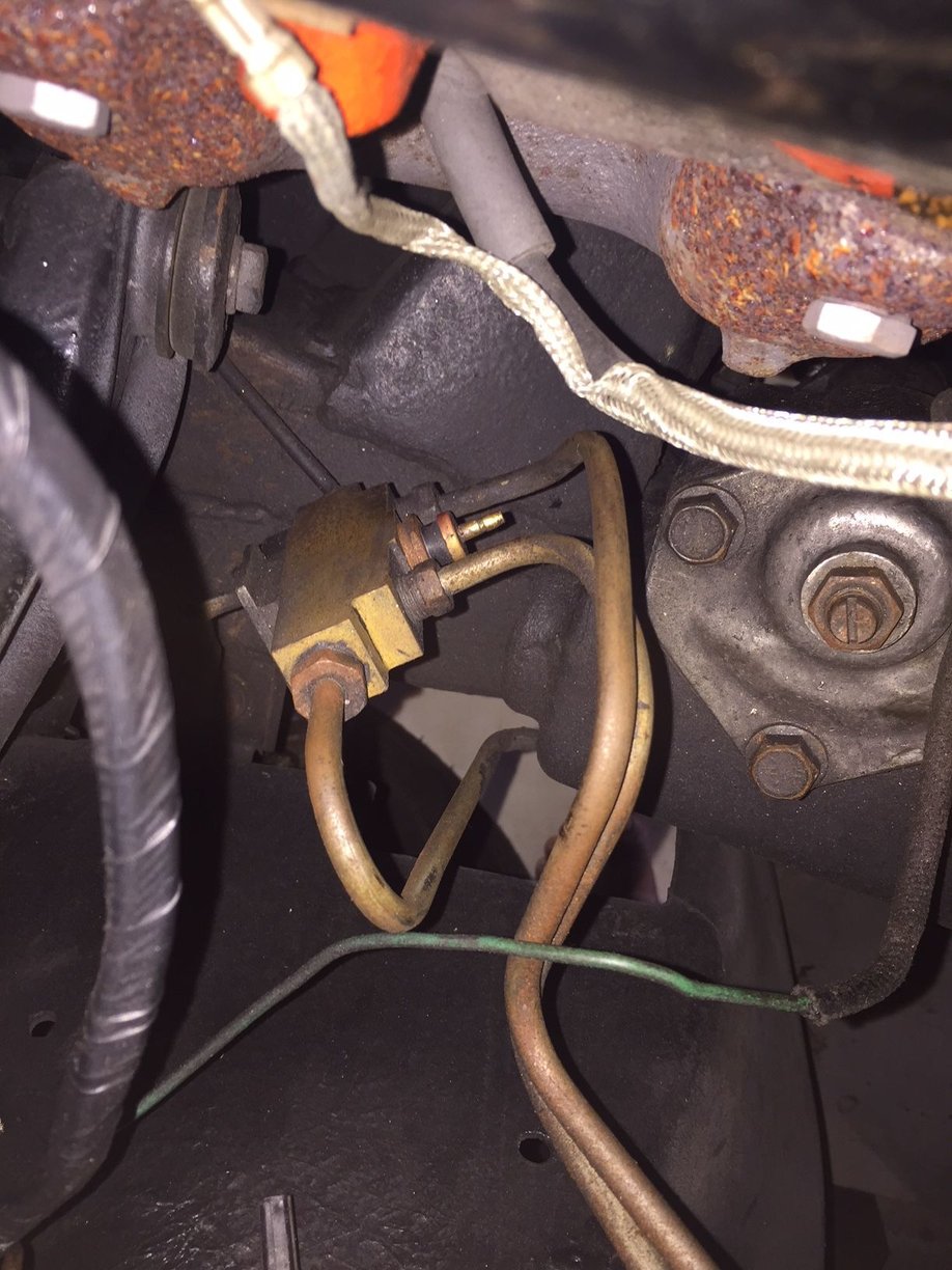

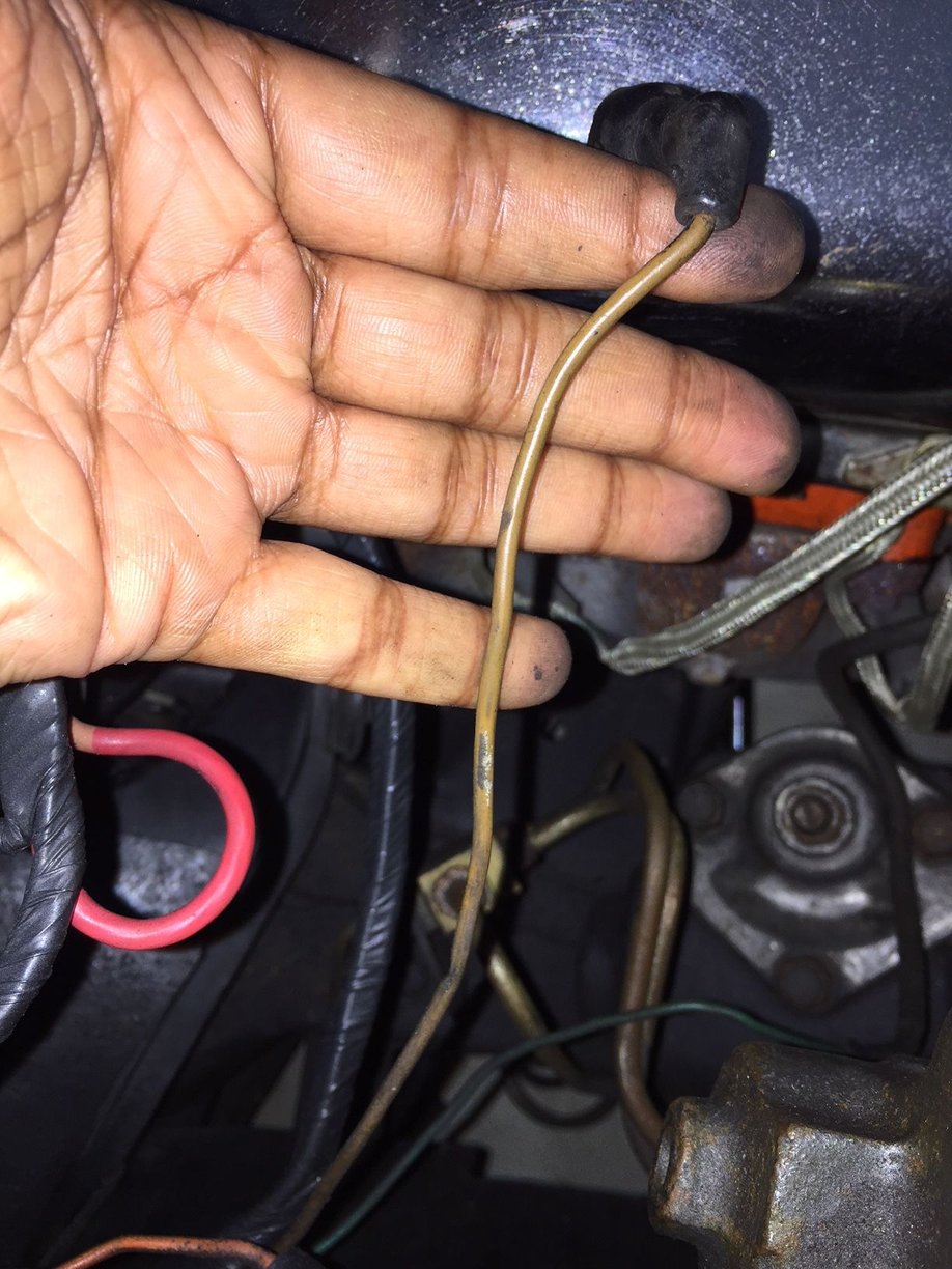

Thanks for all the help, so far I have only been able to drive my corvette home after purchase and haven't been able to enjoy it yet. my luck!
I have had a look at the fusible links and all seems ok (I have attached pictures).
I did notice near the horn relay a solenoid that appears to be missing an input and a electrical cable that appears to have worn through. See pictures. I am not sure what this is.
Fusible link near wiper
fusible link horn relay
unplugged electrical cable
solenoid without input, presumably from the unplugged cable
fusible link at starter motor
Old Feb 2, 2018 | 05:28 PM
Alan 71's Avatar
Alan 71
Joined: Sep 2006
Posts: 31,278
Likes: 4,372
From: Westminster Maryland
NJA,
I'm sorry to hear that you've had some 'issues' with your new to you car.
The wire and connector in your photo is intended for the switch on the brake fluid distribution block shown in the next photo.
But, having that not connected WON'T prevent you from starting your car.
Are you remembering to fully depress the clutch when you start the car?
There's a switch on the clutch pedal that needs to be cycled in order for the ignition to function.
Maybe you've forgotten that?
Regards,
Alan
