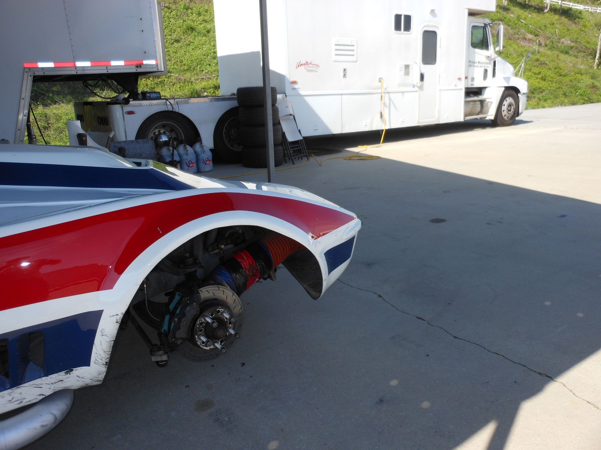

I think what Ed says definitely has to be taken with a huge grain of salt since they race in SVRA Group 6 and are pretty much stuck with having to run the stock suspension setup. Anything too crazy and they get put in GTO/GT-1 class.

If someone told me that the last place a C3 corvette needed to lose weight is over the rear end, I would be suspicious.......
Most SBC C3's have an almost ideal weight distribution of 48%F:52% rear with some years closer to 50:50 weight distribution. For road racing the slight rear bias is preferred with my race style. Now if the have a 78 C3 like mine that has a F48%:R52% weight distribution and you start lightening the front with removal of pollution control equipment like the AIR pump and hardware, AC removal, aluminum heads, removal of the heavy cast iron manifolds etc without removing some weight in the rear like the 50 lb steel leaf spring, the rear weight bias will exceed 52% which would not be ideal in general terms.
In general, any weight removal is good as 69ttop502 stated as long as you can either tune the suspension to the new settings or balance the weight reduction front to rear.

I think what Duntov Corvettes point was with regard to the rear spring is that in high horsepower cars less weight over the rear axle means less traction. The steel spring acts as ballast. Any one with the fiberglass rear mono spring done any amateur level or nostalgia drags? Wonder if anyone has noticed lack of ability to "hook up" using the fiberglass rear spring?
