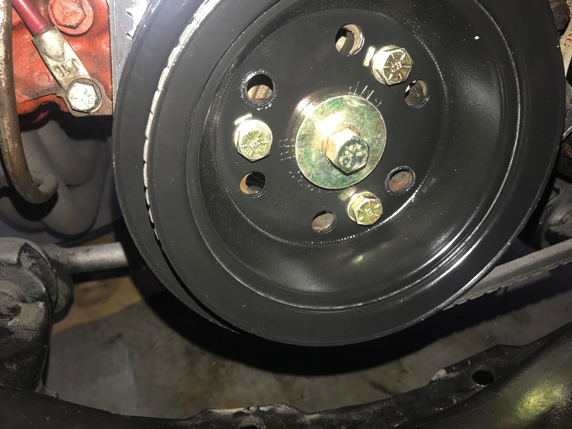

To Vibration damper oil leak

Originally Posted by 68notray
I always put a smear of Ultra Black on both the keyway and the back side of the big damper washer for good measure. Can't hurt, and might just stop the dreaded keyway leak before it starts.
Maybe I am wrong, but is not the washer in direct contact with the pulley instead the damper per se?
Can't remember. But I believe the washer diameter is slightly smaller than the hole of the pulley. Thereby making the washer in full contact with the damper. The pulley is bolted on later with three bolts after the damper / crank bolt & washer are torqued.
I believe the washer is about 1 1/2 dia. And the pulley had a 2" dia hole maybe?
Very strange story about a keyway leaking. Up hill mind you. Crank snout is higher than flywheel flange.
Old Feb 16, 2018 | 10:39 AM
corvetero's Avatar
corvetero
Joined: Dec 2011
Posts: 626
Likes: 15
From: Austin, TX
Maybe we are not talking about the same washer, I was meaning the big one on the center of the pulley.
Is there another one between the pulley and the damper?
