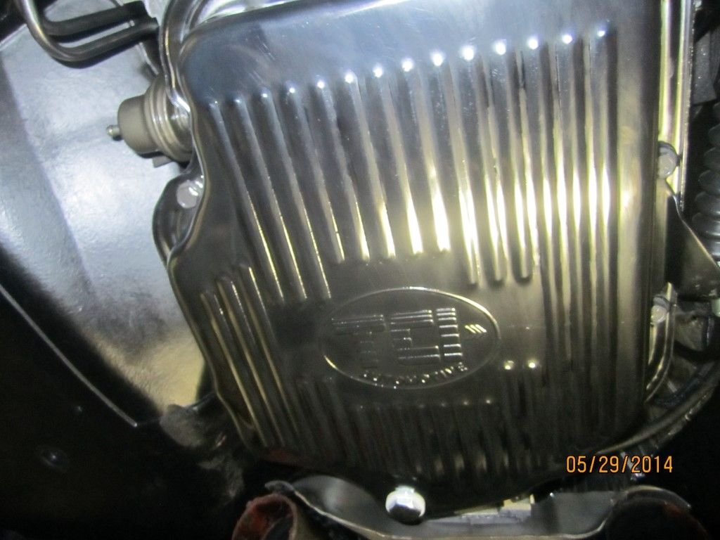

Right in the middle
Old Feb 27, 2018 | 04:45 PM
drwet's Avatar
drwet
Joined: Dec 2009
Posts: 3,225
Likes: 654
From: Thunder Bay
Originally Posted by croaker
Right in the middle
Not sure what I am looking at. Is that a drop of transmission fluid on the bolt in the middle?

Old Feb 27, 2018 | 05:21 PM
croaker's Avatar
croaker
Posts: 2,364
Likes: 103
From: Centerville Louisiana
Yup,. I wrapped the pan with towels and I passed my finger above it appears to be seeping around this bolt.
