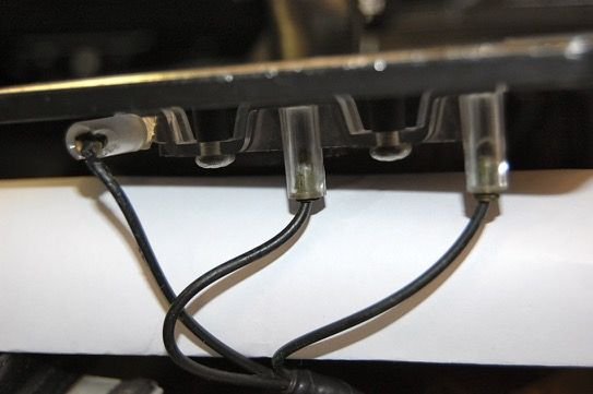

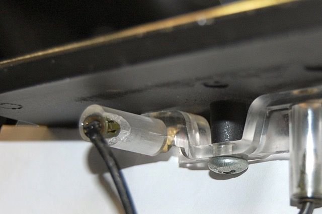

You can see that little barbed fitting and the split in the left side plastic tube on the lens.

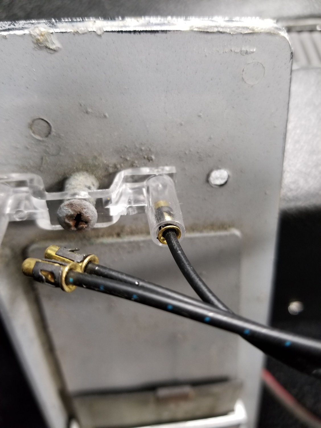

Do I just force this in?

Right now it bottoms out on the brass flange. The black metal fingers aren't grabbing.

Hi P,
Can you GENTLY try to open the fingers a little so they grab?
Otherwise, I'd use a little silicone around the flange area to secure the cable in place. Be careful you don't get any on the cut end of the cable.

Either the new lens diameter it too large or the flange is too small.
Anything that would create a tighter fit will work.
If prying out the flange tabs doesn't work I think I'd try first a short length of drinking straw in the lens hole or just a wrap of paper or teflon tape around the flange.

Another possibility would be to put 1 or more thicknesses of shrink-tubing on the brass collets, so that the fit into the lens strip is quite snug. Be careful with applying heat to that tubing. If you have a heat gun, you can better control the temps reaching those pieces so as to not damage the glass fiber cable (they are pretty tolerant of heat; just don't overdo it with match/candle/etc).
