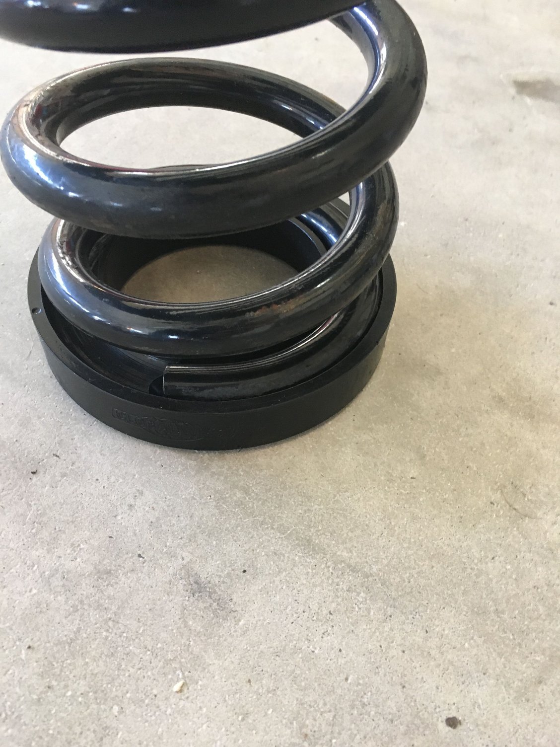

Like the title says, it is never just one thing..... So there one more "ah-ha" that I wanted to post as a follow up. If anyone reading this chooses to go with the Global West arms in a coil spring application, there is one thing to look out for. The control arms use a hard rubber or poly cushion to index the bottom of the spring.
If you buy the arms through a box store like Jegs or Summit, the cushion included will most likely be for stock spring. I run the 550-lb spring from Ecklers, which is just a bit larger in diameter than stock. Not much different but enough to cause fitment issues.
Pic below is how the 550-lb spring fits (or doesn't fit) into the cushion:

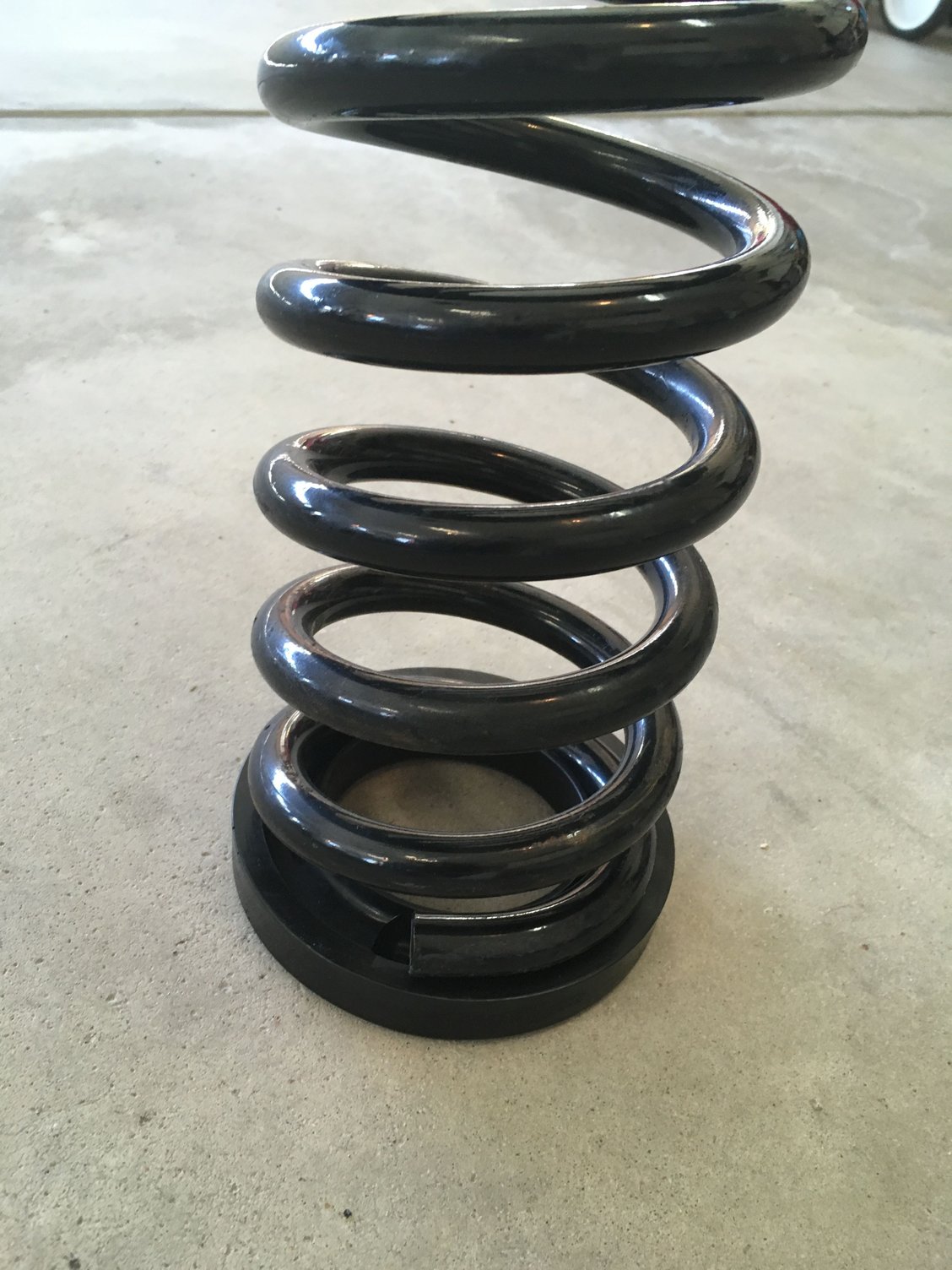

The part number for the default cushion is 4012. You will have to get with global west and order the cushion with part number 4013. Picture of how it fits below:
