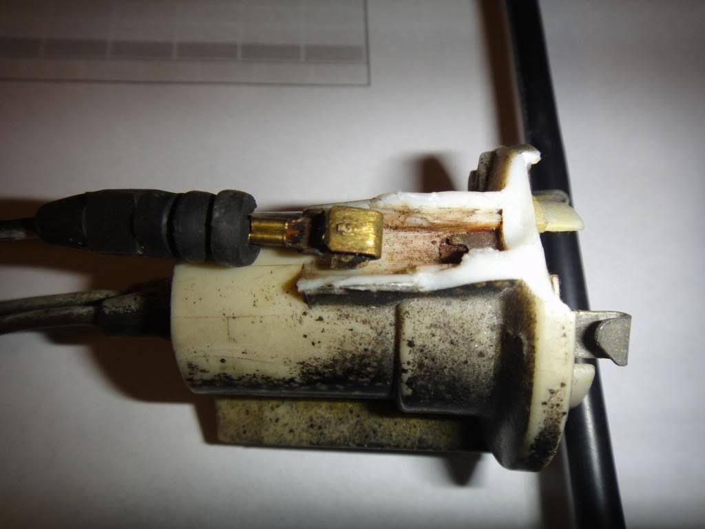

Old Apr 1, 2018 | 08:10 PM
'75's Avatar
'75
Joined: Dec 2007
Posts: 6,422
Likes: 591
From: McHenry Illinois
It may be a ground problem. those sockets have a ground connection that corrodes and rusts causing problems. To check the ground, just remove the socket with the bulb still installed and touch the brass edge of the bulb with a grounded wire to see if the bulb brightness changes.
Old Apr 1, 2018 | 08:17 PM
Peterbuilt's Avatar
Peterbuilt
Joined: Aug 2006
Posts: 7,426
Likes: 1,559
From: mount holly NC
As '75 said. here's a picture:

Old Apr 2, 2018 | 10:06 AM
lionelhutz's Avatar
lionelhutz
Joined: Apr 2007
Posts: 11,152
Likes: 890
From: South Western Ontario
It's the ground to the socket.
The light is grounding itself through the other bulb filament and then to the other bulbs that are connected to that wire. During the day, the brake and signal is duller because you're actually seeing the tail light filament instead of the proper turn/brake light filament.
During night, the light goes off because when power is applied to both the tail and turn/brake filaments there is no no path for power to flow through a filament and make it light. Every part of the bulb has 12V applied so it can't light.
If you find it's the socket and replace it, test it temporarily before making the wire connections permanent. It's become too common for parts store sockets to have wire colors that match the GM wires, but do a different function. In other words, if you match wire colors the tail light filament might be used for brake/turn and the brake/turn filament used for the tail light. It would at first seem to work OK except you can't see the brake/turn light with the headlights on.
Old Apr 14, 2018 | 10:52 PM
Dawgbroke's Avatar
Dawgbroke
Joined: Jun 2013
Posts: 30
From: Texas
Just want to thank all for this. It was the socket. Light was in correctly, but the ground was bad. Replaced the socket and all is good.
