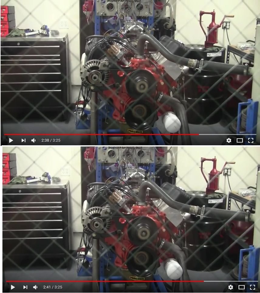

Originally Posted by lionelhutz
Can you post some links to confirmed examples of this exact set of events happening?
Now it is a Mopar....I would think it has a new hose on it...
Watch at 2:40
Watch at 2:40
LOL, sucking flat for a second then popping right back into shape while the rpm's continue to climb is disproving arguments that say more rpm causes more suction and more collapse.
