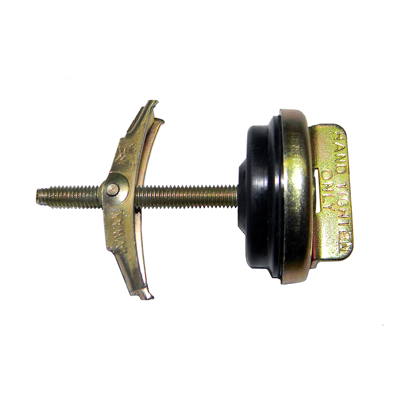

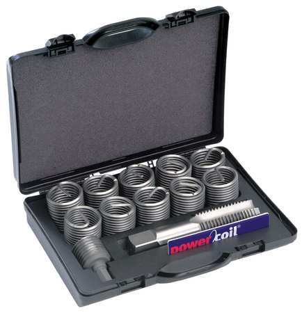

Here's a neat temporary fix- go to the autoparts store and look at the oil drain plug repair stuff-
You can use the temporary fix till you save up enough to buy the Helicoil kit- aint cheap-
Another thought was a -10AN O-ring fitting-7/8" - 14 But I don't think you'll have enough metal left....
https://www.zoro.com/zoro-select-hel...2k/i/G1550586/
https://www.threadtoolsupply.com/12-...epair-kit.html

HeliCoil makes Helicoil pipe thread repair inserts. Just get a pipe thread HeliCoil with the tap & tools and fix it right. No problem.

I just had to NPT helicoil my water temp sender in my head. Look on ebay for a partial kit, you can save alot of money but it still may cost you $75 to $150 if you can find one. I just pieced together a 1/2"-14 NPT kit and it added up fast. Is the plug 1/4"NPT? I think it is.
If you have a plumber friend or a machine shop , find out how much it would be for them to do the work. It may cost you only $50 or $75 for the machine shop.
The helicoil insert is easy to find, the STI tap is the expensive hard to find part, the insert tool isnt bad. the insert isnt like a normal helicoil insert as it is sprung out oversize and has to be coiled to insert versus the normal old school helicoil
