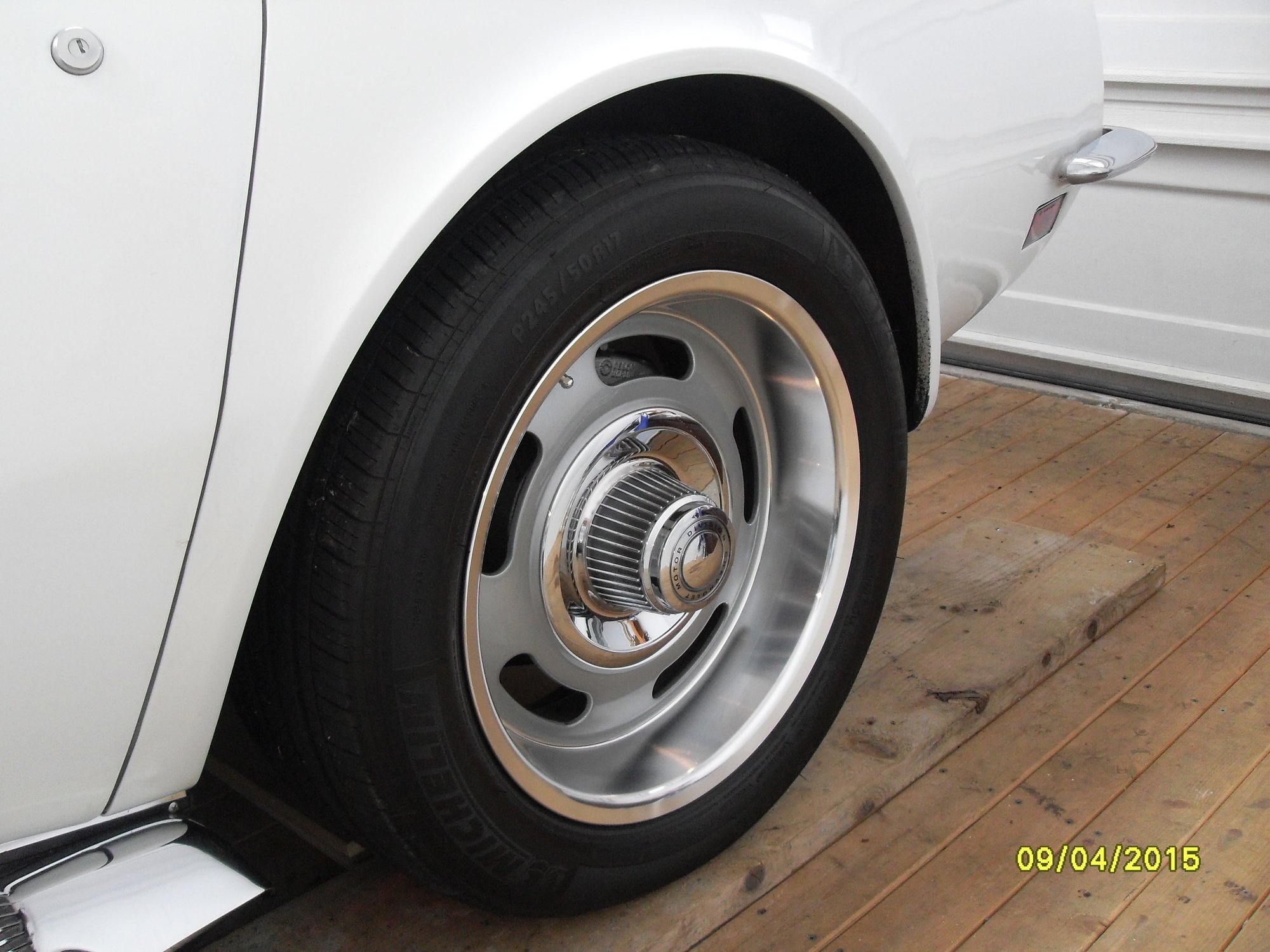

Michelin HX MXM4, 245/50/17, 26.7", Rated at 149 MPH, no rubs, no issues.
