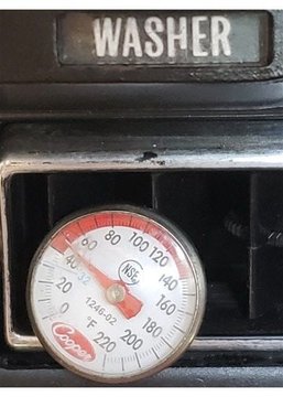

Hi Dave,
Glad to help. Running down the road, engine temp around 200, fan on Hi, center vent temps are about 48 degrees, which feels ice cold with the ambient temps of 110-112. Cabin is very comfortable. Over 115 and up to 120 the performance will drop off some but I think that is expected with just about any system here. If I take the car over to Los Angeles or the beach cities where the summer temps are in the upper 80's the performance is much better with lower engine temps and vent temps. I can easily run the fan on Low over there and have the same comfort level in the cabin. Our environments are completely different so I don't believe there will be any correlation between my performance here in the desert and your performance in Indianapolis where the summer temps are down in the 80's.
