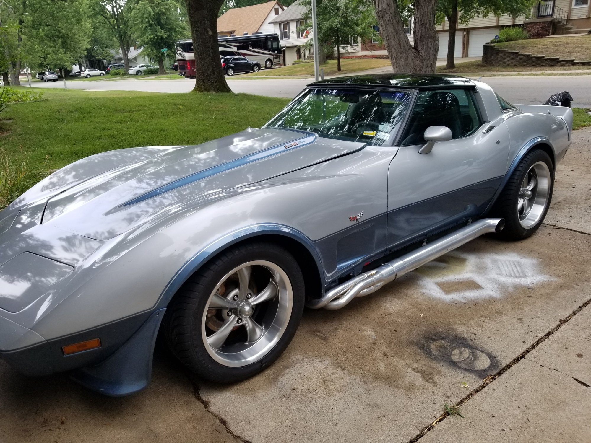

Got both trailing arms back in the car and re attached my shocks, rear spring, half shafts, etc... eyeballed the alignment to make sure it was at least in the ball park so I could run the car around the block (it hasn't run in a month or two since that wheel bearing went). Car drove great! Got back and used the string method to check my alignment and found that my thrust angle is off by a bit, and I am toed out about 1/16" (yikes!). Didn't have much time to play with it last night, but I got all the old shims out and checked their thickness with a digital caliper and matched up the new stainless shims as a base line. Then I took an educated guess and moved about .15" of shims from the inside of the passenger rear tire to the outside (according to my thrust angle measurements, the passenger tire was pointing "out" a bit more than the drivers). Put the wheels back on and dropped the car to the ground, but didn't have time to take it around the block and remeasure. I'll do that tonight!
But it felt good to have it back down on it's own 4 wheels so I could roll it out and wash the dust off of it (my wife has been doing some carpentry projects in the garage so the vette looked like it had been stored for a couple years because of the layer of dust!)
To Bad wheel bearing?
