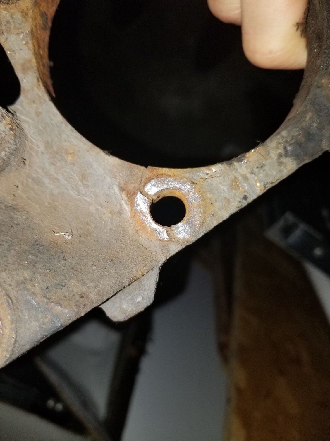

Sorry not a great pic, but this crack appears to go all the way through. Think I'm ok to just weld it up and then grind it flat?

That is a caliper bracket. While I have repaired stripped threads in these with a strong long lasting repair I wouldn't weld and use a cracked one. They are readily available in the aftermarket today and the ones I have used are pretty good.

It could be welded, but not with a MIG. The proper cleaning, prepping the crack and temperature controlling of the part is necessary and a TIG would be used to actually weld it.
In other words, it's easier to just replace it.

Cool, thanks for the info. I'll search around and try to find a cheap one.
