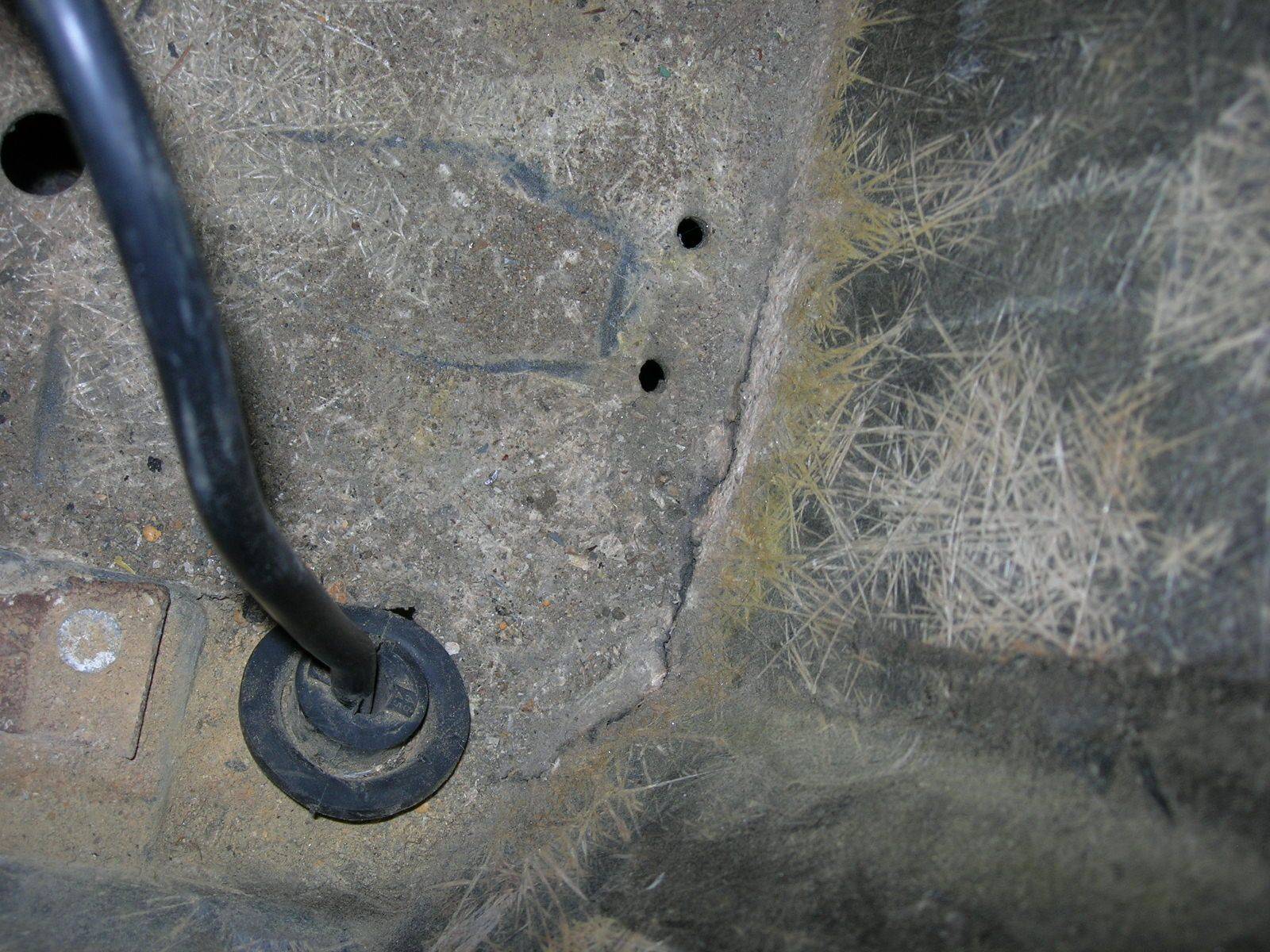

Hello!
Today I removed for the first time the battery on my C3 -74 and noticed that the glassfiber battery box has got a about 4 inch long crack on the right side...the box is besides to that in good shape. Should that crack be fixed ASP or can it wait?
Is the the intire box made of glassfiber or does it also have got a metalframe?

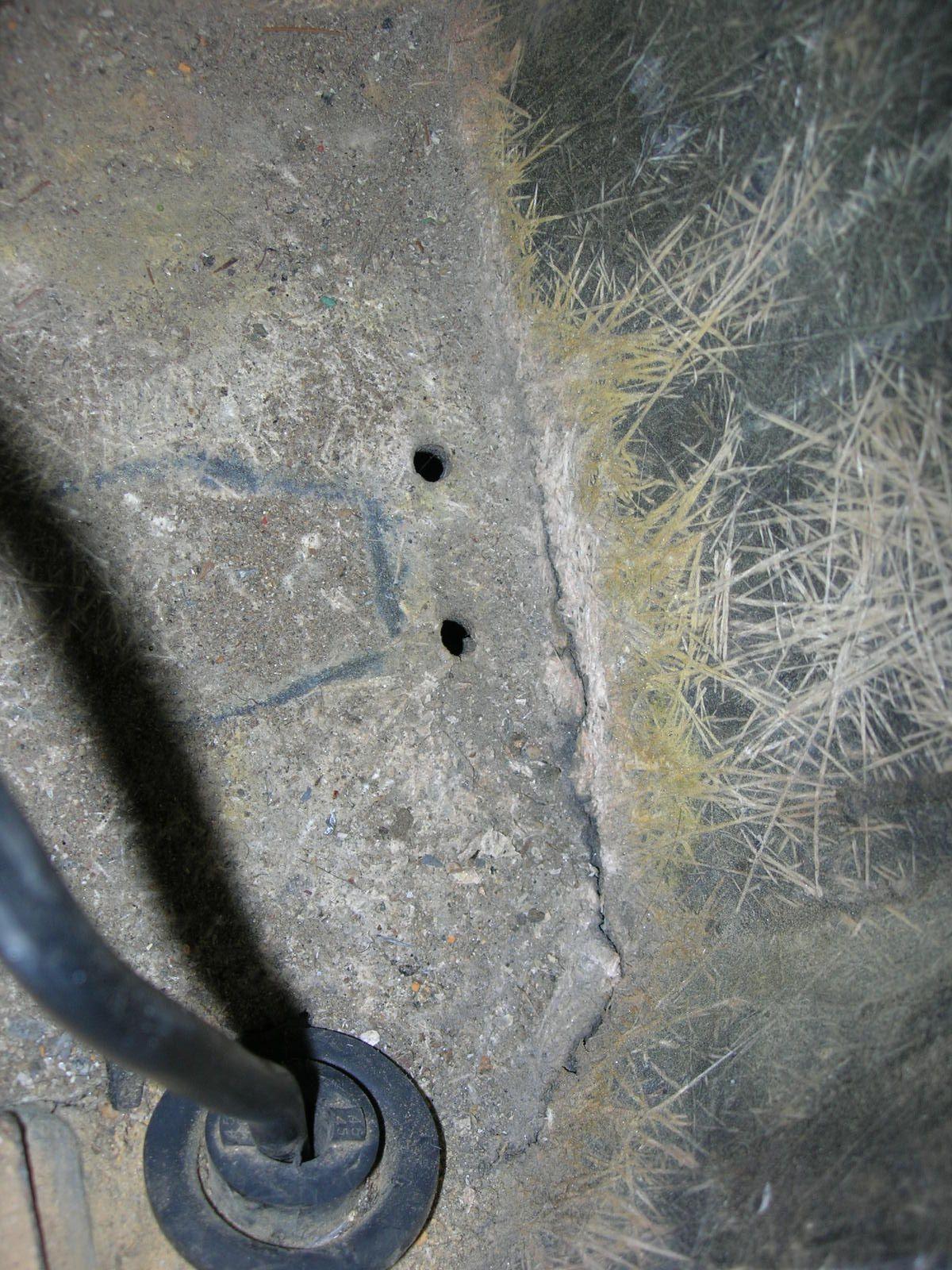

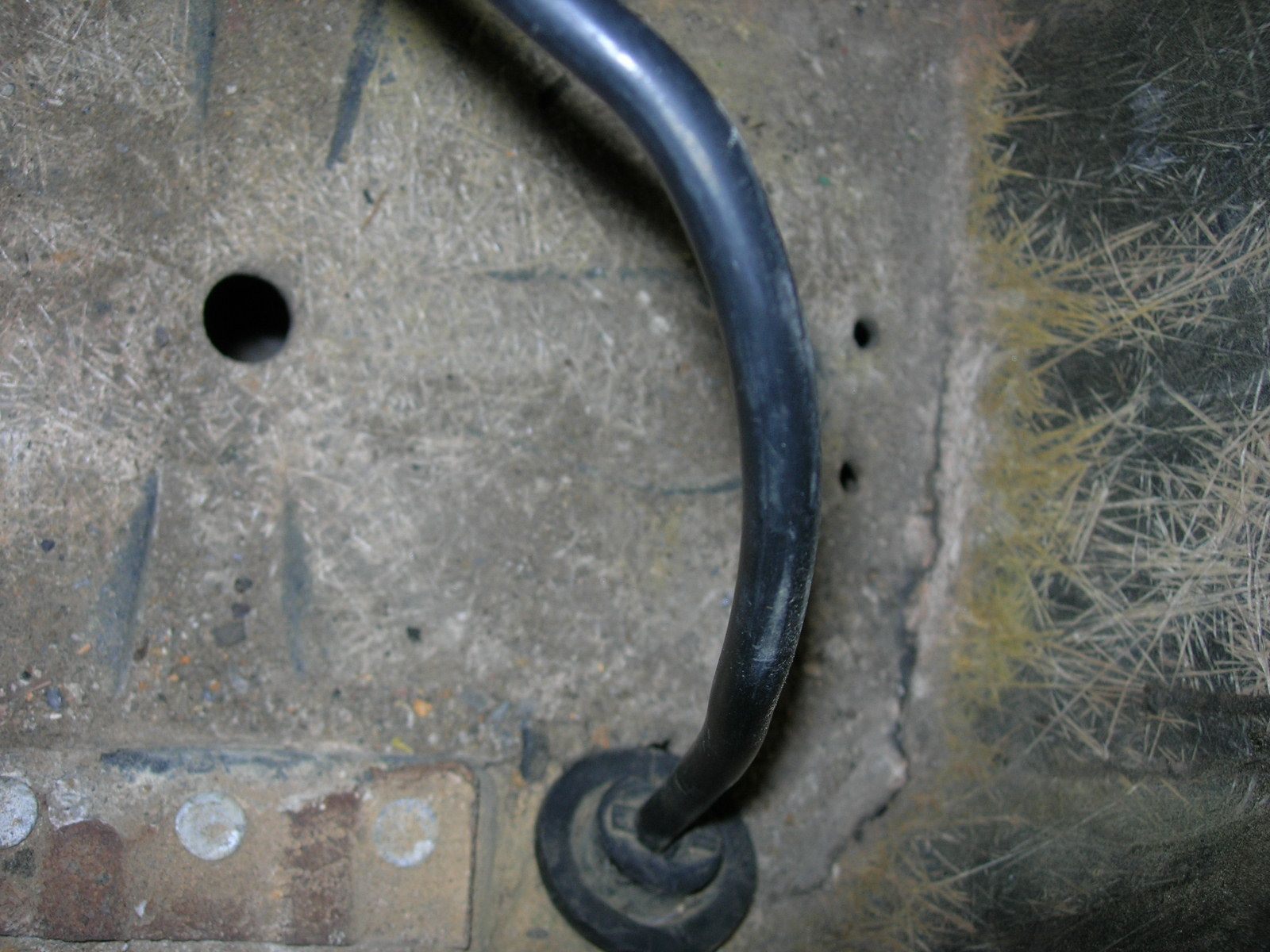

Here are some photos of the crack.
When I push down close to the crack "the floor" moves a bit down and the crack gets larger...

Thanks for the GREAT PHOTOS!!!
This repair should be really no problem.. Seeing how the one battery cable is really close to where the crack ends. I would suggest getting out of the way so you grinder does not damage it.....because....all of the repair can be done on the inside.
You can clean of the underside where the crack is so your masking tape can seal up the crack so nothing you apply will drip though the crack. You will apply the tape AFTER you have prepped it on the inside first. Just get this area clean prior opt grinding. You may have to wipe off some dust after you have prepped it but at least you are not trying to get off stuff that will cause the tape not to stick.
Starting at the crack itself you can put your grinding discs outer edge in the crack and at a rather moderate to slow RPM ...slowly grind down and pull away form the crack like I said... about an inch or a bit more. Do this on both sides of the crack.
The idea her is to taper out the crack..SO IF you make the crack open just a little bit...such a millimeter or so. DO NOT worry. Because you can fill that back in. Bur what you are trying to do is to get down the bottom of the crack and leave a very thin amount of fiberglass...if possible. If you can't...don't worry about it. This is why I wrote to use grinder at a slow RPM so it does not get away from you adn you cut away too much body material and you do not have it create much wider gap.
The whole reason on trying to keep the crack from not widening too much is so form the outside...if you are worried about it.. The repair does not show that much and you can lightly apply some black paint of undercoating and the repair will not be easily detected if at a ..
When this has been completed. You can clean of the underside so your masking tape can seal up the crack so nothing you apply will drip though the crack.
You can use fire glass resin adn mat. (either epoxy or polyester are fine) Or you can use some of the two part adhesive that the guys who repair cars in Finland use in conjunction with some mesh or fiberglass and lay it in the area you prepped. AS long as it is designed to be applied on fiberglass. You can prep it out further if you choose to do so. But an inch or so should be ore than sufficient. No need for 3-4 inches. And the 'mesh' I was referring to is the type of mesh that can be used when doing sheetrock work. It is a plastic mesh looking much like a screen for window but larger squares in it. It will provides EXCELELNT strength has long as it is covered in the two adhesive you use adn use a few layers of it on top of one another. This make type of mesh is used when I repair urethane bumper covers and it is NO JOKE...it works.
SO if you choose to use the mesh...cut one section of it about one inch wide and the length you need and cover the crack....then the next layer of mesh can be 1-1/2" wide..then the next can be 2 inches wide. . Like I wrote..it all depends on how you want it to look when you are done.
So..it will depend on how good looking you want it when you are done to how well you apply any of these products.
Knowing that it is in the corner...you can apply quite a bit in this corner to further strengthen it....and YES...if you want to cover those two small holes near the crack. You can do so due to they were there for the vent hoses form the factory batteries back when the car was made.
DUB
