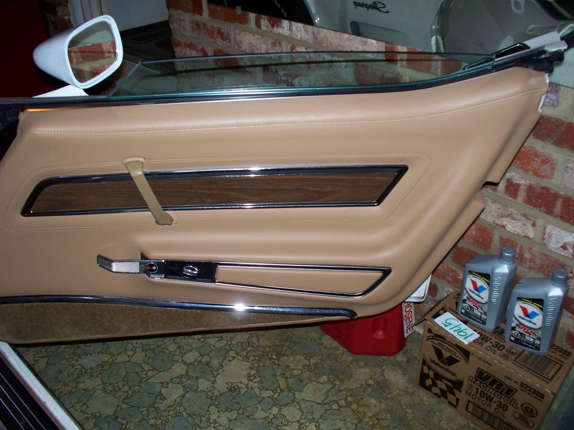

Here's my door without the front and rear top screws.

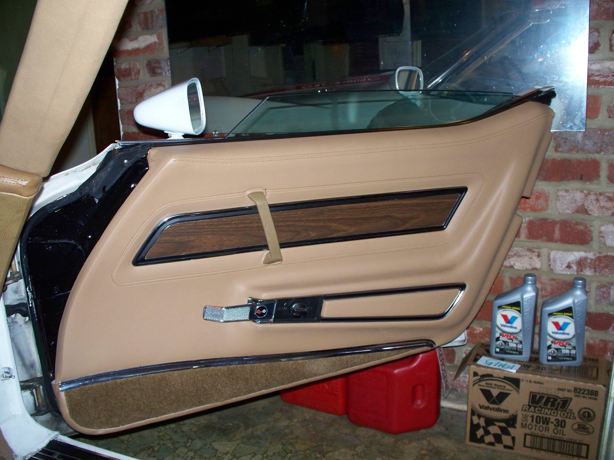

Did one side trim but needed to order the clips that hold the bottom so also ordered new pull handles .
Old Jul 4, 2018 | 01:22 PM
upnorth's Avatar
upnorth
Joined: Jul 2009
Posts: 350
Likes: 7
From: springstead wi
All done took about 2 hours total .Only extra thing I had to do was drill and tap the bottom holes on the pull handles . Top one was dead on but bottom when I centered the handle in the hole was off which was good because my old ones were striped .
