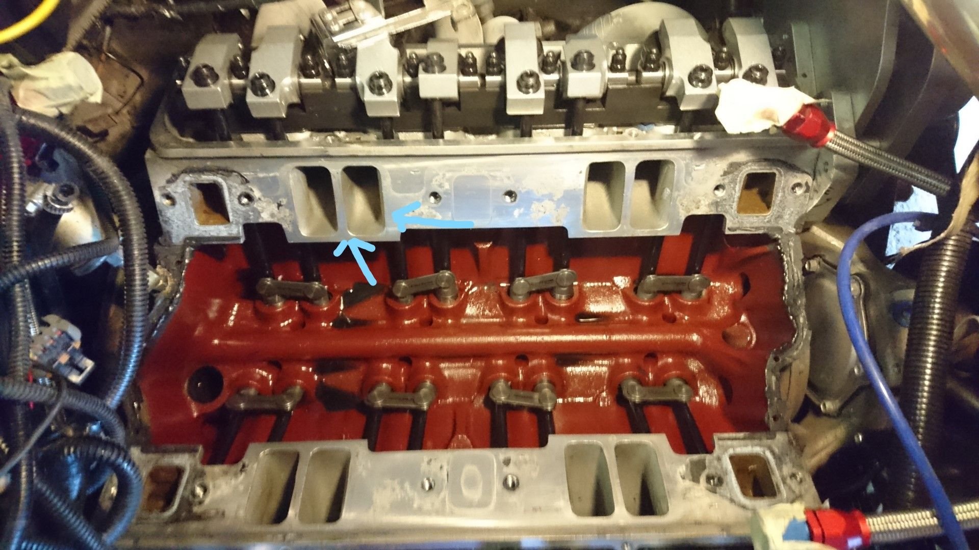

ive now got the intake off, all the velve train, rods look good, tomorrow i will remove head, the pistons have a thick oil crust over them, caused my engine eating alot oil in last month, blue arrows show where there was oil inbetween intake gasket, so pistons will need a clean job on them
and as suggested i will remove oil pan etc and check caps etc on rods

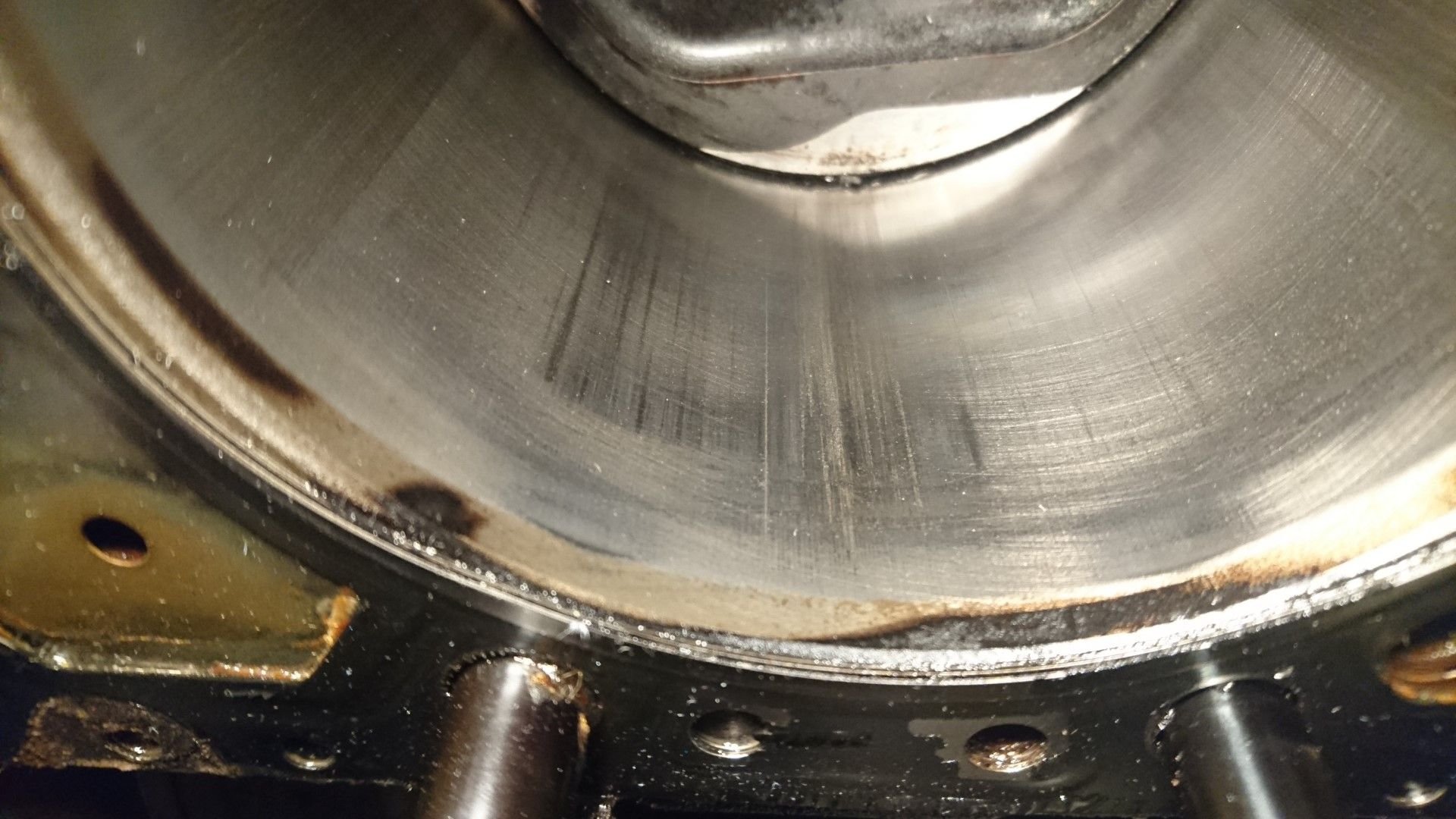

Found my problem - Damaged gudgeon pin/top rod bearing, you can push piston down by 4 mm approx and move the piston clockwise/anti clockwise by 3 mm , fun times! and also scores on cylinder which your finger nail catches on

I listened to your video and thought about wrist pin, but it is a very uncommon failure with modern bushed rods and forged pistons with spiral lock floating pins
all the moving parts need assembly lube or oils for initial start up I've done some motors that put oil repellant coatings on the underside of the pistons. That keeps the piston assembly lighter and the wrist pin bathed in oil

Cheers guys interms of the scores, does that cylinder need a rebore i take it or can be honed out ? and if it needs rebore, are you meant to rebore all cylinders?
