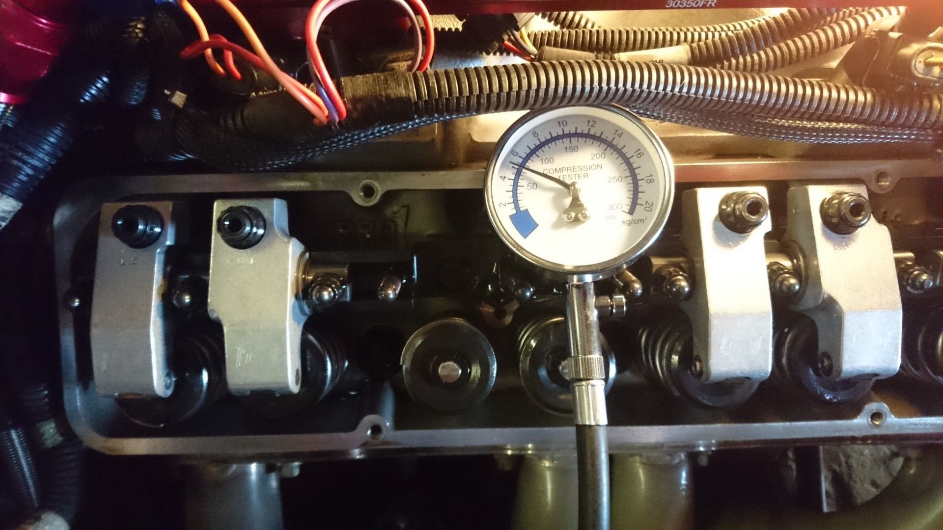

Update - so i removed the shaft rocker from low compression cylinder, with the rocker on, it produces 120 psi, all others are 140+, with the rocker rermoved, ie valves fully closed when turning engine over, it only managed to produce about 70 psi and then after another few trys at turning over engine, ended up down at 10 psi, so what does that mean?? bent valve or ?? - there is alot of oily burnt crusts on the pistons, which is more than likely on the valves aswell, seen on my boroscope today

Maybe it's just the picture, but it looks like the valve stem has started mushrooming?. Maybe the rocker was pounding on the valve due to being too loose?
Also the sweep pattern looks quite wide?
i will have a closer look at that, thanks
