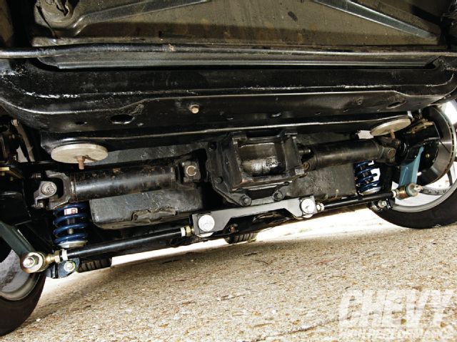

For contrast: https://www.corvetteforum.com/forums...s-in-a-c3.html
Originally Posted by Kid Vette
Installed on RideTech's 48 Hour Vette.
Originally Posted by Metalhead140
Looks like a great setup! I find it curious that in the installed pic you have the strut rods in the highest holes for what appears to be a lot of camber gain? Yet most people lower those pivot points to reduce camber gain?
Originally Posted by Smitty@ridetech
This car is a track car so we want the camber gain. I also effects roll angle height.
I think it's fair to say that it depends on the car, driver, and usage!
