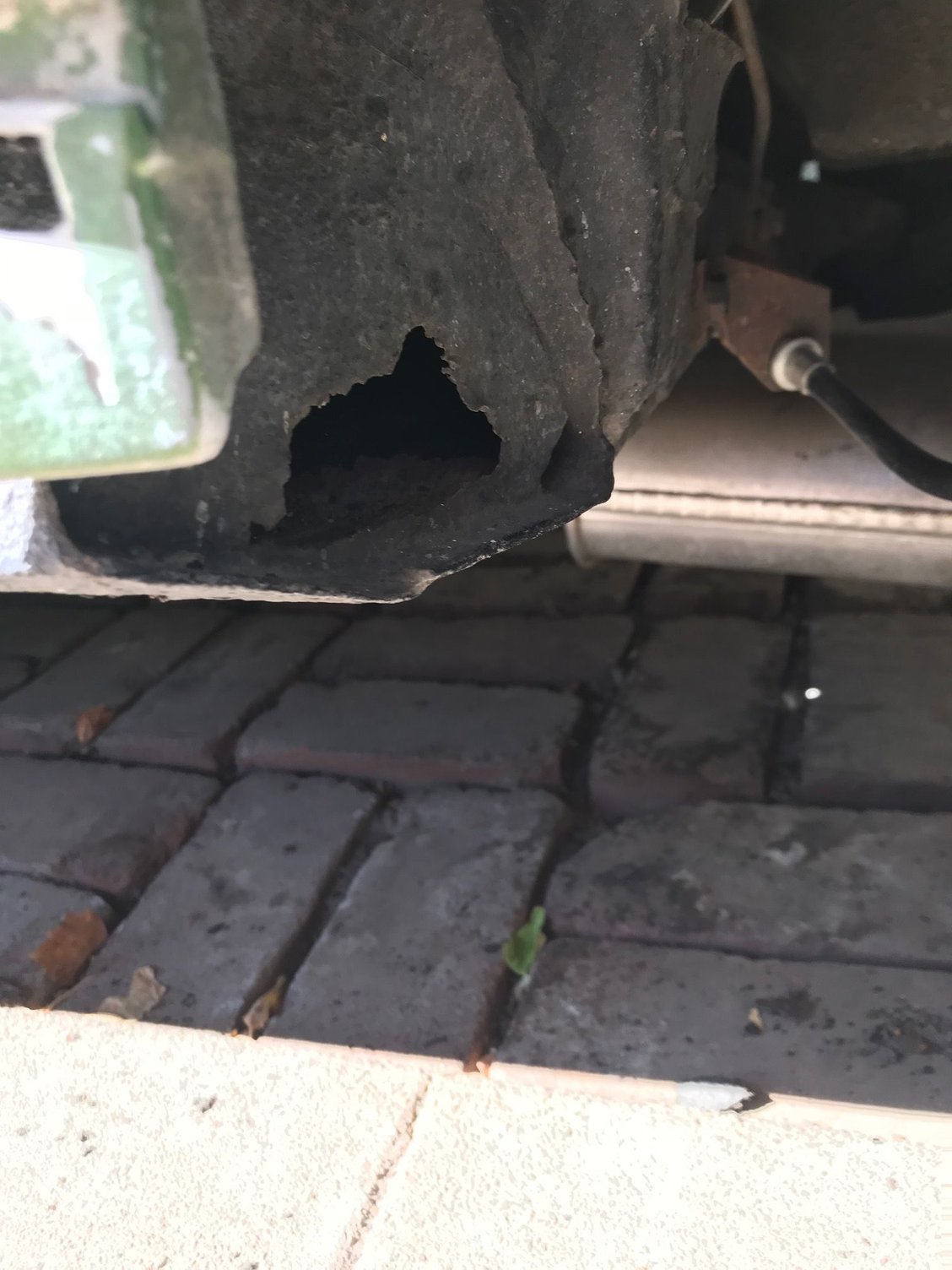

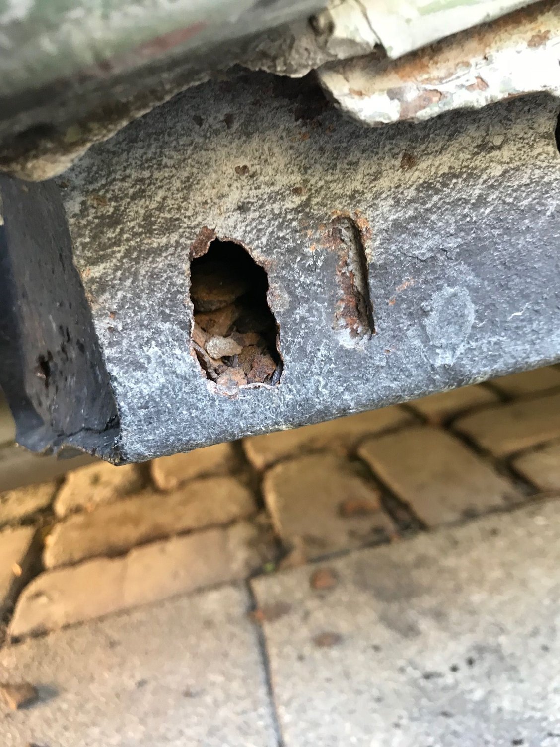

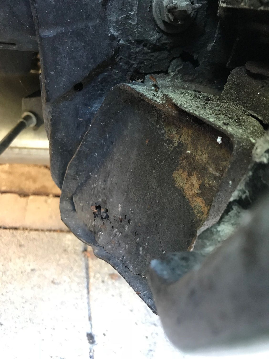

Hello everyone,
I am currently amidst the process of restoring my '73. I plan on removing the body from the chassis in order to undercoat the body and do some fiberglass repair where needed. Upon eyeball inspection of my frame, I have noticed some areas where corrosion and rot have become worrying about my future plan for the car. I'm asking for some advice from you guys that may have had this same issue. I am worried about the overall integrity of the frame, especially since I eventually want to have an engine with more HP, about 375-450 HP. Current engine is a '71 SBC 350 that has 8.5:1, don't have a quantitative value about current HP rating, attached to a TH400. The suspension is all stock except for the shock absorbers. I'm never going to track or race the car, going to be a daily driver/cruiser on mountain roads.
I have looked at whats available for chassis replacements and aware of Streetshop INC., Roadstershop, SRII etc.. The price for a complete replacement outfitted with suspension and brakes is relatively the same across these providers. Has anyone replaced or modified their chassis, if so, then to what and what are you currently running?

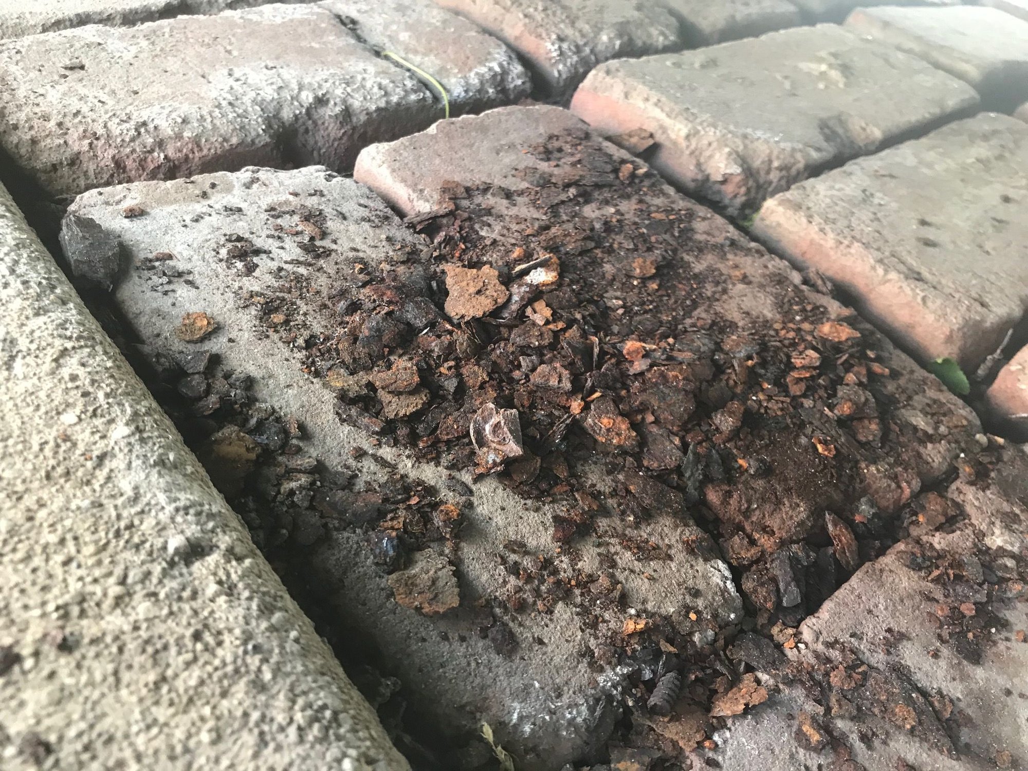

Btw, that pile of rust. I tapped the frame with a hammer and that came out!

Welcome to the hell
It looks like mine a little maybe a little worse mine dont have that big holes.
I am going to weld mine up but was thinking of a new frame but the price scared me off.
Just be really aware what you expect from your car and then try calculate how much you wanna spend in money and time
and then take it times 2 and hope it will work.
In the long run you will probably feel proud when you drive it again.
Good luck anyway.

that is some serious corrosion, I would suggest a converter to seal the rust before you do anything else, soak everything in sealer and allow to dry then do it again.
something like this
https://www.homedepot.com/p/Corrosea...2320/202960538

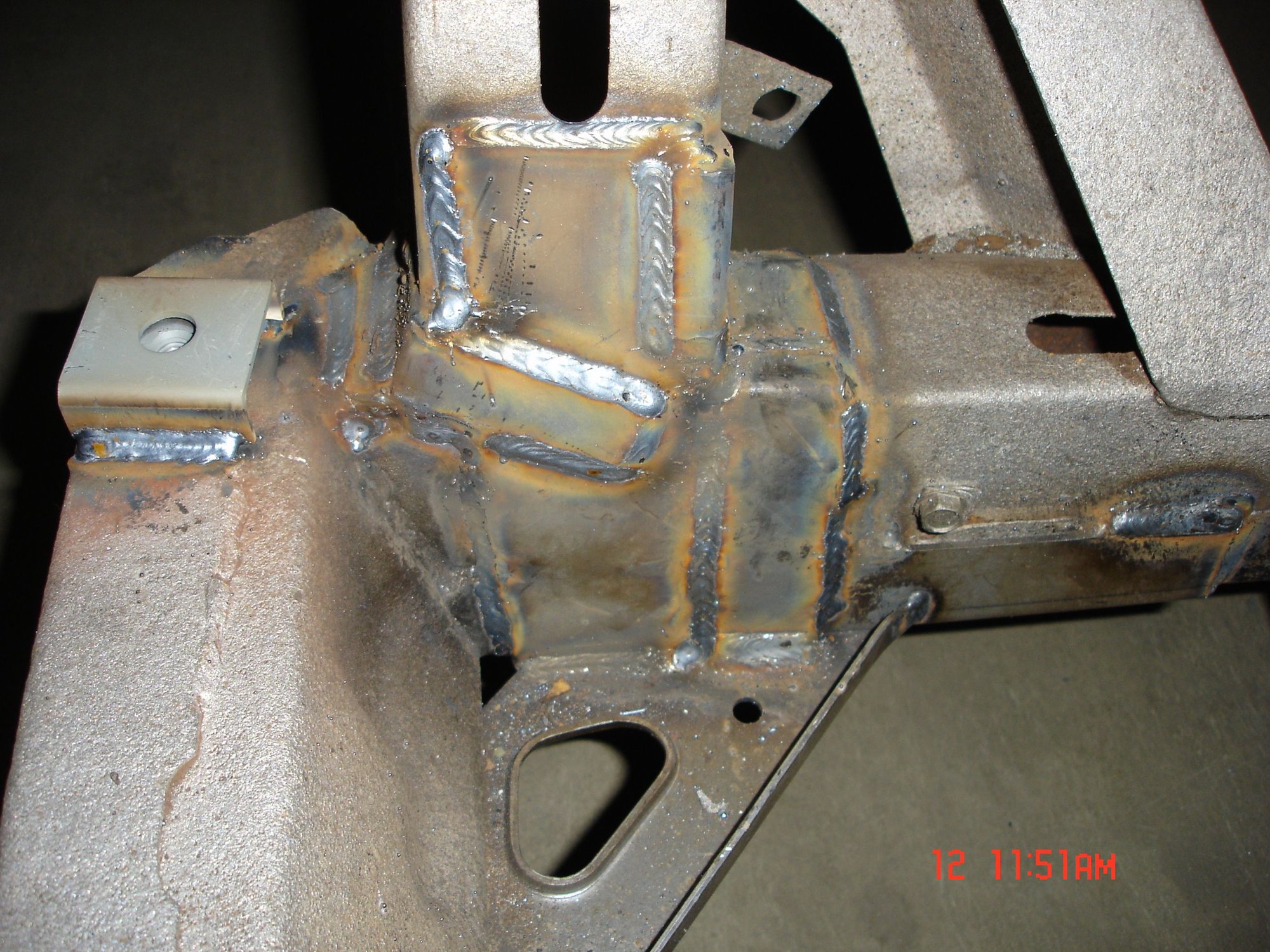

I had a few of the same problems on my 69 frame when I first started. I went the route of repairing it. After market parts as usual had to be modified but eventually they all were installed. Some areas I beefed up.

I am very impressed by your work and guess I have also have to do something like this in the end but all will come clear when the body is off.

nice pics! that restoration must have been intensely labor involved, details like sand blasted frames are what truly says labor of love!

Dang!!! That's some fine work you do.
