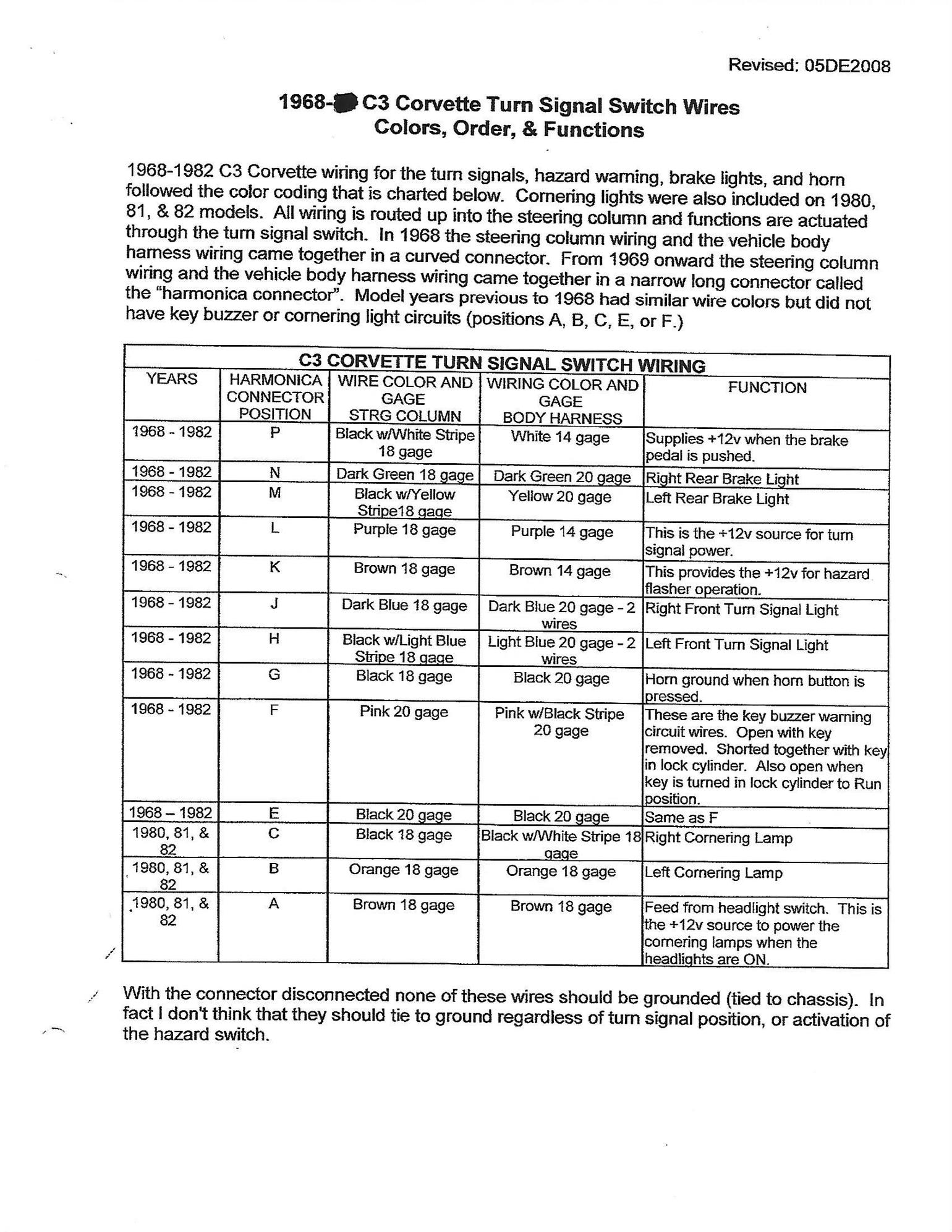

With the key ON and the directional set for a left turn probe the blue wire just in front of the socket for 12 volts.
If you have power there then the bulb socket is bad and must be replaced.

Let's go back to the harmonica connection.
With the two parts separated and the key ON and the left turn lever engaged see if you have 12 volts at 'H' (black w light blue stripe) on the half that goes UP into the column.
If you have 12 volts there jumper 12 volts to the bottom half and see if the turn signal bulb lights up.
Old Aug 14, 2018 | 04:10 PM
Peterbuilt's Avatar
Peterbuilt
Joined: Aug 2006
Posts: 7,426
Likes: 1,559
From: mount holly NC
Never mind!
That won't work with the harmonica connection disconnected unless you supply 12 volts to 'L'.
Can you probe 'H' from the top with it connected?
If good at the top half probe the bottom half and hope for 12 volts there.
