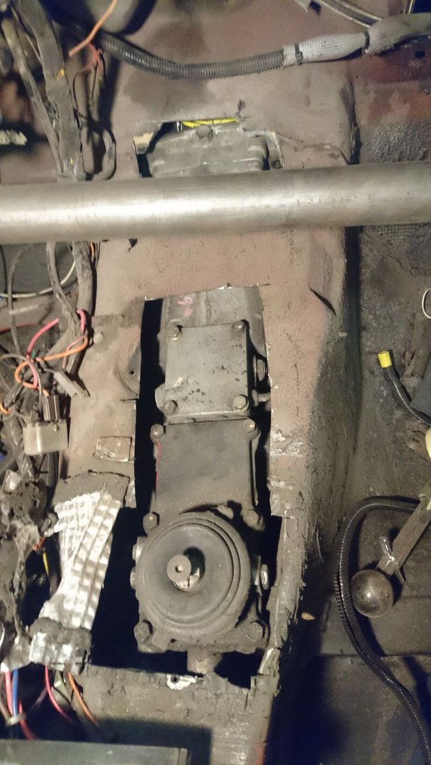

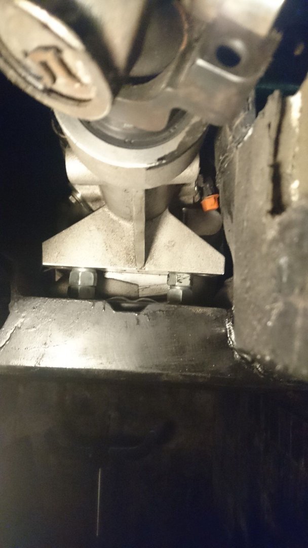

Update - so to achieve the 2 degree engine/trans angle, needs alittle work, had to cut the trans tunnel open and space the T56 up by about 1 inch, need to make a proper alloy spacer, the nuts did the job tonight, the diff just needs a new bush to push it down alittle to get my W u joint orientation - so some good info there for LS/T56 swap

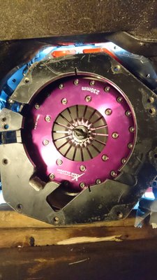

pic of new twin plate clutch, bit of clutch **** lol - can handle 1350 lb/ft of torque
