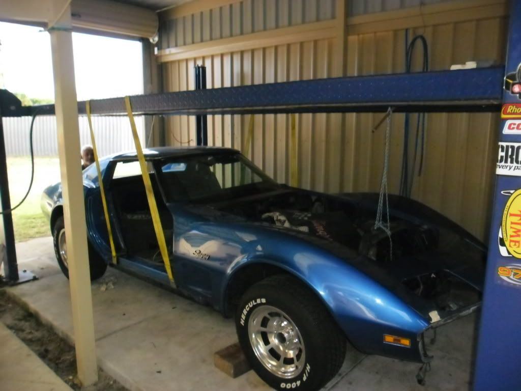

Ah , yes ok . I have seen it done with the strap to the windscreen surround , but to me it looks to be a too sharp of an angle to really actually support the weight,
this is what I did to my 77 when I completely lifted it off,
Notice the high tech dowel for rope tension adjustment !
If you have your frame immobilised so it cant move ,you could just put some wood chocks under it to steady it ,ideally someone to hold the clip and steady it while your using the jack so it doesn't get out of shape

What we do here....Remove the body mounts on the passenger side, the front/rear bumper braces and then remove the rocker panel.
We have a lifting strap with U brackets made on the ends. We then hook it where the rocker panel was removed and it goes at the furthest point on the back door and the front most in the front of the door opening. (The same place as shown in Bazza77's picture... right where those yellow straps are) \
We have a hoist in the ceiling of the building and attach the strap to it, you'll need lift it until you can get the Z bent area of the line in place. We only lift the passenger side if we are not pulling the body too... And I just spoke to Kevin in my shop and he said you can use a good old cherry picker to do the same thing. You only need to lift the passenger side even if you are doing the brake lines, you can replace brake lines without taking the body off.
You'll also want to make notes of how many shims were in what location if you attempt to do it this way. Shimming a body without knowing can be a royal pita.....
