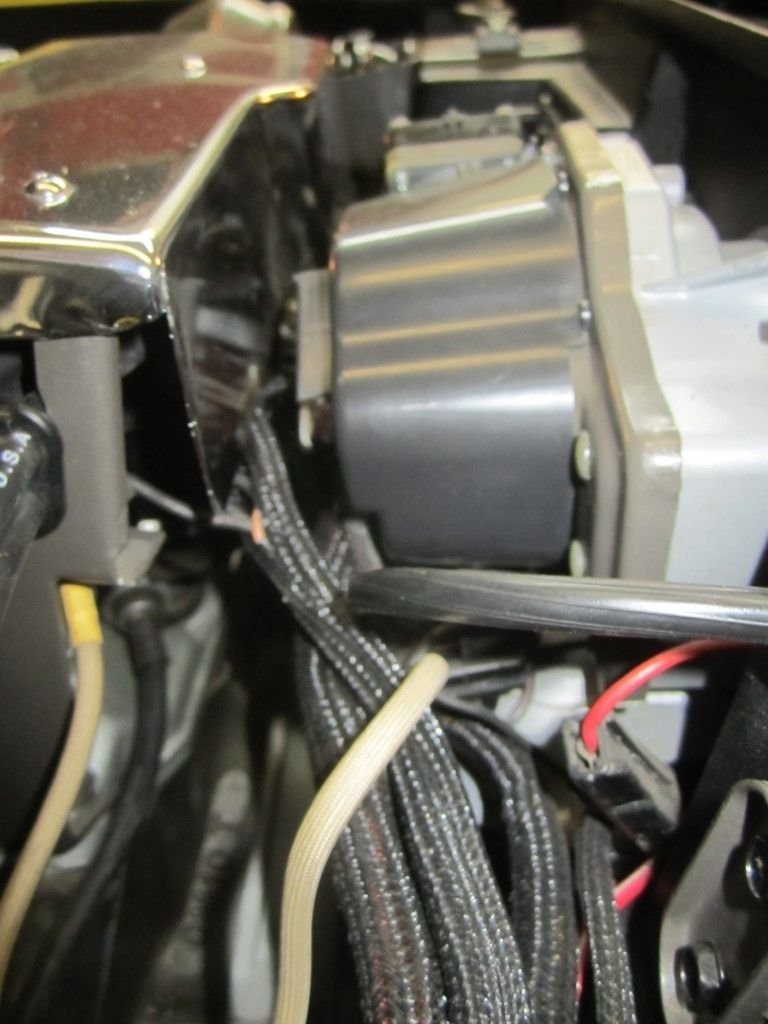

It'll be damn tight with an HEI (I'm converting mine over now but I've also removed that pump and replaced with electric to free up room)
The mechanical pump is bulky and the connectors coming off the front barely clear the chrome shield which barely cleared the points distributor
Not saying the pump and HEI can't be there together but it's got to be tight. I'll know in a week or so....

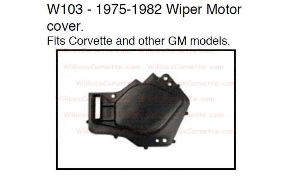

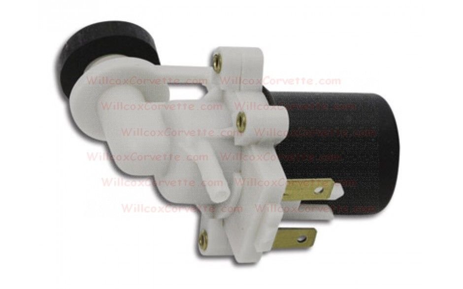

This is the pump:
And one of these:
Just extend the wires from the old mechanical pump then drill a 5/8 inch hole (threaded part of the pump is 1/2, a 5/8 hole works perfectly) in the bottom of your reservoir, just make sure the pump will not hit anything when mounted, and mount the pump on the bottom securing it with the filter nut. The pump has a thick rubber seal as does the filter nut. I used spade connectors at the pump but you could probably find the right type of connector and make it look stock.
This is the cover which may or may not need a little modification. The one I got fit perfectly on my wiper motor. Just remove the mechanical pump and install this with the old pump screws.
