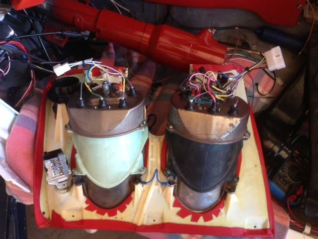

Hi Greg,
Great tip for the lampholders - thanks!
One thing I did was to install connectors so I could remove the dash without removing the instrument lamps or unplugging gauges.
I got this tip from the forum many years ago.
Se my pic. (I also did the same for the center gauges.)
Cheers,
Joe
I like the connector approach so you can disconnect the entire cluster with a single connector. It's a more modern approach than the way they originally done it - though it goes back to the late 70s if not earlier (at least on Japanese cars). I'm a bit surprised that GM wasn't using this approach by say 1978-ish when they changed up the gauge design (actually I've never been inside the dash of a late 70s C3). It would have added a little cost. But it would have saved significant labor savings on the assembly line - thus paying back on that investment. (and clusters could then be pre-wired and tested with test rigs at the OEM - thus improving quality and potential re-work or warrant claims as well.
In fact I still am amazed as to how these early C3s dashes were ever assembled/installed in the cars with any degree of efficiency at St. Louis. Those workers must have had a lot of dexterity! (and probably should have been given a bonus if they weren't holding up the line!)
