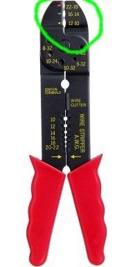

Gauge cluster back out (again) 😂
I've got my 6 gray wires ready for butts (with heat shrink wrap) but when I crimp them on, they fall right off. These butts are labeled as 22-16 AWG. Do you happen to know what gauge these gray wires are? My guess must have been wrong!

Hmmm? Those should work. I used a typical red butt connector:
It looks like you've got it under control, wires are nice and accessible. Are you using a good quality crimper and not one of these, "guaranteed to fail" types:
I am in SoCal. Palm Springs to be exact and I'm usually happy to help a Corvette brother out. Unfortunately my garage is currently plugged with a C2 and a C3 that are both behind schedule.
Wow you have 2 cars you're working on. Nice!!!
I am with you, I can't use cheap tools.
I think I'm covered with these!
