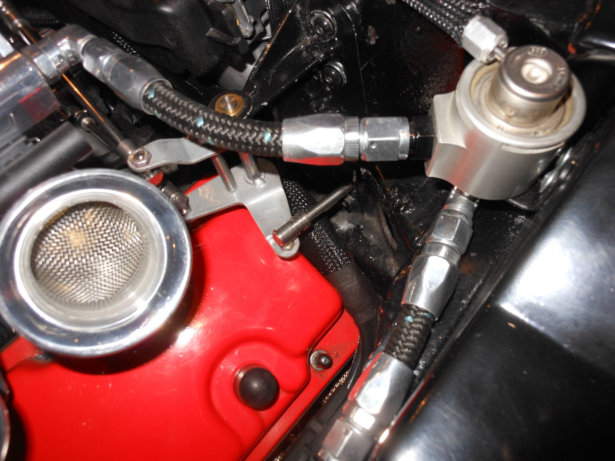

Here's the fuel rails with the return- and running a billet fuel pressure regulator with Bosch internals
