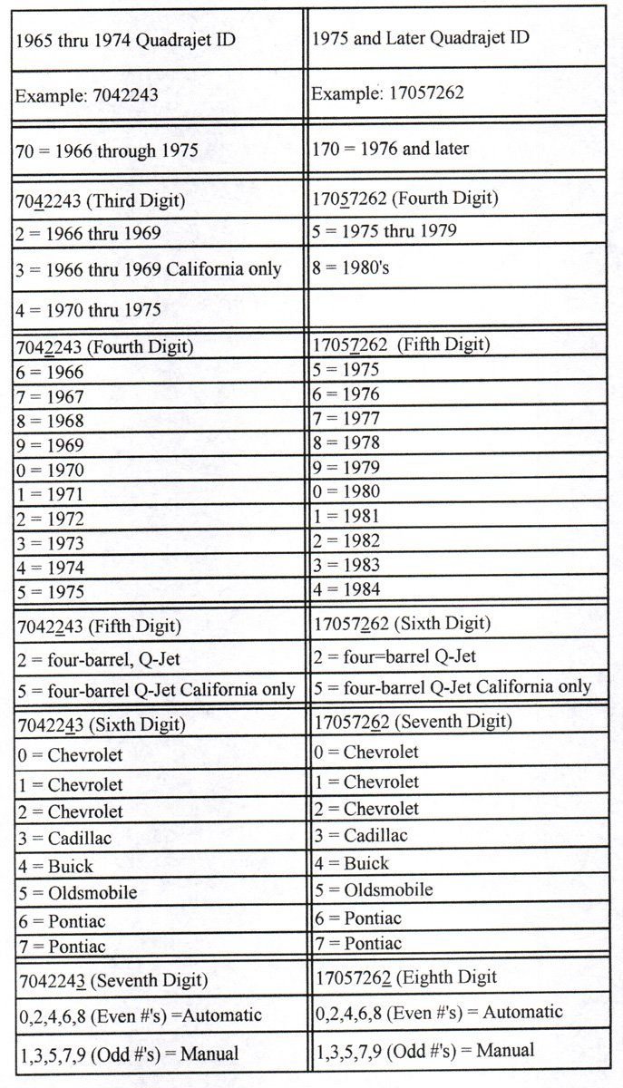

Is the carburetor you have the correct/original one for your '78? If you don't know, there is a number stamped into the housing that identifies what it originally came on.
Good luck... GUSTO
