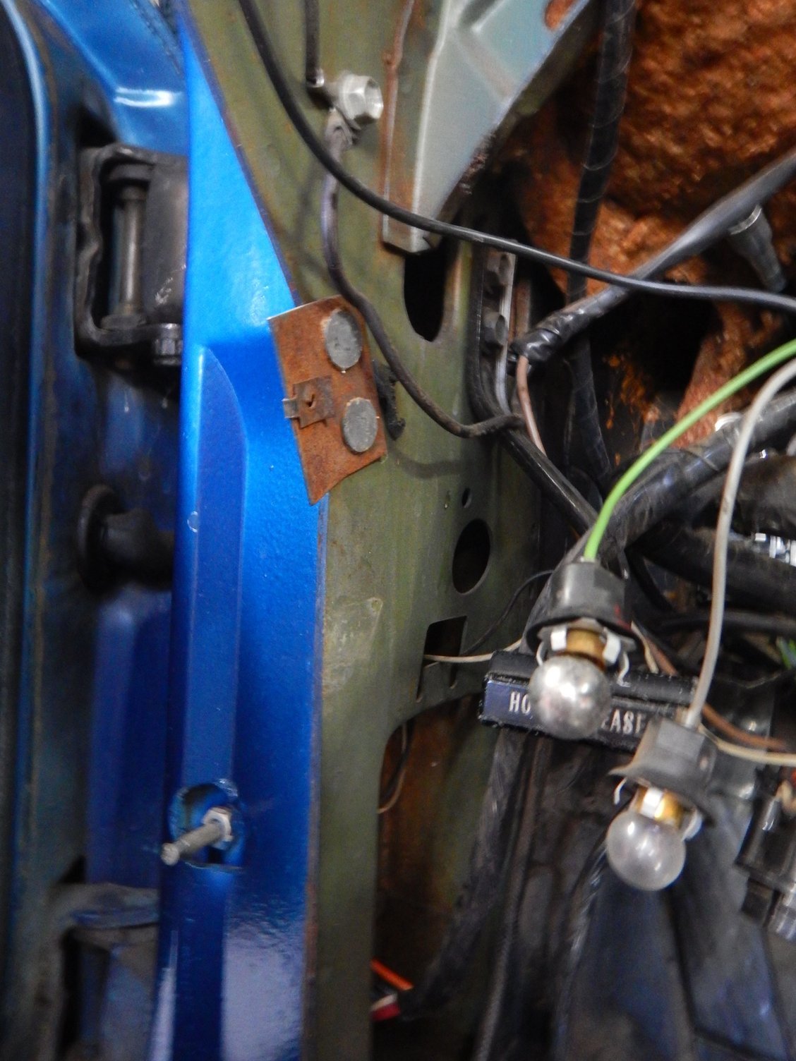

Look out for this tab with 2 rivets "WRAP IT/TAPE IT WITH CARDBOARD OR FOAM" It will cut you like a knife !
On the back of each is a spring clipper the cable connection "press in to release" Remember to photograph every thing you remove/steps. Mark/tag all wiring.

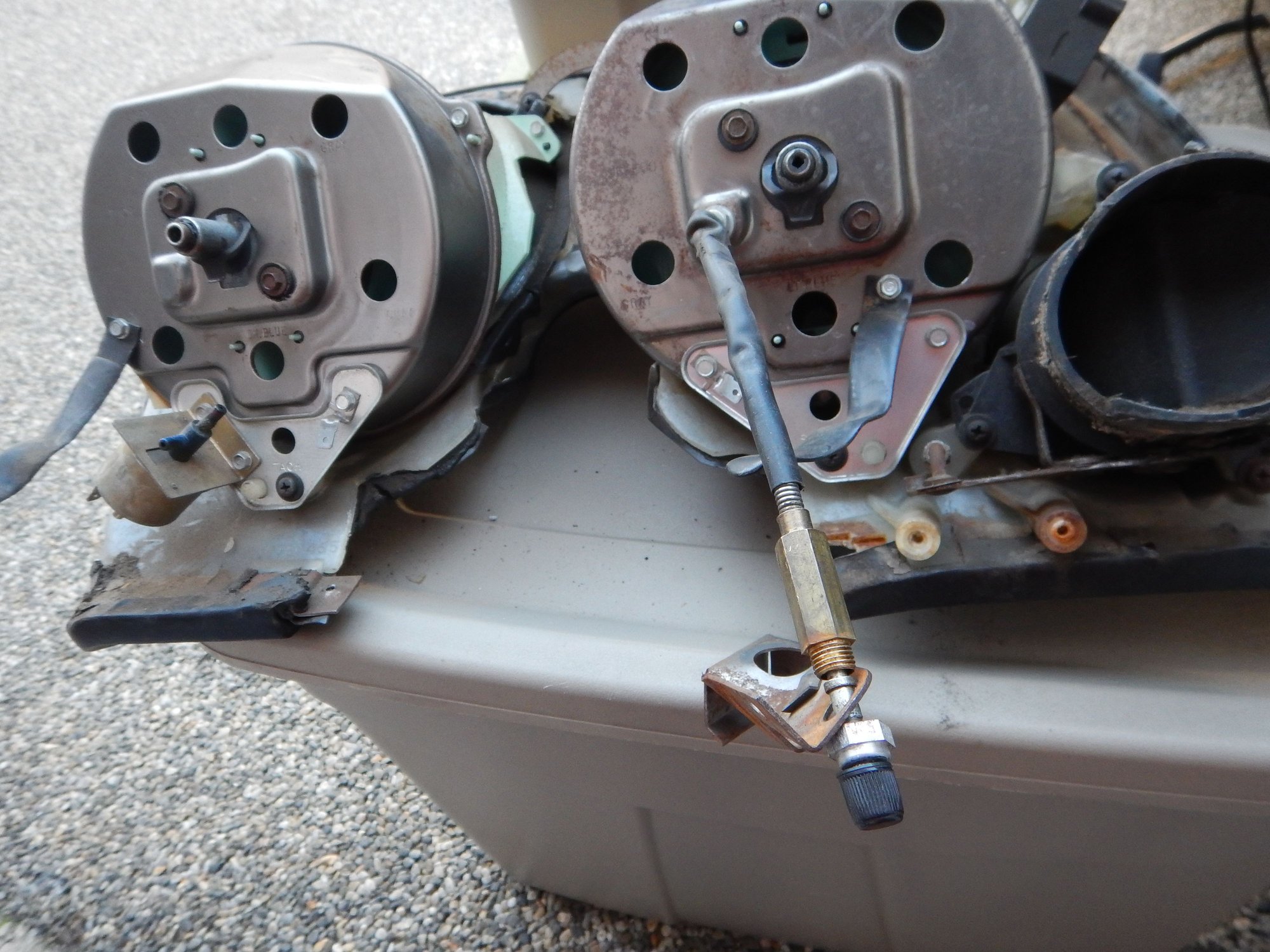

Hello. Thank you for the information. I disconnected both Speedo & Tach Cables. I also saw that the thick wiring harness was clipped behind each Tach & Speedo. I removed vacuum hoses that were connected to the lights.
Is there anything else that will prevent it from sliding forward & out? I think I have to remove the odometer reset cable as it is blocking some wires.

John- several other forum members gave you some good info. You will find that working behind the dash is a miserable job. I had mine out to replace all of the gauges and to install a new wiring harness. I hope I never have to do it again. Take photos and make a lot of notes and label wires and tubing if you remove them. Also note where the thick bundle of wires in the harness goes- above or below the speedo cable and tach cable. If you get that wrong, the dash panel will not go back far enough to fasten the screws that hold it in place. You will probably learn some new swear words by the time you are done.
