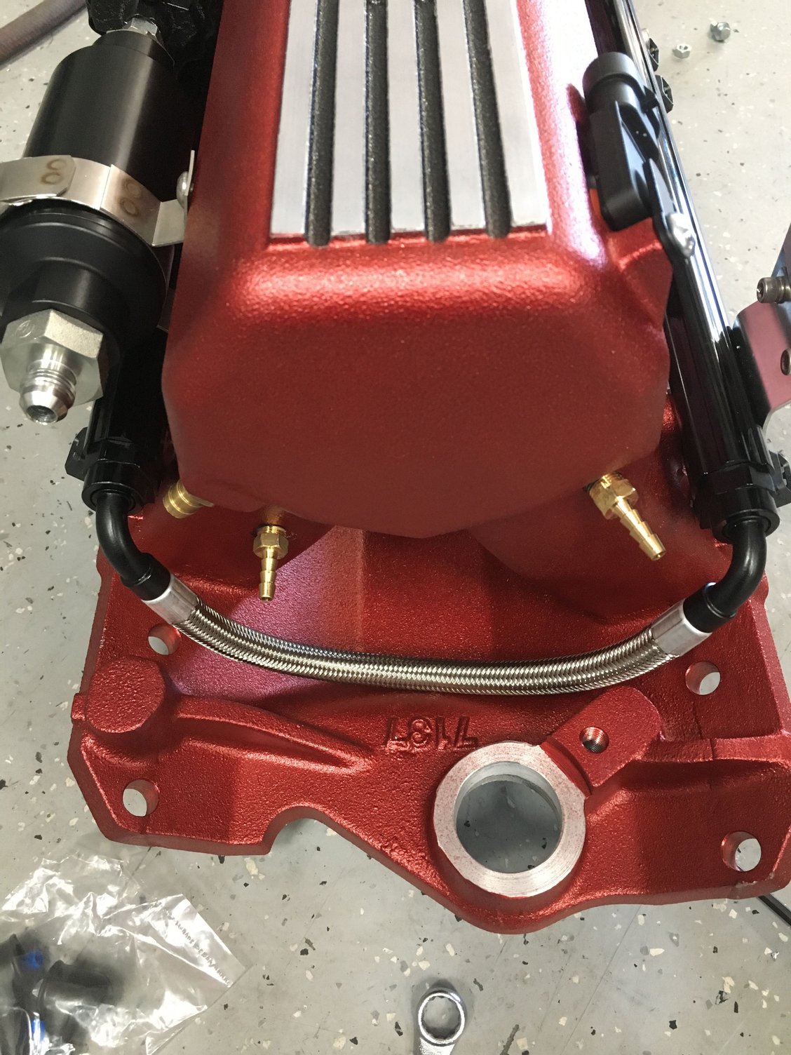

I love the Edelbrock gaskets that come with the kit, however they make no provision for the exhaust crossover ports that will surely burn through in short time. So I ordered the mr gaskets units to get the plates.
Plates will be installed with the Edelbrock gaskets
Stock l82 motor. Expecting more power, but more importantly expecting all the issues like fuel mixtures, cold starts, etc to be gone. I expect a 76 to run like a modern LS motor. No reason it won’t.

The EFI intake has no crossover passage so the Edelbrock gaskets will work fine. Won't burn through when there's no airflow. I have a Holley EFI intake without crossover and no problems for many years.

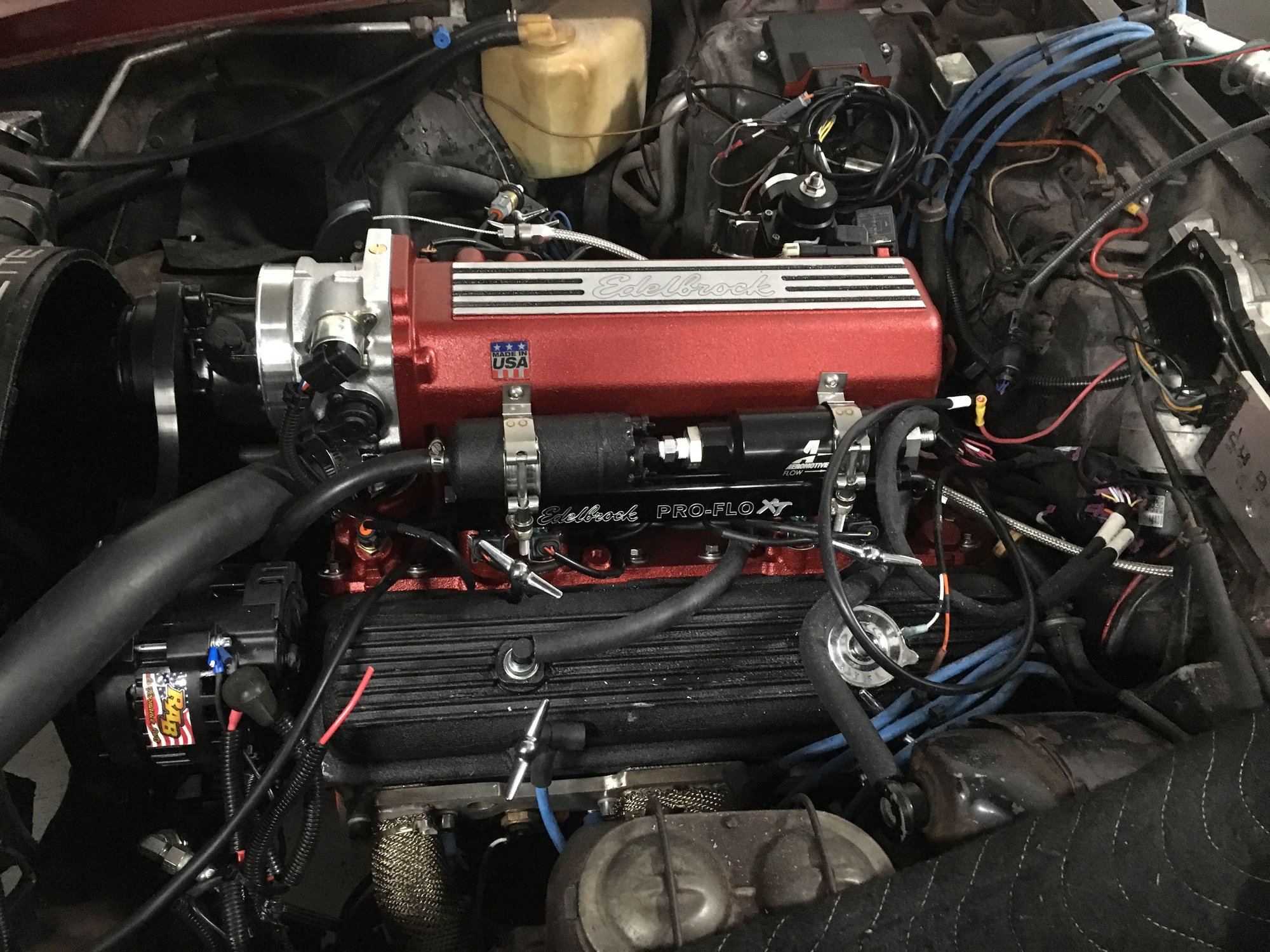

Regulator mounted
Vacuum ports added for dash and trans
Fuel pump and filter mounted

i am confused about something. Easier to show.

So, do I just need to buy a coil and coil wire to attach to center of cap? No MSD box?
