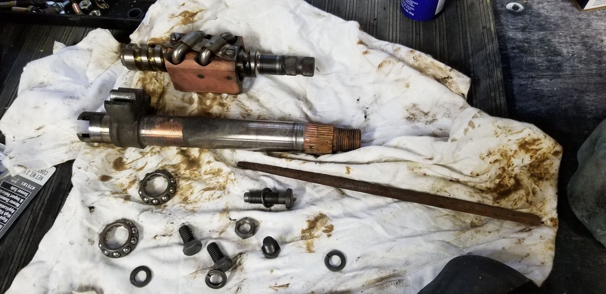

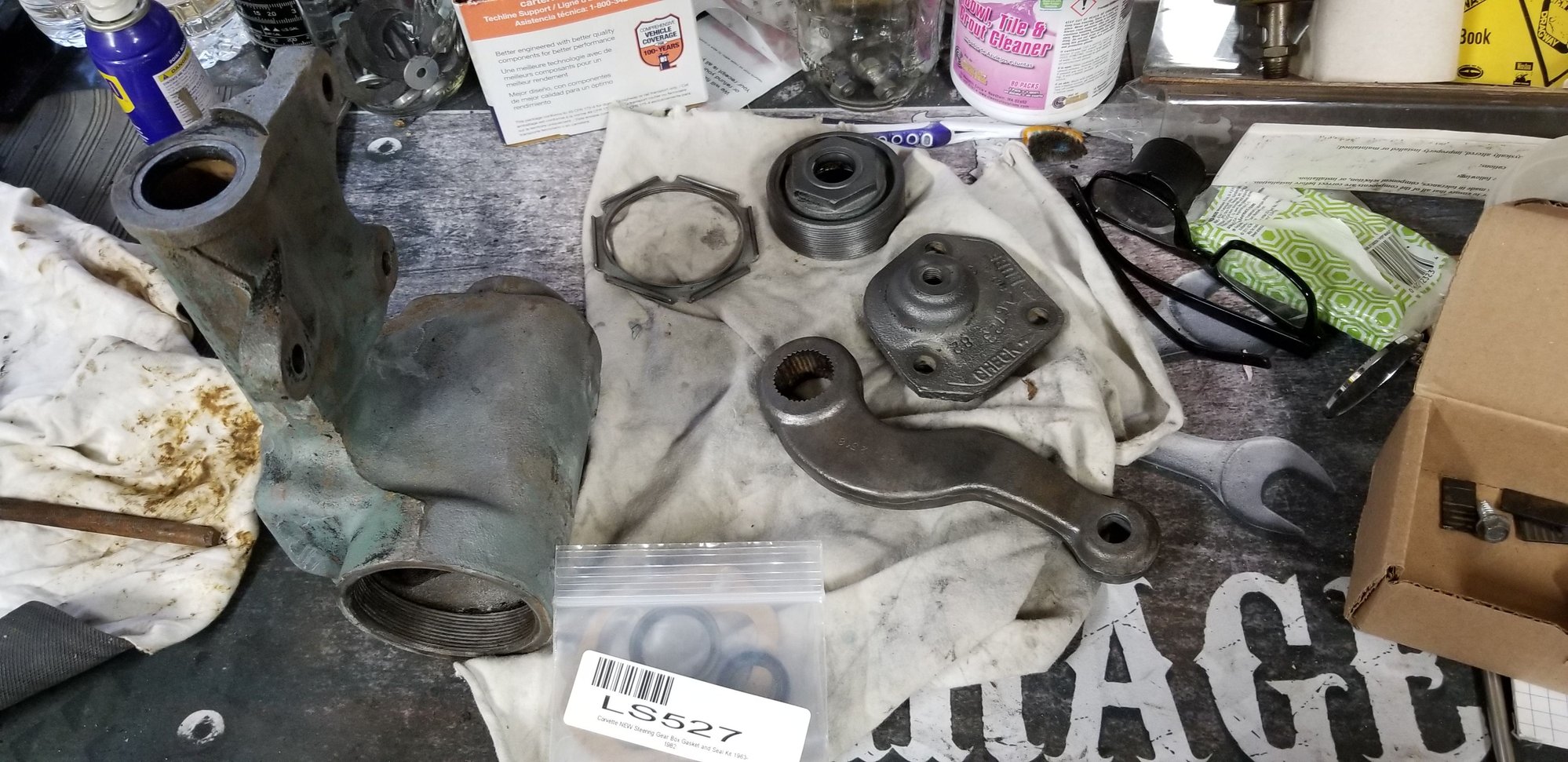

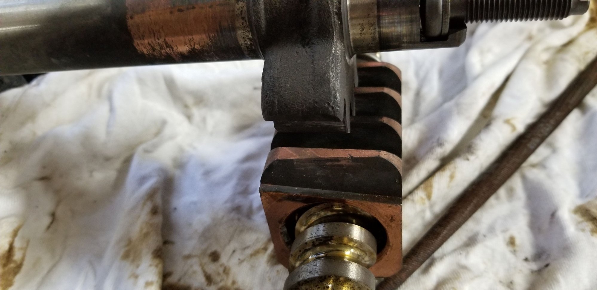

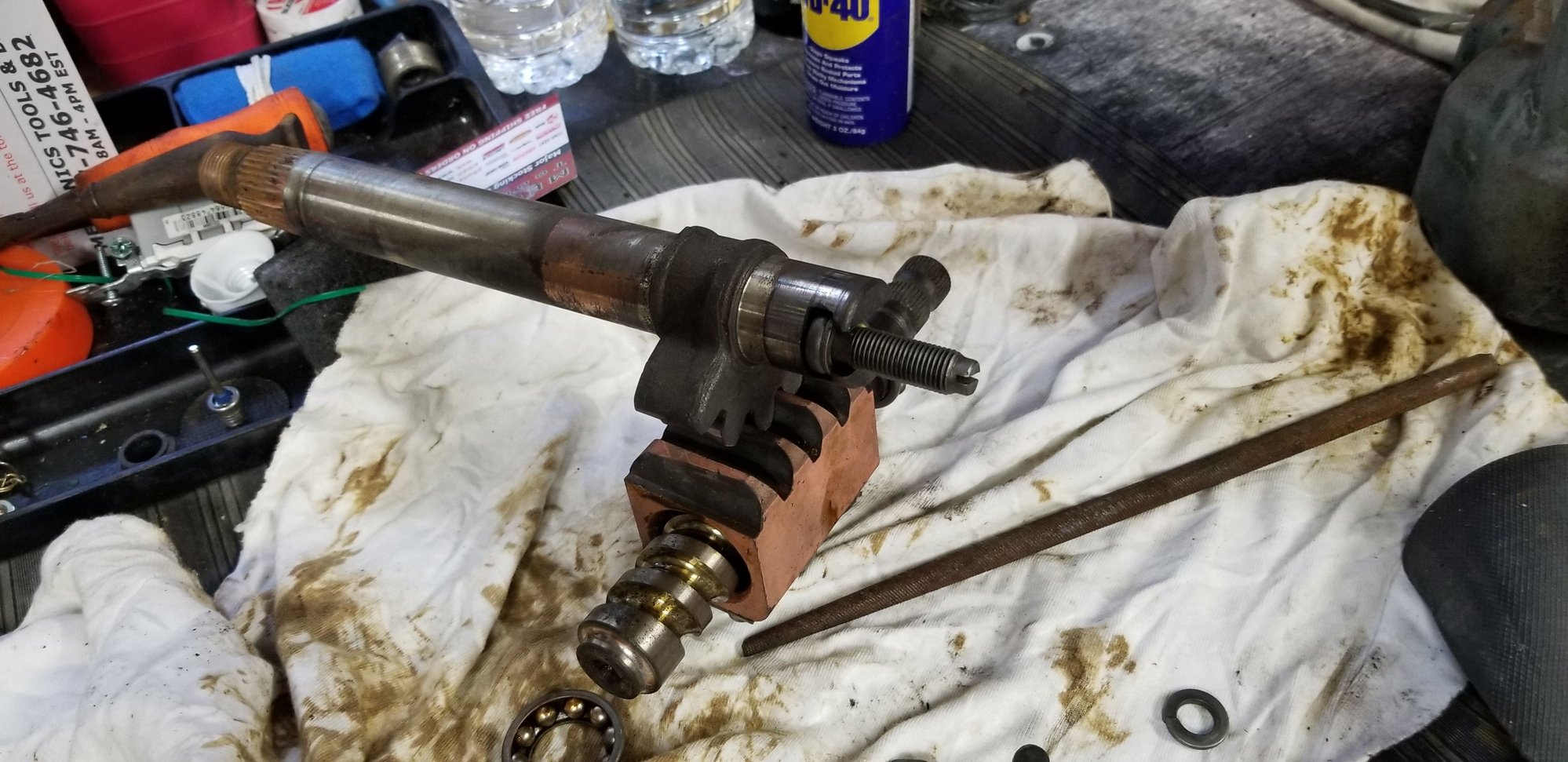

Heres some pics of the guys so you have an idea
All the internal parts
This is how the shafts sit internally
You can see the gears are wedge shaped and the slop can be adjusted out.
Dont go to far in as you can cause binding and bushing wear

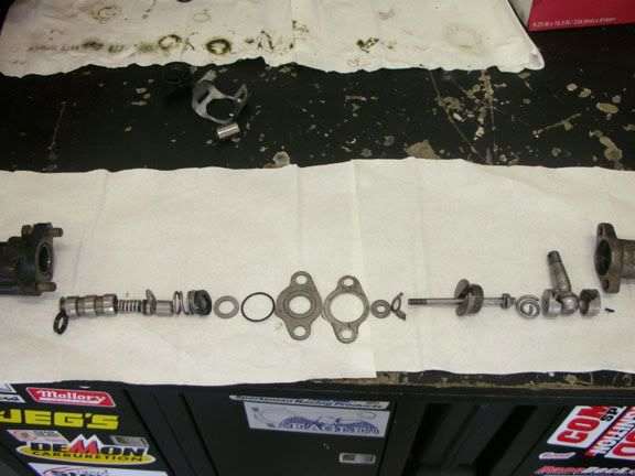

I am not aware of any adjustment on the control valve. I think it just wears and many hard parts need to be replaced, not just seals.There is an adjusting nut but it is used for centering the system. Here's a pic that shows the cups and the spring that should keep it all snug.
Here's a link or two to show how to rebuild it:
https://www.corvetteforum.com/forums...d-rebuild.html
