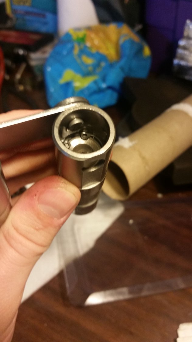

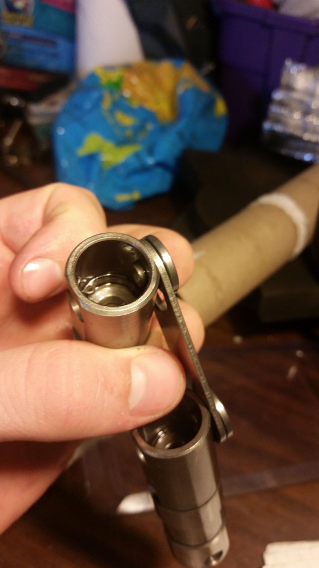

I replace the 2 sets of hydraulic roller lifters so that I could put the proper amount of preload on them. Before the lifter was collapsed; not sure how that happend, maybe when i bottomed out the preload?
When i took them out I the plunger was all the way down and they wouldnt return unless I pulled them back up with a little pick.
After doing all that work, I can't say the car is really working noticeably better, but my conscience feels better knowing the valve train has a bit more cushion on those 2 valves.
This is what a good lifter looks like
Collapsed lifter. Notice that little clip and how low the plunger is.

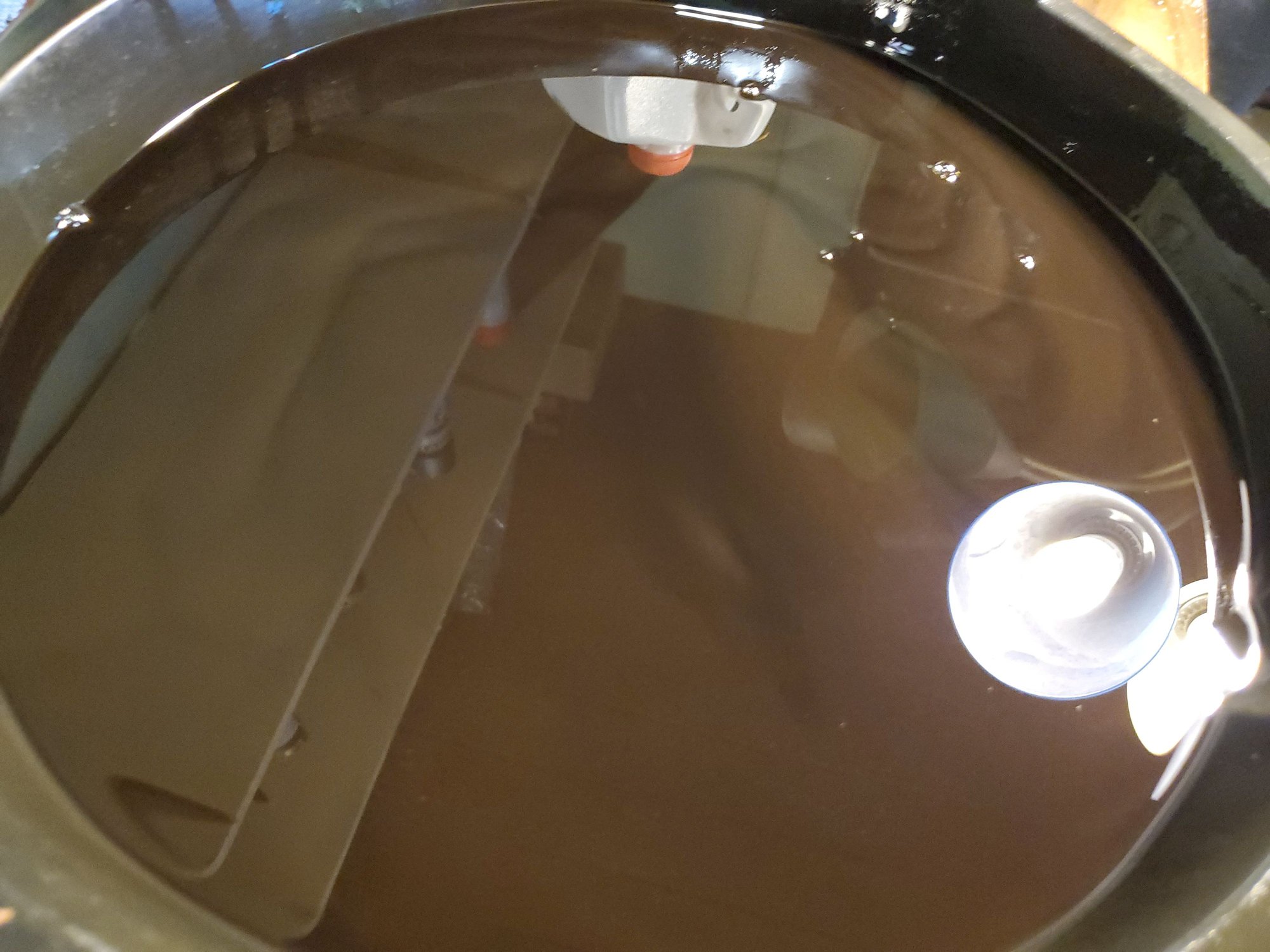

I finally completed the 500 mile break in period for the engine when I went down to Monterey for the weekend. I actually went down there to propose to my long time girlfriend, now fiance. So the ride down in the ol' vette made the weekend that much sweeter. life is great!
This put on about 200 of the 500 miles, and all seemed good. Good power, no noticeable smoke, or overheating. It seems this thing will sit at 180 degrees all day long no problem. Maybe it's the manual transmission guys who have the cooling issues with their smaller radiator.
My A/F gauge was still showing some wide swings in A/F from about 12.0 to 15.1, so I still have to figure all that out. You get a wiff of gas once in a while at super light throttle because it goes all the way down to 12.0, but no noticeable bogs or popping.
So I change the oil and life gets...not so great.
If you've been reading along, you'll remember that the oil after the 25 minute break-in period looked bad. I couldn't tell if it was just the white lithium break in lube mixed in with the oil, or emulsified water. So rather than taking the whole engine apart again I checked compression, changed the oil, and moved forward.
Well, after 500 miles, it looks quite a bit the same. So I'm thinking it was/is water in the oil.
This is the first time I've seen water in oil, so I was judging by pictures online that showed it looking almost brown and terrible, but mine just looks kind of milky when i blow at it in the pan. I couldn't really tell when I watched it empty from the engine.
What really validated this was when i poured it into a milk jug and bubbles were at the top of the jug.
I guess my fears of contamination on the head gasket when I was installing were true, despite best efforts to clean and apply copper coat. (maybe?)
What's weird is I would have thought a head gasket leak big enough to let water in would have reduced the compression test reading.
Has anyone else run into this?
I'm kind of hoping it is coming from the intake manifold gasket. Could the good compression test reading validate that it's coming from the intake manifold?
